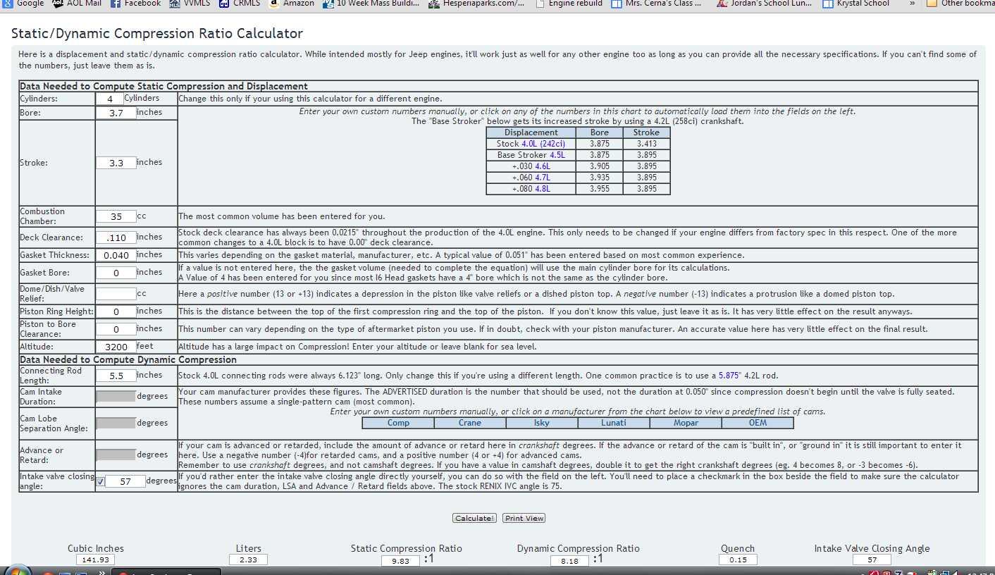

How do you guys build your engines? Do you base everything off static or account for the cam and use dynamic CR? Ive been doing a lot of reading and have come across this a lot recently. People around here throw around static CR like thats all that exists Question Either that or Im just not realizing when people mean one or the other.
For example, my new build has a static of 9.82:1 but because the FK44 duration my dynamic CR is 8.18:1 so I base all my tuning, fuel and boost levels based on 8.18:1 correct? Of course not taking into account my boost levels but just plain old CR before boost.

Im relying on this calculator found here http://www.jeepstrokers.com/calculator/

You are kind of right, but should heed John's warnings. The DCR gives us a guide to how much we can raise compression in a naturally aspirated engine. The thinking is that the piston can't start filling until the intake valve closed as the piston won't generate any pressure. In a turbo the mixture is being forced into the cylinder and is already at pressure, so this total is then compressed by the remaining stroke. A DCR of 8:1 is going to require you keep boost levels very low, unless you are running methanol, so a lower DCR and a bit more boost might give you a better driving and longer living motor.
