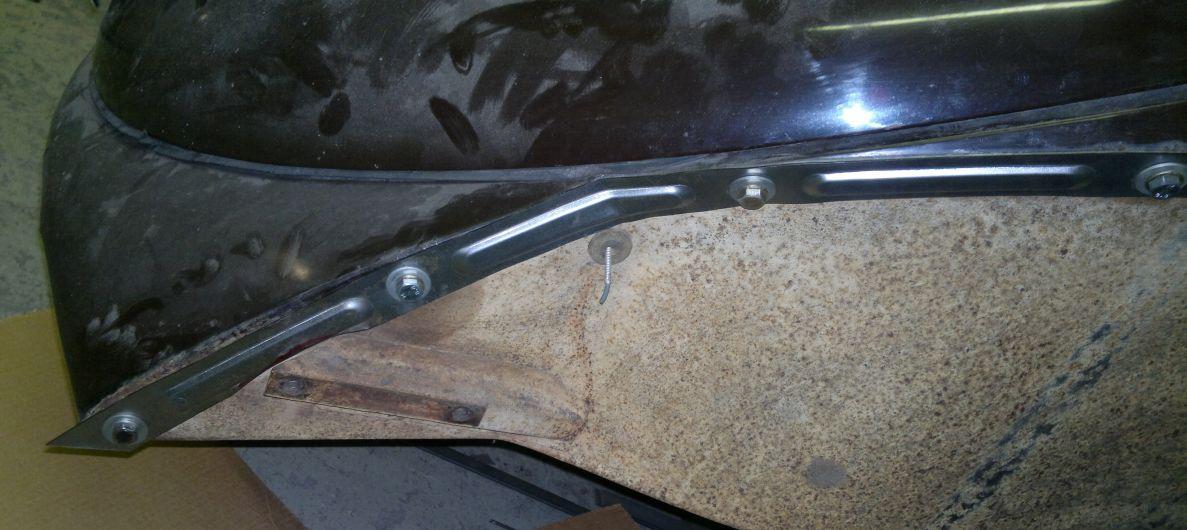

First test welding made. I bolted the flange first to body side, then tack weld to fender. Remove from car and gas weld the seams. Some more finishing work still need to do.

Received the rear fender flanges and they look great. Hope to have a chance and repair my rear fenders this weekend. It's been a long road fixing the 51 but I am hoping to shoot some paint on this thing by the summer. Thanks again

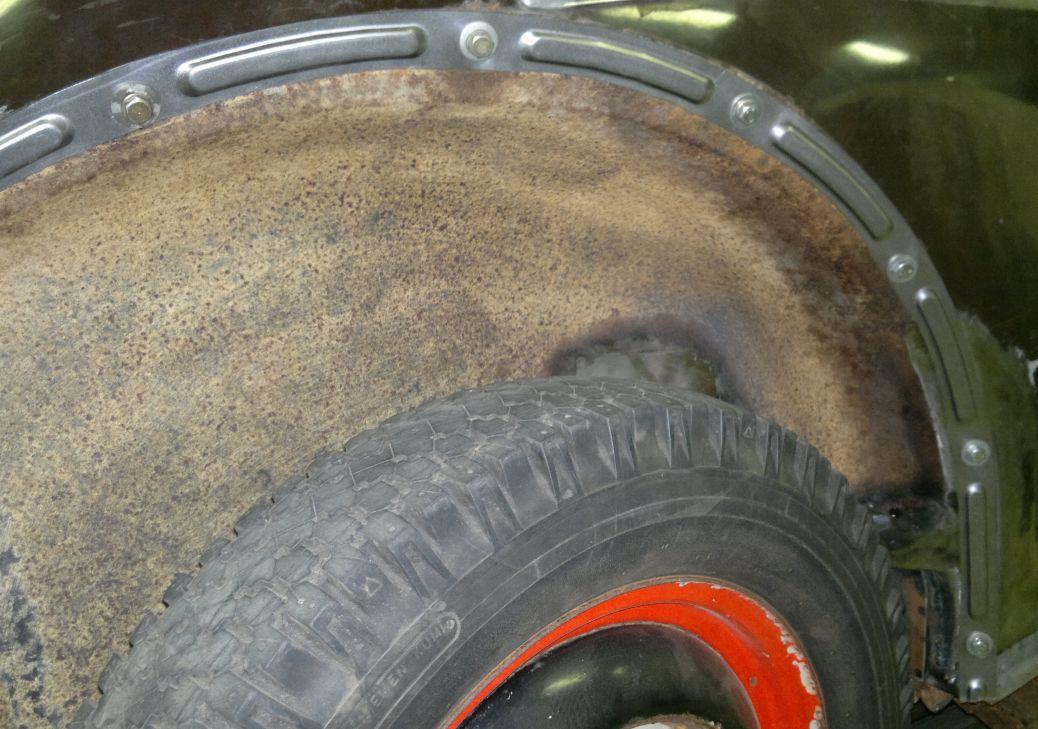

don't know if this is the approved method but should come out ok, finish welding and smooth out the welds. it took some fanagling and time but i'll be saving my rear fenders. the last pic also has my 63 bus i got from the original owner
