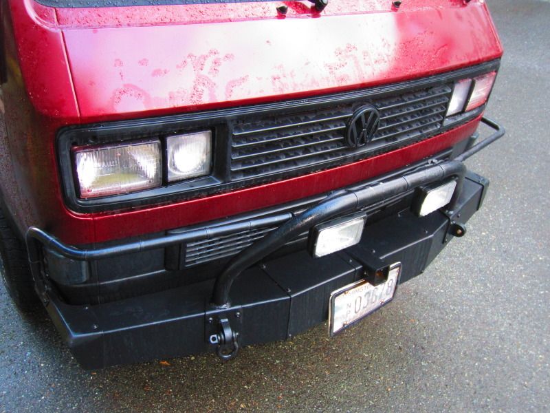

This is my brush guard with overriders on my RMW bumper..

Thanks Dubbified, I'm Hoping that the brush guard for the GW bumper has the same tow point as yours does. That looks great.

I love me some GW products.. but this bumper just does not compare to the tube bumpers.
and you can buy the replacement center piece for a functional towing point.. anchors right into the front steels and is beefcake. Anyone hits my van, they are going to stop.
In looking at the GW Site to confirm if this pic was close to what you sought, I was seeing they offer a hi-lift mount! so the hilift is then functional anti collision steel.. too.
It is a fact your feet are some 6 inches behind the front unibody steel.
Putting these auxillary steels in place, upgrades the impact resistance..
and I am all about resistance.. to accidents...
atleast.. that's how I hope it goes.

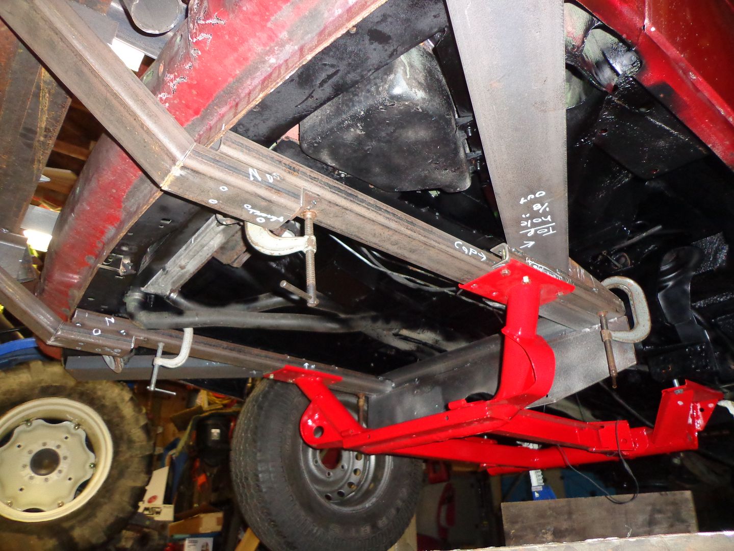

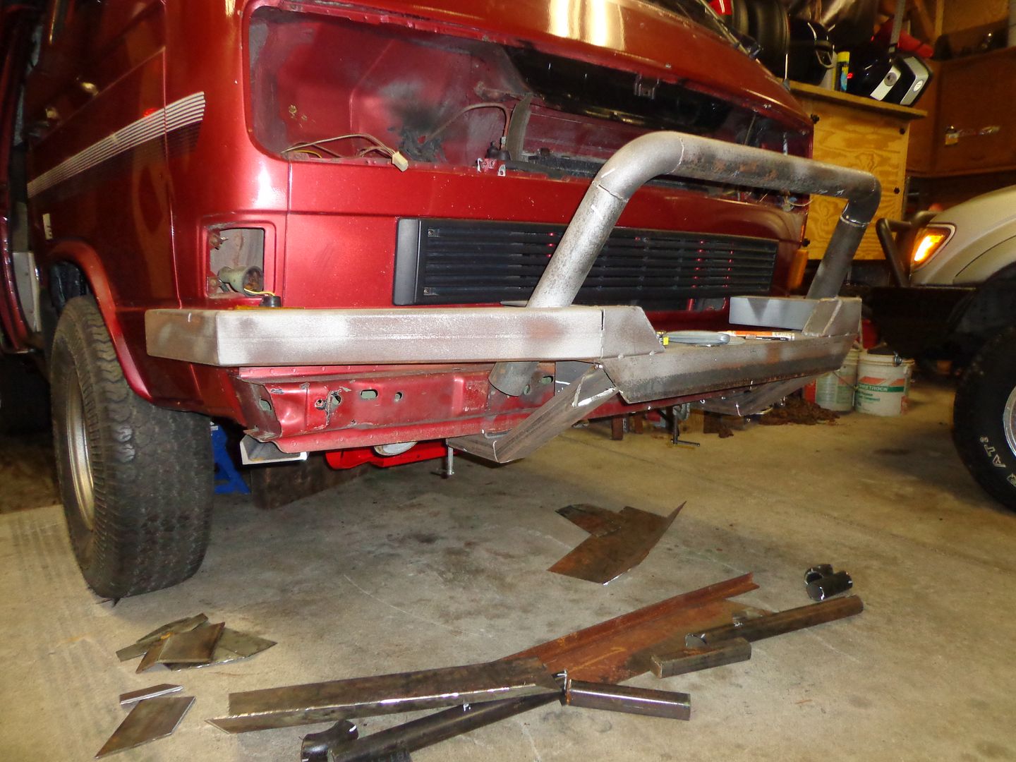

I too am concerned about that 6 inches. My bumper and subframe will be finished up this weekend. In the meantime, here is what I have so far. The corners will be attached to the lower channel arms that you can see under the end of the factory bumper mount. There is much more steel that will be welded on including braces that go against the factory bumper mount. I don't want this to simply curl up and back in an impact.
In the background you can see the bumper I built for my Tacoma earlier this summer.
A shot from below:
At this point you can see it is only tacked together. There are braces and a front skirt already cut that will be welded on this weekend. I wanted to make it so the bumper would still unbolt from the subframe and that detail has added quite a bit of complexity to a simple bumper. The top will be aluminum diamond plate. I'll post pictures of the finished product in my build thread in a week or so.
