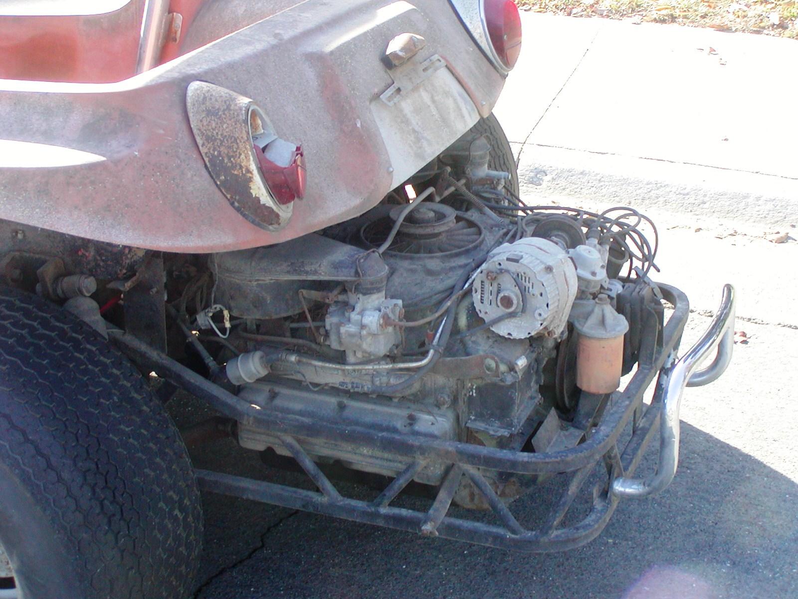

I picked this up Saturday a couple hours south of here. It didn't have a tag but has all the right stuff. The builder fabricated a custom subframe to support the Corvair engine and trans, and spliced the Corvair and VW swingaxles so it has a wide 5 bolt pattern rear brakes. The Corvair bits intruded into the rear seat and wells a bit but the Scotch tape impression in the bottom of the spare well is there. It has black and yellow plates, a Hurst shifter, SW gauges, a Moon gas pedal and very cool home made steering brake handles.

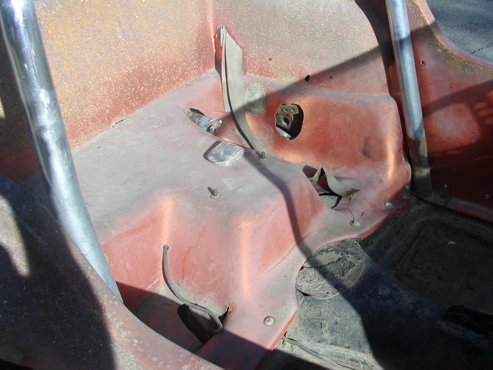

You can see the gold metalflake has a protective coat of moss, lichen and dirt and the pine needles were several inches thick on the floor.

Are those oil bath air cleaners on that Corvair engine? I have not seen that setup before. (not that versed in Corvair)

Those are 61-63 air cleaners, they're just a dry paper element type, but Corvair did have a Desert Air accessory package which is rare now days that did have an oilbath pre-filter. The 61-63 cleaners fit under the rear of the body well but the twin snorkel air cleaner on the 4 carb, 140hp Corsa engine that Steve McQueen used is the one with the great Detroit look.

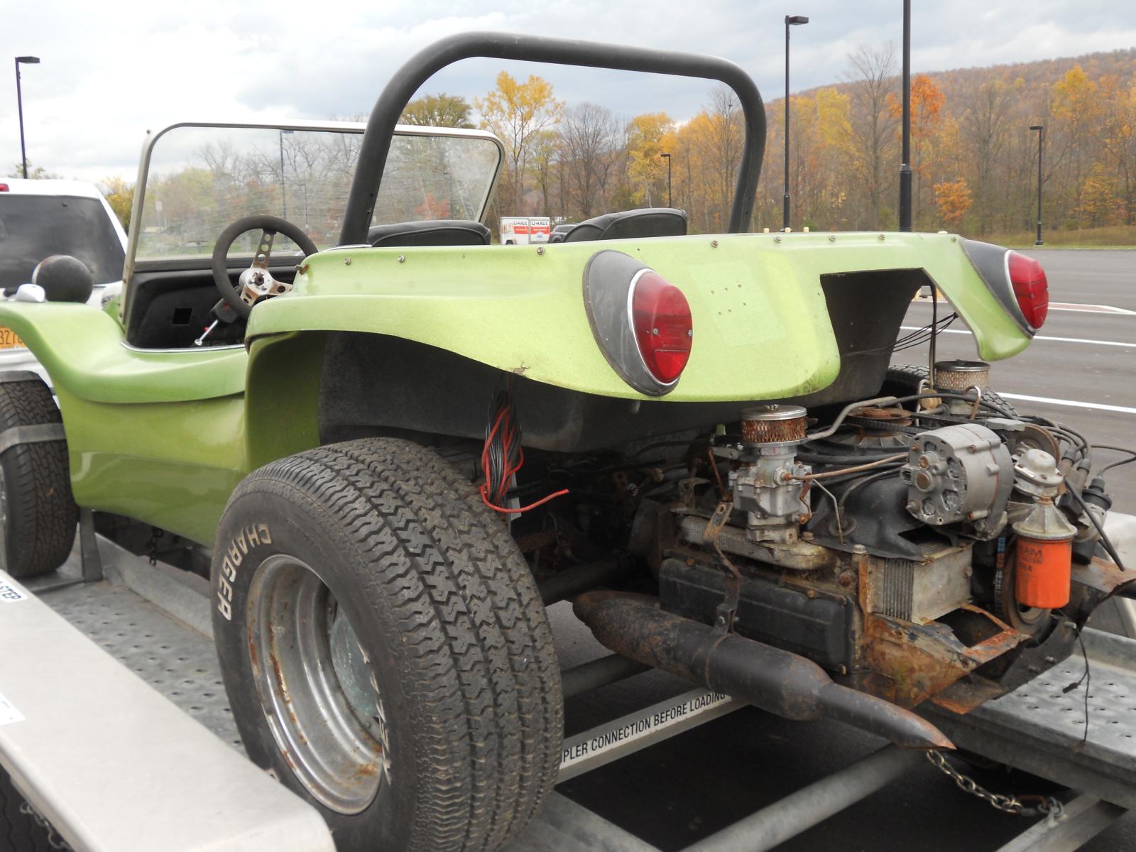

Nice find Nelson !, here are a few pictures of a early Manx 2 Corvair with abs dash and Manx 1 hood I sold about a year ago
Good Luck with it

I've got a Manx 2 with the same hood and abs dash. All that space under the back seat would definitely make putting a Corvair back there easier

So it look like it is running the Hadley Transvair setup.

Its a similar design but narrower vertically and I can see it was made to fit around and support the body so I think it was a custom design. This is the one I have
and this is a Hadley Transvair.

Its a neat creation, but I don't like the way the mount and transmission intrudes into the Manx back seat. There are eight good size holes cut back there and only one has been glassed over, badly. I'm thinking of using the subframe and drivetrain(upgraded to 110 hp) in my Tow'd where there wouldn't be any space issues and I could upgrade it to an IRS mid-travel suspension. I've already ordered a set of the adapters from Clark's to put bus CV joints on the inboard Corvair axle stubs.
I'll repair the Manx body and put the chassis back to a standard VW swingaxle, keeping the tunnel intact so the original license plates stay with it.
