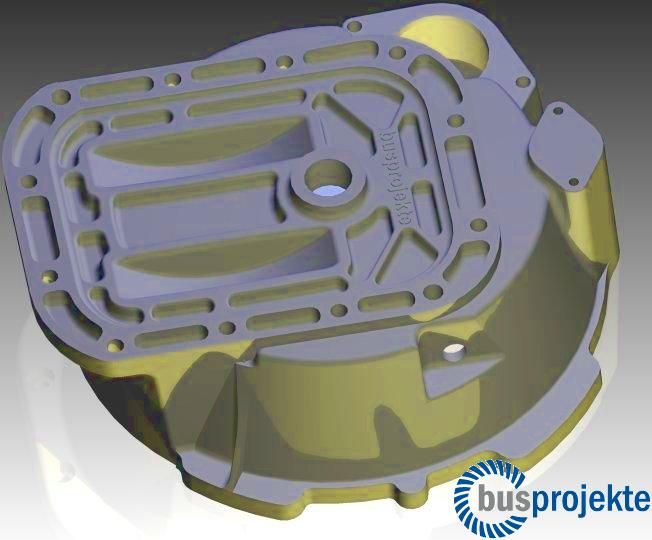

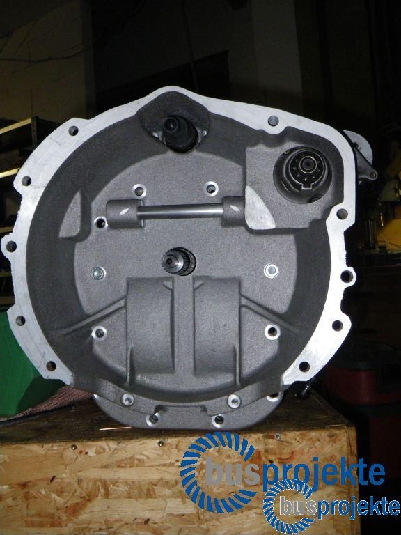

I was flicking through some german websites and found this...
I know that some of the guys on here were interested in running the UN1 gearbox and a Subaru engine so.. there you are Smile
http://shop.busprojekte.de/
The guys at Busprojekt also offer output flanges, flange adapters, shifter kits etc to do your conversion along with some other fairly nice stuff.
I'm nothing to do with them - just passing on what I've seen.
