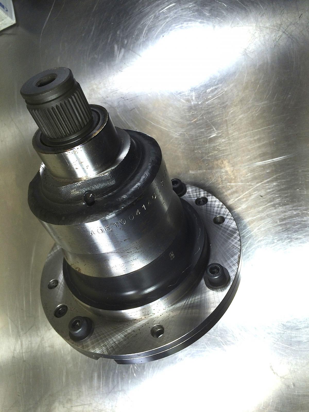

This LSD is in far better shape than average, but the plates are in obvious need of replacement:

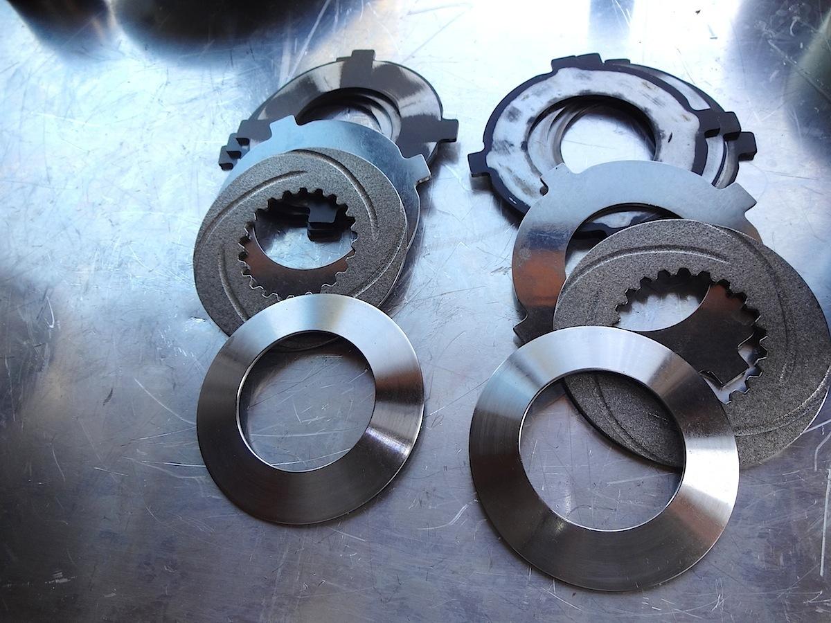

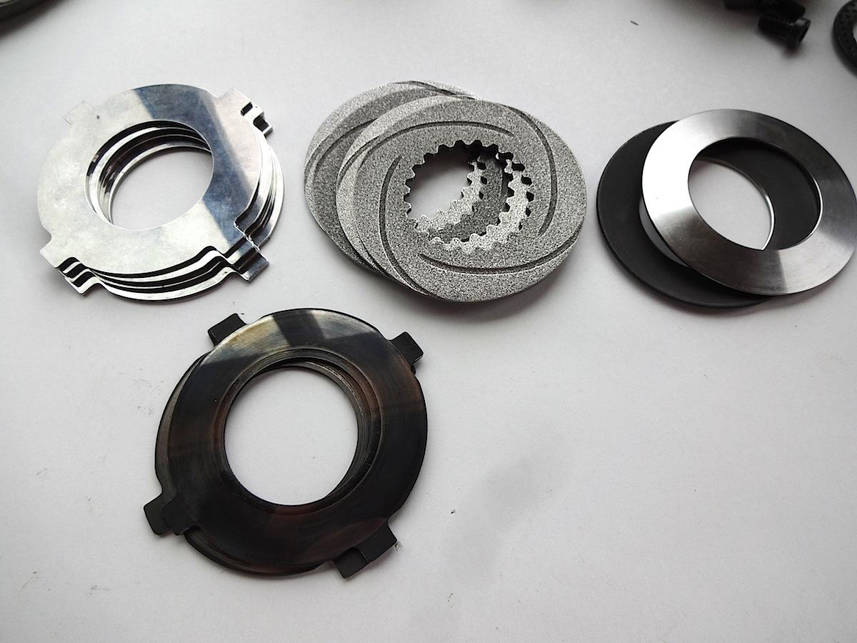

Because most 904 LSDs are used on the track for vintage road-racing, my 904 kit provides four friction discs along with four hardened and REM-polished plain plates. And, we of course added a pair of Belleville washers to the kit to introduce static preload. Two of the LSD's original plates are retained as spacers.
For street use, 40% lock-up is more desirable, so the smaller 40% kit utilizes only 2 friction discs, 2 hardened plates, along with the Belleville washers. Six of the LSD's original plates are retained as spacers. As this VW LSD is destined for street use, this is the kit we're installing. Just two of these modernized friction discs (along with the addition of Belleville washers), provide the LSD with more plate friction than the six OE plain steel discs.

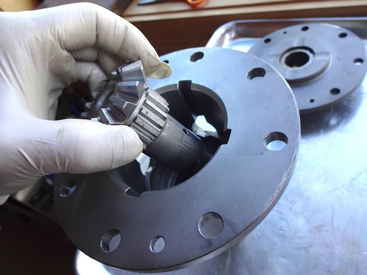

Nicks in LSD body:
Highs spots worn into the pressure ring grooves:
This LSD body had very nice grooves, but still required a bit of cleaning up:

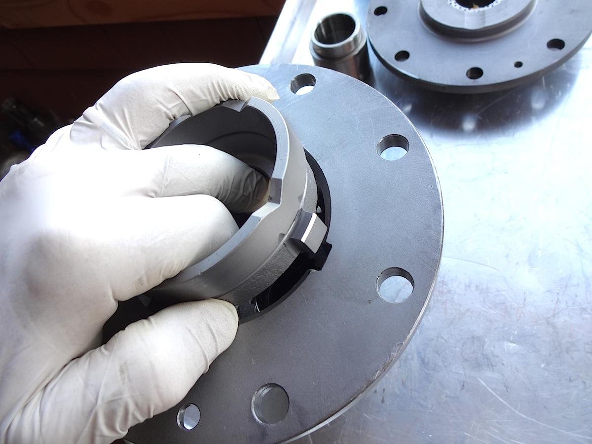

The nubs of each pressure ring had their chamfer increased just a tad:

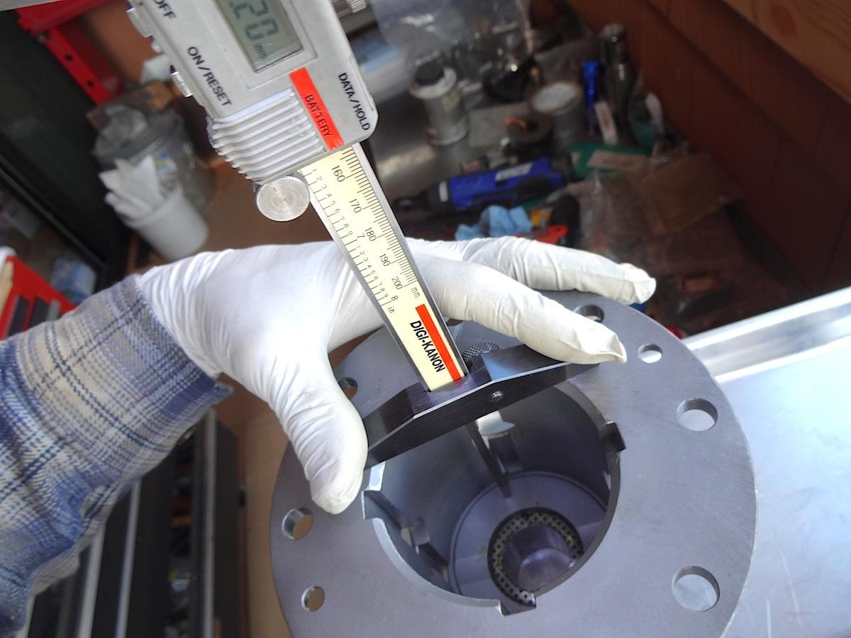

Measurement of the various internal components assures proper clearances and “free space” within the LSD. I'm going to rush over this section by just showing a few photos, as this procedure isn't really required for bolting in this kit:

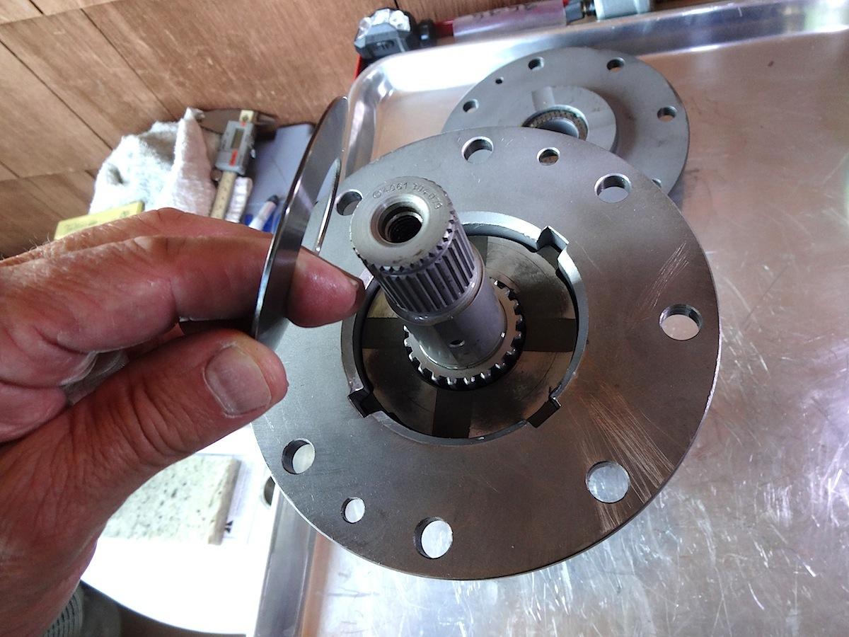

The first step in reassembly is to install the small thrust washers with grease on their backside, insuring that they stay in place during reassembly:
At the point that our first side gear / output shaft is installed, the diff body will need to sit on something that accommodates the protruding shaft. So, I've readied some large sleeves for the body to sit on:
The first Belleville washer is installed with convex inward, concave outward (outer edge contacting diff body, inner edge contacting plain plate):
Then the inner three spacer plates:
The single hardened plate is then installed:

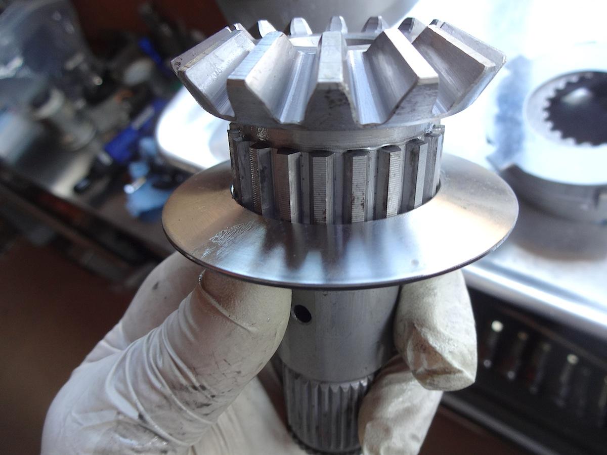

Because the ID of the Belleville washers are centered within the LSD by the splines of the output shafts, ..
.. the Belleville already installed must be centered below the various plates:
Then the first friction disc is installed:
The inner pressure ring is installed:
With the diff body now propped up on my sleeves, the first side gear / output shaft is installed. Although not shown, every part installed is liberally slathered with gear oil. The shaft-to-bore contact area gets an oil/moly mix slathered on:
The cross shaft / spider assembly is now dropped into place. If the cross shafts don't seem to properly seat in the pressure ring's notches, the output shaft's splines are hanging up on the ID of the Belleville washer, and you will have to back up a couple steps to again properly center the Belleville.
Now is a good time to squirt extra oil on the spiders and inner side gear.
The left-hand side gear / output shaft is now installed, along with the left-hand pressure ring:
The outer friction disc and hardened plate are installed ..
.. and then the 3 outer spacer plates:
The outer Belleville is the last internal part:

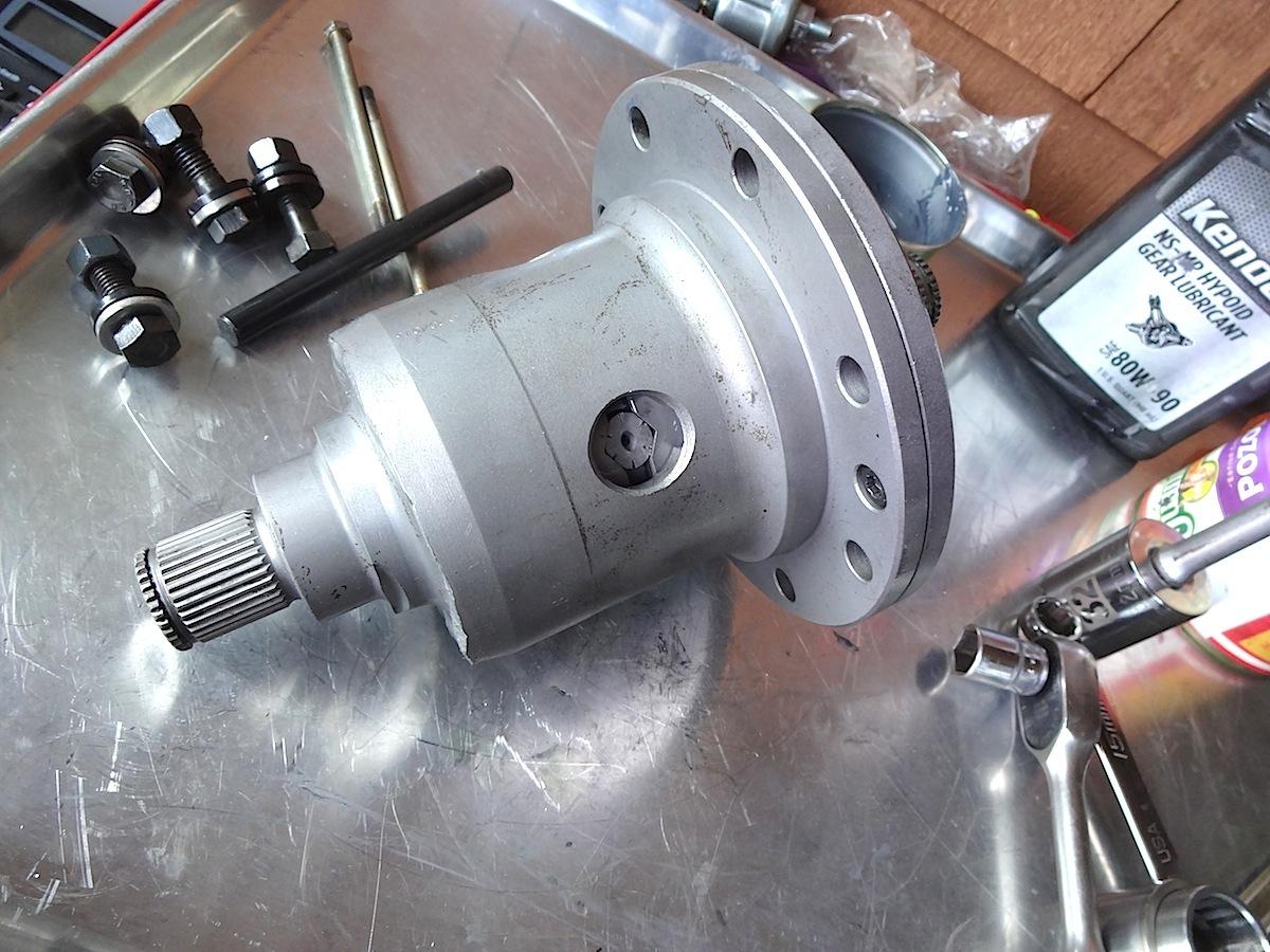

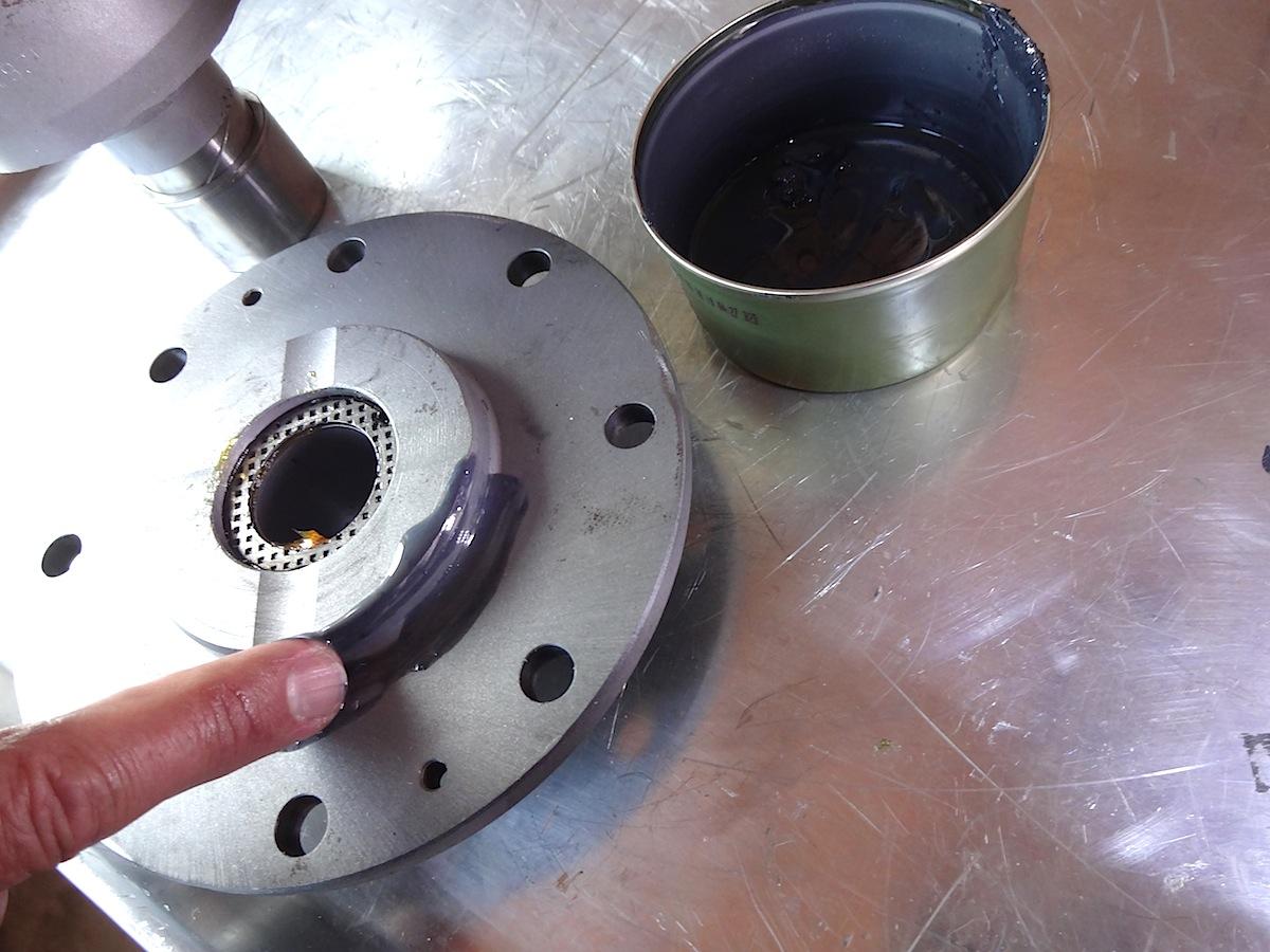

Before setting the cover plate in place, I'll slather some moly/oil mix onto the contact area:

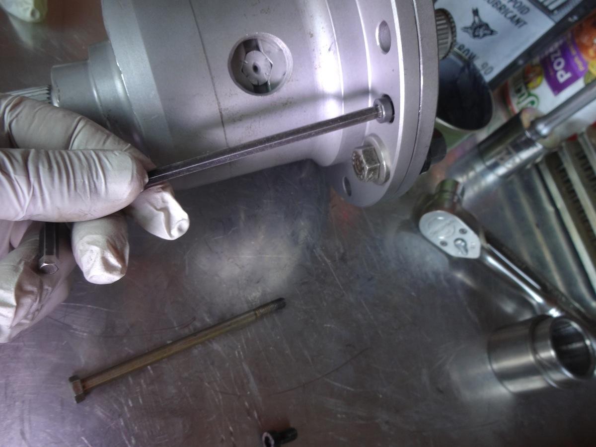

Properly installing the diff cover is the most critical step. We're going to use a pair of long 6mm bolts in the two set screw holes for initial alignment, and four 10mm nuts & bolts with HD washers to pull the cover on perfectly square. Slow going with tiny twists of each consecutive nut minimizes the scuffing between cover and body. Now that we're using Belleville washers, the cover requires a bit of effort to install as the Bellevilles are compressed. A 27/64” transfer punch or drill bit serves to keep the ring gear bolt holes in cover and main body properly aligned. Failure to properly align the two may cause problems during later ring gear installation.
The two long 6mm bolts used for initial alignment are now replaced with the small set screws. These two dinky set screws are all that holds the cover down until the ring gear is installed. Since this cover is now preloaded by Bellevilles, it's important to use this cover bolt-down procedure in reverse whenever removing the cover, so that no threads are damaged.
The LSD is now ready for the ring gear to be reinstalled.

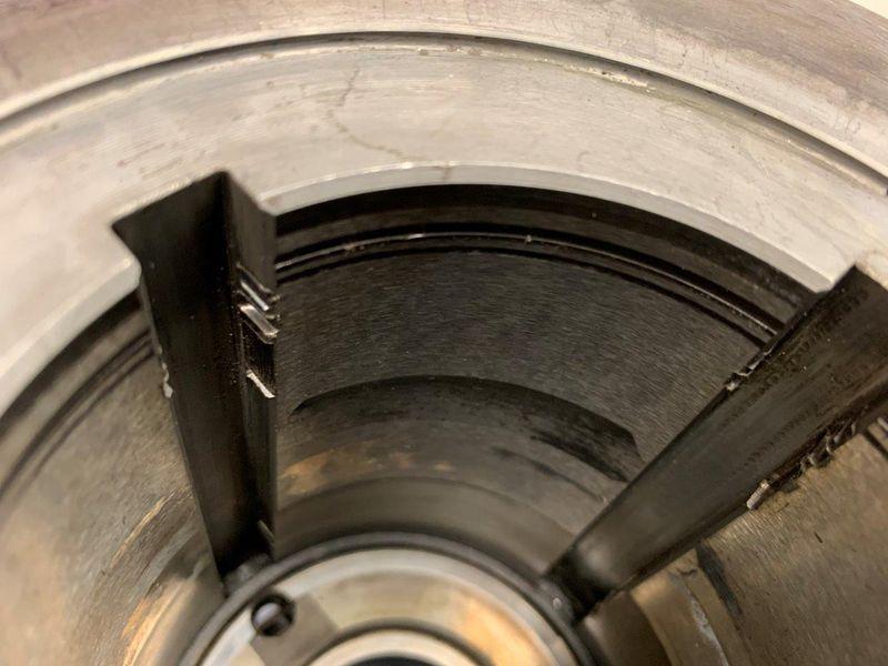

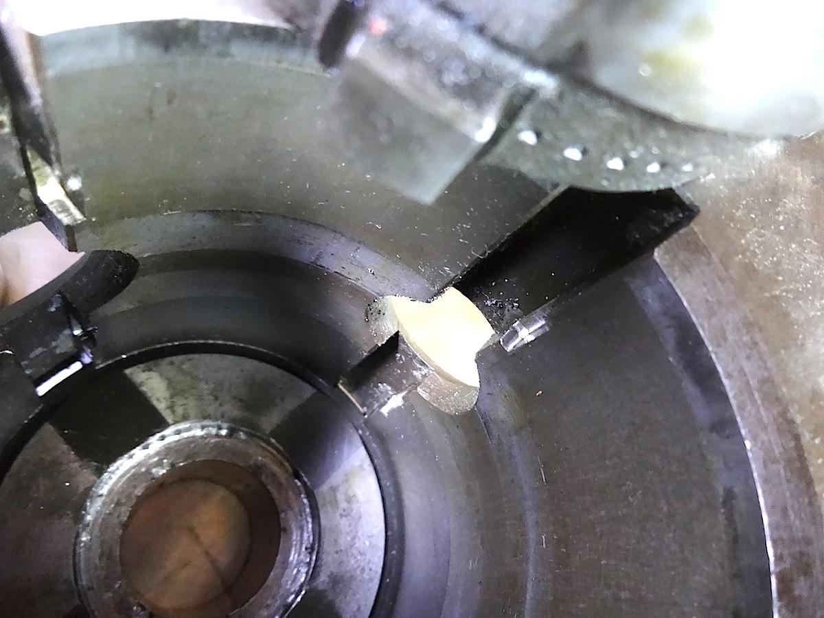

the ring grooves in my LSD body (vanagon 094) are damaged.
I wonder if there is a way to repair the grooves and think about either welding the nicks and reshaping the grooves or machine the grooves wider till the nicks are gone and adding spacer stripes to get the right dimensions.
Just brainstorming, maybe someone with more knowledge can chime in.

I know Bruce has repaired this sort of damage before, but I find that at this stage of wear, the side gears and spiders have very little life left in them (making the effort of patchwork on a worn-out housing almost pointless).
When we redesigned the swingaxle ZF (and all the early Porsche LSDs), we went to a round-tabbed plain plate, which both minimizes this wear, and allows a fully billet 1-piece housing. (Machining square channels requires that an end plate be welded on after the machining.) We also use 8620 material, rather than mild steel like the ZF.

The housing is mild steel, but the discs and pressure rings are hardened. That's why those notches appear in the sides of the slots.
Wash off the oil well then dry the diff. Go in with your MIG welder set to high, (or TIG) and build up enough so you can shape it back to what it looked like new.
After I weld, I start with a die grinder to remove the weld that protruded into the bore of the housing. The diameter is not critical, just make it clear.
The next step I do is to use a small diameter cutter in the die grinder to bring down the weld at the sides of the slots to about a mm or less from where you need to end up. If you grind away at the bottom of the slot, don't worry, that doesn't matter.
Now the fun part. Use a square file to work the high points down. If you have an old dull file, get a new one. It will take a long time even with the new one. Start with a 5/16" file then finish with a 3/8" square file. I use a M6 nut as a guage block to start, then use the pressure ring to finish.
Once you've restored the grooves so there's no rock of the pressure rings, you're not done yet. Like Paul hinted above, the side gear and spider gear wear badly. I think it's from lack of oil since the housing is closed. See the pics way up of the Type 1 ZF? It has 4 large holes in the side to let oil in. Type 1 spider gears and side gears rarely suffer the same wear as the 091/094 gears. I strongly recommend drilling holes in the housing. Drill them so they line up with the gap between the pressure rings. I'll see if I have a pic somewhere.
