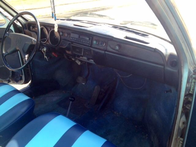

Thanks Ray! Below is a picture of the steering wheel currently in the 412. As you can see, the plastic wheel is cracked as well. So, I just cant't snap on a new cover. That said, do you think a T1 wheel would work?

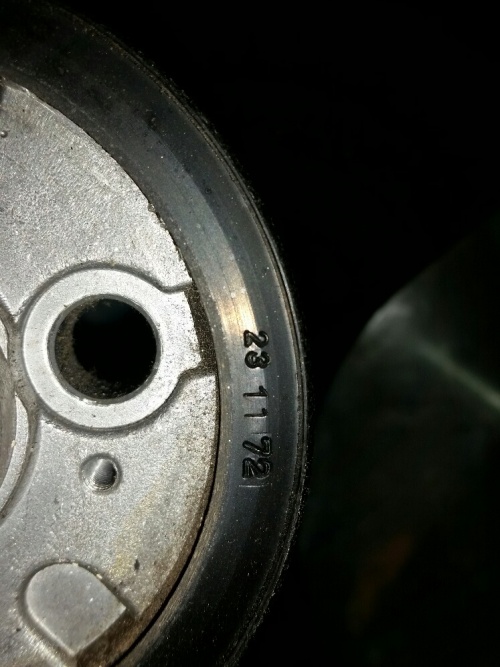

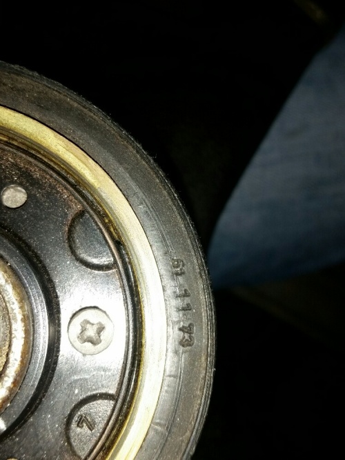

Cant find any marking on the metal parts, only some date marking on the bottom plastic section, my original VW412 1973 steering wheel says "23 11 72" the super beetle one says "6? 11 73".
Also the super beetle steering wheel has the four Audi rings (OOOO) at the base at the big fitting nut, my original dont. Guess the Super beetle wheel is newer then the original one.
Anyhow they both seem to be identical when it comes to how they fit.

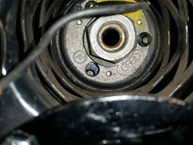

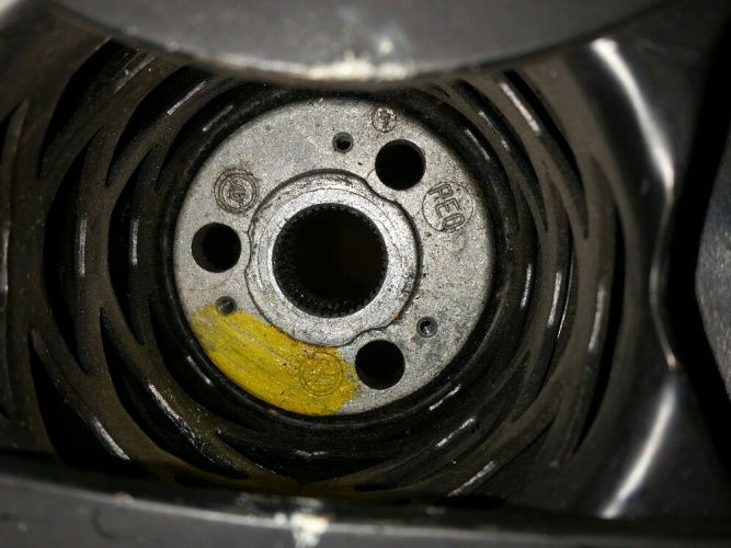

One thing interesting to note, is as I recall, the '74 412 did NOT get the steering wheel spline change other aircooled VWs got that model year, which I believe are the same as the early watercooled. I also think there are some Porsche steering wheels that will fit as well.

I tried to fit the padded '74 sun bug wheel on my '74 412 last weekend. nope, no go. It (the 412) has the smaller splines from '73 down and the nut is the 24mm, not the larger 26mm.
