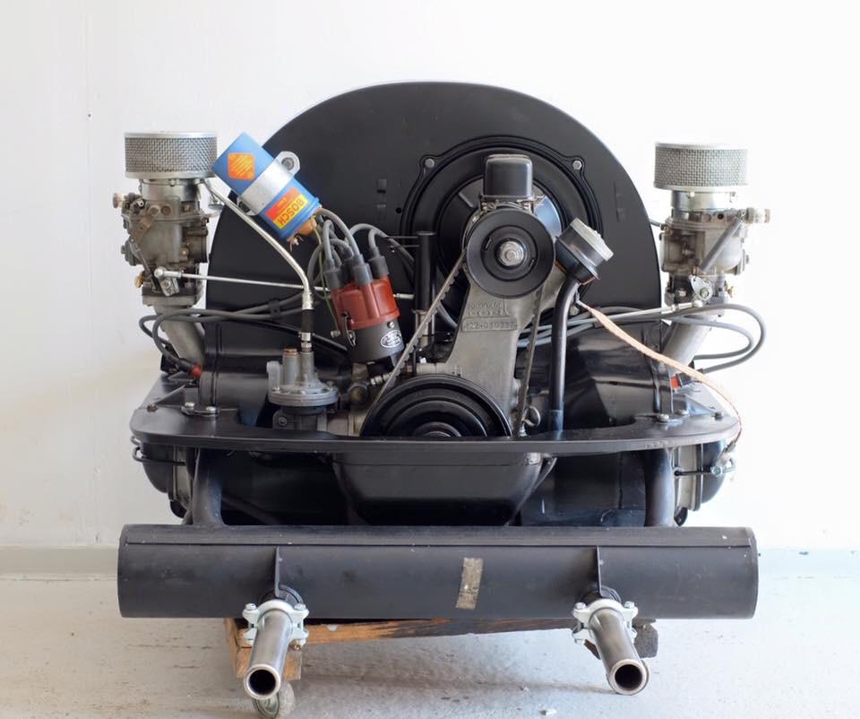

Thanks for the help during my engine bild! Just wanted to share a pic of my engine before it goes into the car:
1957 type 122 industrial engine case
WW 69,5 crank
Genuine Okrasa heads
Slightly lightened flywheel
8.2:1
Zenith 32 NDIX (24 mm venturies)
S-G manifolds
WW Okrasa/CSP bell crank with homemade carburator arms.
Air filters of unknown origin (ebay.de)
Bosch BR25/010 distributor
NOS VW-logo muffler with TDE tail pipes

Awesome. Would love to see it in action!

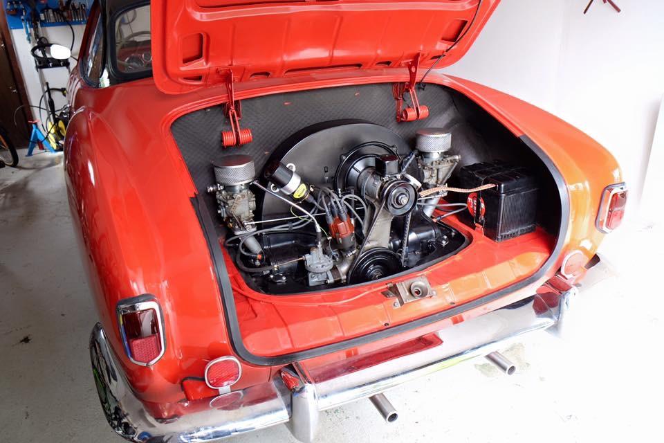

Now in car. Leaking fuel tap in the tank did stop the start up. But I've got oil pressure and that's a start!

Great looking '36hp+' engine!

PostPosted: Thu Aug 06, 2015 2:06 pm    Post subject: Reply with quote
...and it's alive (but unadjusted)!

gimmesomeshelter
Joined: May 08, 2004
Posts: 1467
Location: San Carlos, CA
gimmesomeshelter is offline
PostPosted: Mon Nov 23, 2015 1:11 pm    Post subject: Re: my NDIX-1300TSV ready for action! Reply with quote
Sweet!
Which cam did you use?

PostPosted: Mon Feb 29, 2016 4:48 am    Post subject: Re: my NDIX-1300TSV ready for action! Reply with quote
gimmesomeshelter wrote:
Sweet!
Cheers,
Paul
Sorry for late reply: It's a stock cam (just like in the Okrasa TSV1300 kit and as in the Porsche 506 1300N engine)
