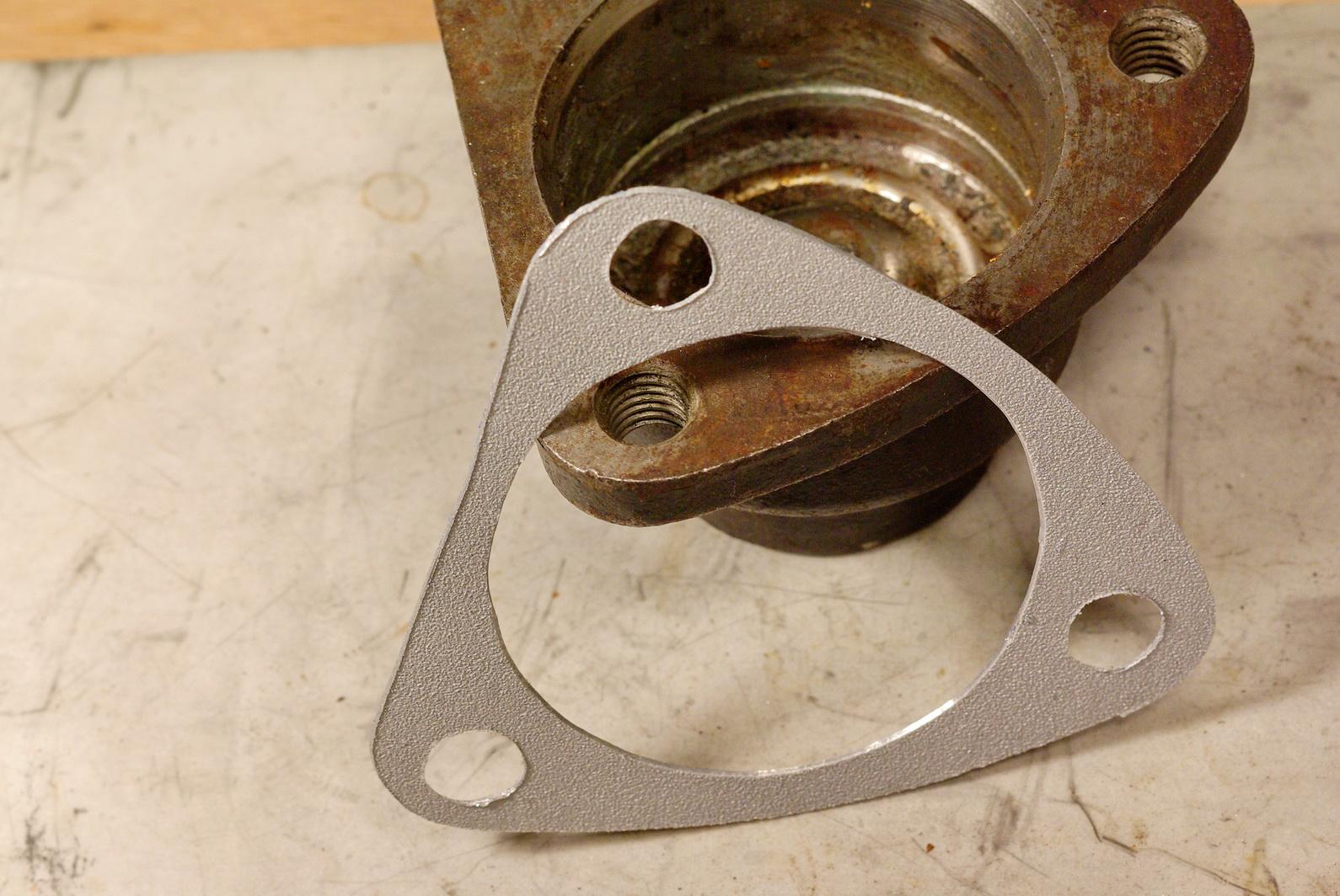

So.....The first gasket sets I made are done and are for the ball joints.
I applied precise layers of 600F RTV with a roller to smoothed foil....and applied each layer with a nip roller.
I can generally control RTV and other elastomer applications to within about +/- 2 microns....but I had some trouble with this one (found the fix after I was done)....and didn't really know how many layers of foil to start with.
So..these came out a little thick for where a thinner gasket is needed. But..they are very precise and uniform in thickness...and nice and flat....and rigid.
These gaskets came out to .022" thick. They variance in thickness is +/- .0002". Not bad.
These have 8 layers of foil and 9 layers of RTV. The foil is .00096" thick on each layer....putting the RTV layers at about 22 microns each including the 0uter layers...which is just under .001" per RTV layer.
In future applications the inner layers will be held to about 12 microns or about .0005" or less
The outer elastomer layers were printed and then calendared to make thickness and texture uniform.

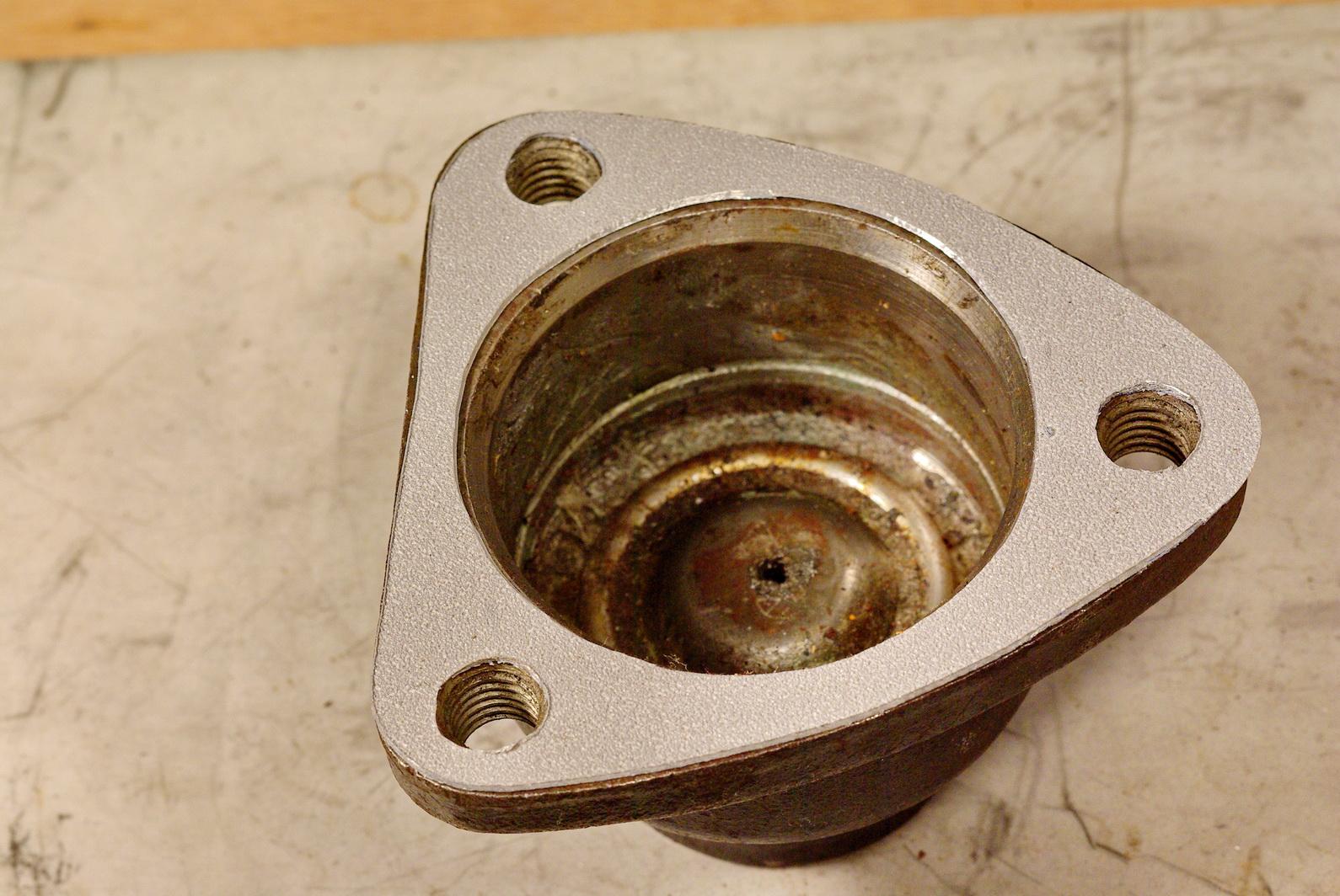

the gasket on top of the ball joint
Tipped so you can see the texture

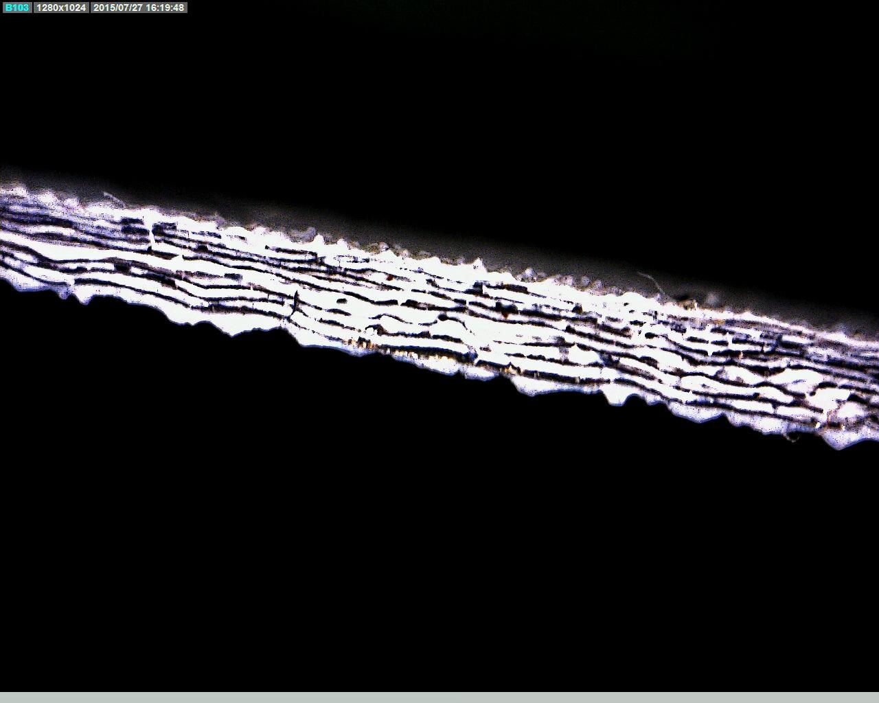

Microscope shot (60x) of the layers
The crush on these takes them down to about .016" and they lock up rock solid.
Sorry the bolt holes are a little rough. My 10mm punch was to dull to to do them justice so i cut them by exacto knife.

The microscope shot, is it before or after the compressing?

That is before. The rough variation is because of the cutting of the edge. I will take some of the compressed edge tonight.

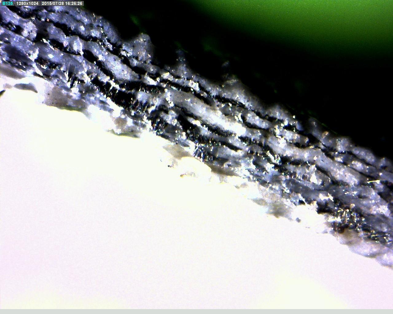

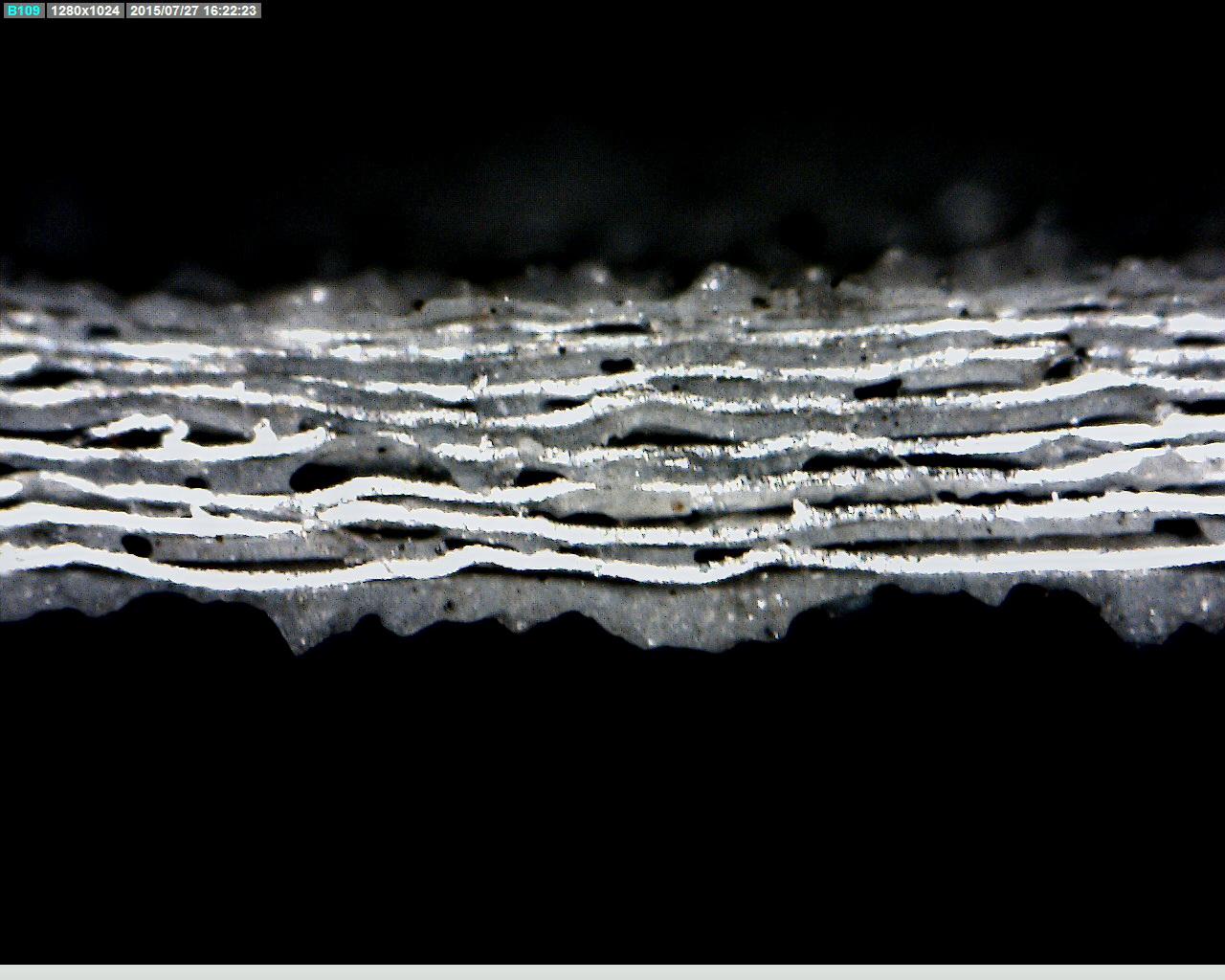

These are done at 230X magnification
This picture is of the edge of the cut gasket before crimping. Its angle shows a lot of highlights at the edge of the cut aluminum from the aluminum being burnished over...even though I used a zirconium plated blade. But it shows the fairly even distribution of the aluminum...as will as that one thick middle layer I lost control of.
This picture is again...before crimping/compressing of the same general area of the gasket above...but the angle shows the uniformity of the aluminum llayers...meaning fairly flat and even. It also shows how much thicker the RTV is. I dont know if the RTV being that thick is a plus or minus yet.
