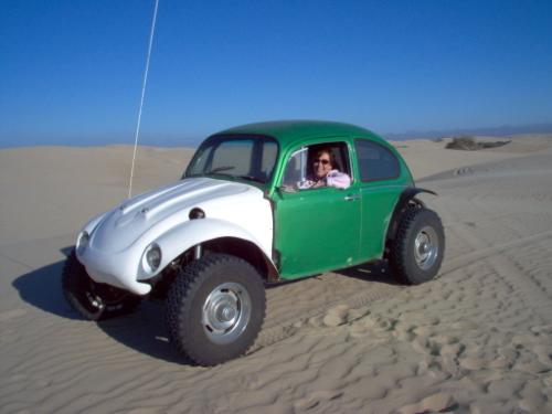

here is my burro with 31x10.5x15 real close to torsion bar with stock length arms.
here is a pic of Laurie's buggy with the same size rears, stock arms and short torsions from a swing axel car.
and lastly here is a pic of the old Baja with 30x9.5x15's all around.
all of the above cars have bus box's.
