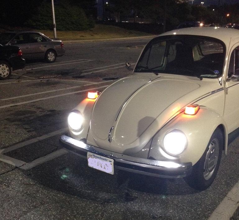

Last week I replaced the headlight halogen H4 bulbs with LED bulbs on my '74 SB.
HUGE difference. LED bulbs are way much brighter than halogen bulbs (although not as bright asHIDs) and have lower power consumption.
