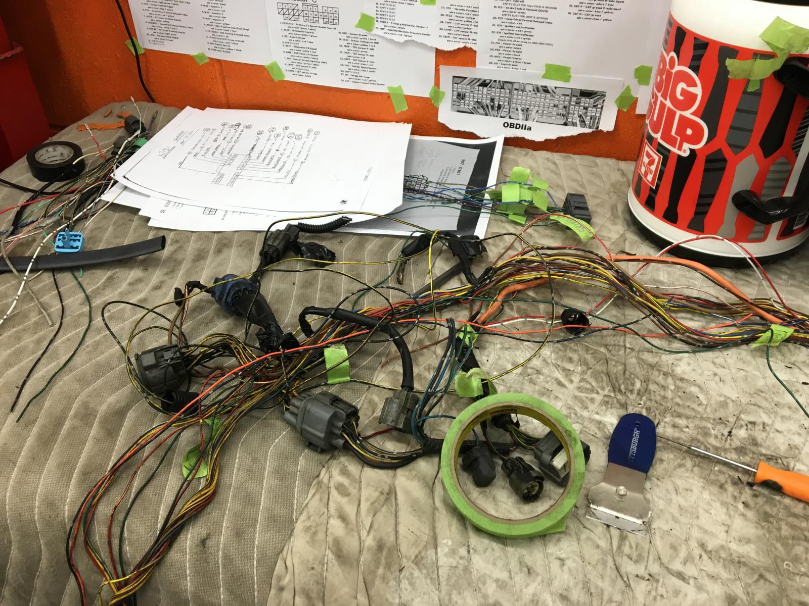

I started by removing the efi and ignition.
Then I started making the harness
Then I machined the adaptor to mate the Honda distributor to a stock vw distributor
Then I also built the ecu. This a stock civic ecu with a Demon2 hardware which allows me to make changes on the fly. I use a program called, Neptune to edit the Honda efi code. You can find more information about the program here. http://hrtuning.com/neptune-rtp/
The I bench tested the harness and ecu. Everything was working.
Then when all was done I could start mating the harness to the car.
Here is a few of the harness completed. You can also see the distributor in its final location. The tps sensor is the one that comes with CB Performance throttle body's. Which just a gm style tps sensor. The intake air temp sensor is a stock Honda unit I mounted near the driver side filter. The coolant temp sensor is mounted with a t fitting to where the factory oil pressure switch goes. Then last the map sensor is using a vacuum supply hose from both intakes.

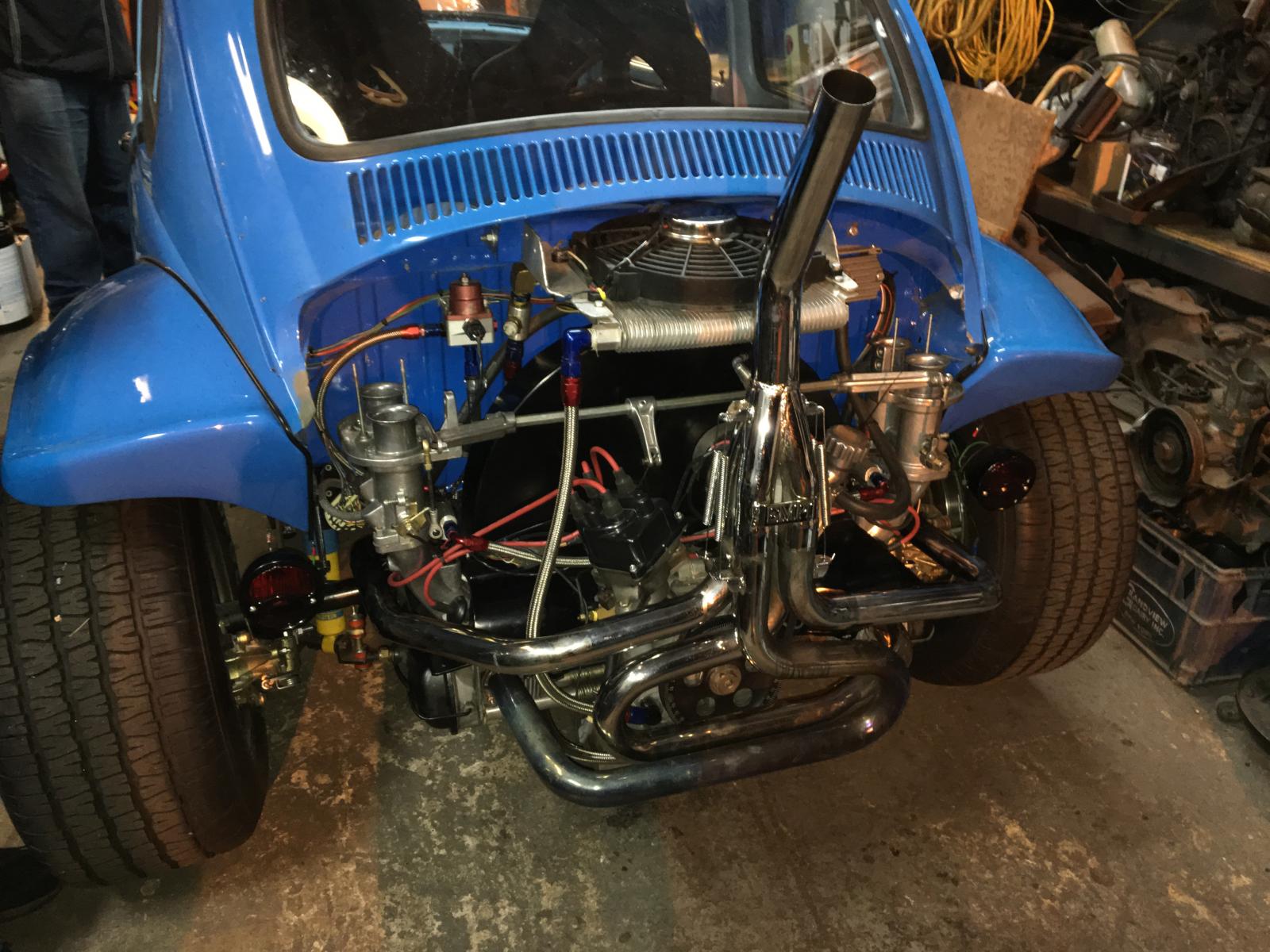

Here she is complete

I don't see an O2 sensor, what do you control fuel with? Did you remap the cold start fuel to allow for the oil not heating up as quickly as coolant does?
Not to rag on your project, I think it's a great idea, but why use that POS distributor? I can swap those out in under 10 minutes after changing dozens of them. The ignitors fail constantly in these things.

If you look in the last picture there it is under the fan. Right on the merge collector. I use An Innovative wideband/flex fuel sensor.
The ecu has its own maps for cold start and cranking while it is under a certain temp. That's all done before the dyno. Being on e85 it it is important that it has that adjusted correctly.
I use OEM Honda distributor because I use an OEM Honda ecu. They work fine for the type of power these motors are making. I haven't have an igniter gone bad on me in a long time. Not to say that it's not possible but they last just as long as any OEM part. This system is very economical and does just as much if not more then most aftermarket ecu with the benefit of being able to pick parts if they go bad at any local parts store.

Who mounted the breather box? Some one who doesn't understand gravity?
Someone who wasn't me. Rolling Eyes
