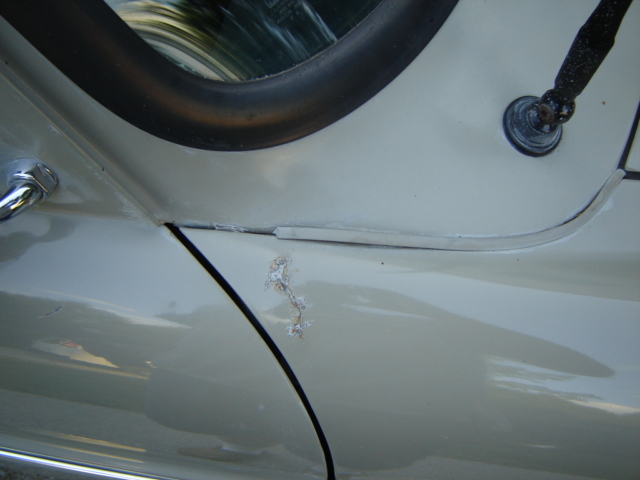

Rust:
Tops of front fenders near the windshield
Bottom of front fenders near the door
Tops of headlight housings and headlight buckets
Rear wheel wells and housings
Bumper mounts
Rockers
Notchback/Fastback - Rear pillars to left and right of the rear window
Squareback - Area around engine lid

Crooked or misaligned bumpers - may indicate unseen body damamge
Uneven gaps between fenders/doors and body - may indicate frame or significant body damage.
Rust around windows or bubbling in trouble areas. These areas rust from teh inside out, so always assume the worst

Does any one have any photos of what to look for / look out for. Its one thing to tell me, its another to show me. I am pretty familiar with Type 1's but I am really starting to lean towards purchasing a Notch for my next car and I am not quite sure what to look for, what the problem areas are, etc...
Posts: 71798
PostPosted: Tue Oct 28, 2008 9:07 am    Post subject: Reply with quote
Here are some common rust areas:
Bottoms of front fenders:
Bottoms of rear wheel wells:
Rockers:
Floors, although the battery tray is more common:
More - Front of floor by heater channel:
http://www.thesamba.com/vw/forum/album_page.php?pic_id=266920
