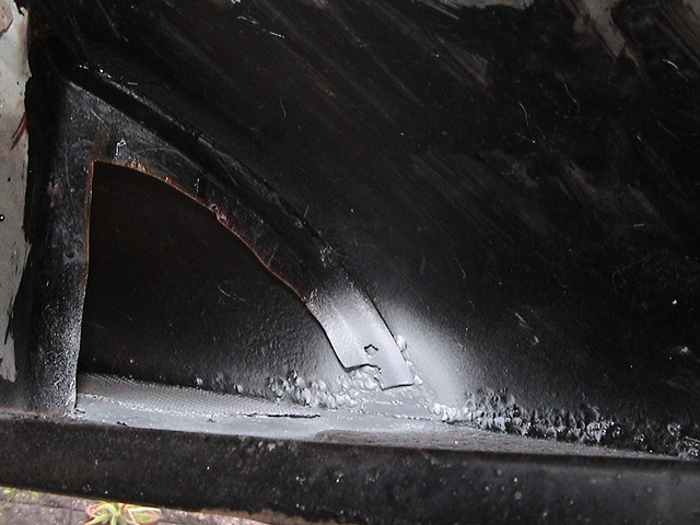

So what does it look like in there??? Shocked Shocked Shocked
left
right
airbox
The First patch
Choose the incision

cut a template for fabricating a skin graft
find a suitable donor
surgery and fitting the graft

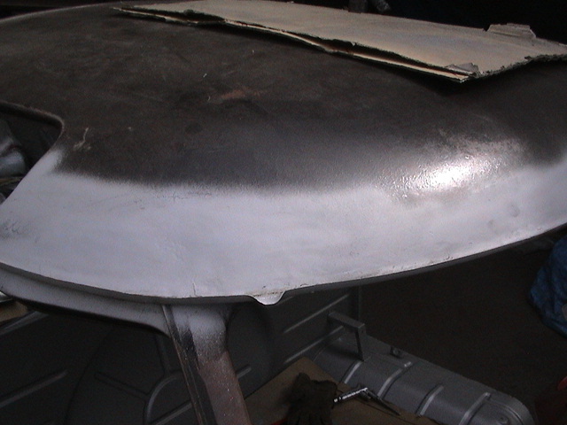

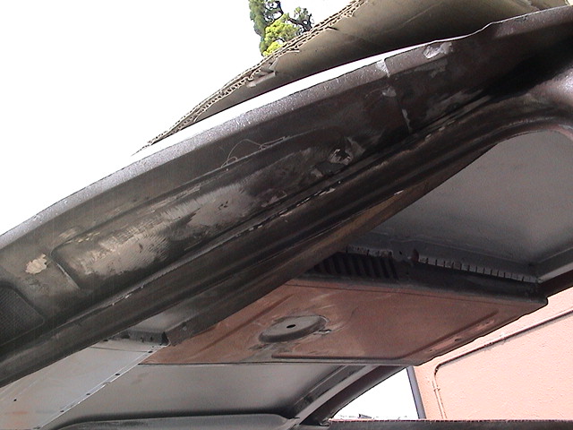

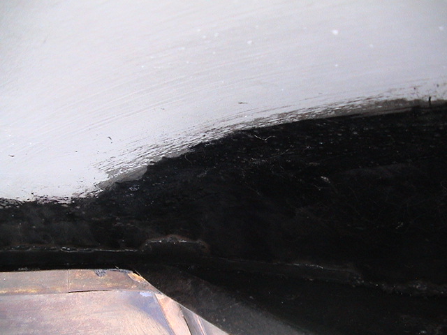

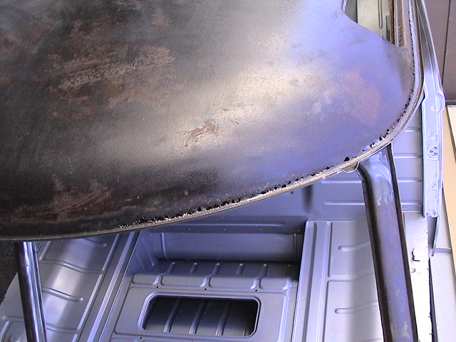

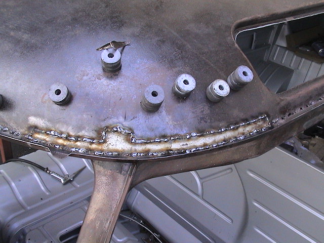

Well its taken me some time to get the front roofline done but now its over. Here's the work from the patch onward.
after some chopping
Sandblasted in there and splashed around buckets of rust converter then some fitting
add some stiction
and some more
most of the other roofline holes on this side were easy to weld up
a grind and then sanding disc. The curve is perfect, undetectable to the touch or eye.
a light spray of primer for the moment - no filler neccessary YEAY!!
inside

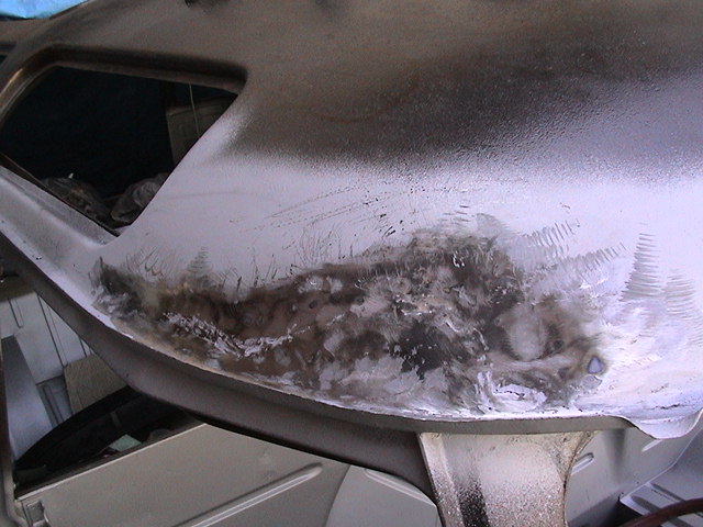

The Right hand side wasnt so nice.
and the inside
this one will need a skim. Maybe Ill get away with high build primer to lift it just a little along the weld top and left.
The lip/overhang and inside the air box are next
stay tooned Smile
