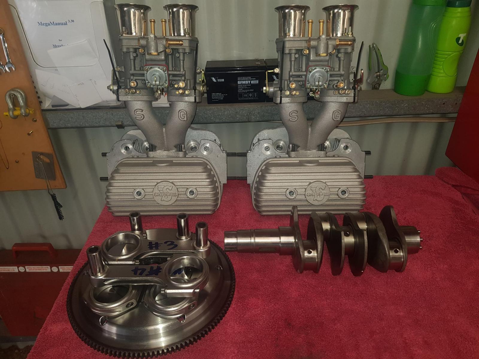

Here is a list of whats going in my motor if that will help clarify any thoughts or comments from you and others: it might raise more questions too ? lol
36hp case going for 1397cc
WW 69.5 crank
WW Okrasa heads (not using the rest of the kit on this motor)
AA 80mm pistons and barrels
AA 5.110 connecting rods
Mr Motorhead stage 2 cam
DPR flywheel for 200mm clutch
Speedwell 1.25 ratio rockers
S&G twin carb manifiolds
Gene Berg Carb linkage
2 x 40 IDF carbs 26mm venturies
vintage speed exhaust
full flow oil & external oil cooler
Will be moving to:
CB Performance EFI with twin IDF style throttle bodies
CSP exhaust
