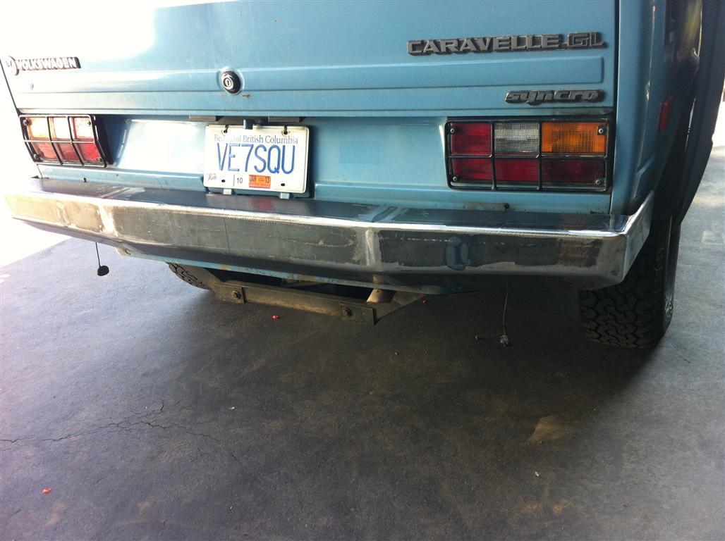

Back in 2011 I started the following thread about a set of bumpers I had designed: http://www.thesamba.com/vw/forum/viewtopic.php?t=606048&view=next
After many requests from Samba members my fabricator at the time decided that he would be willing to make some more bumpers to sell. Unfortunately he was only able to get a few more done before he got swamped with a promotion at his full time job and with new twins in his family life.

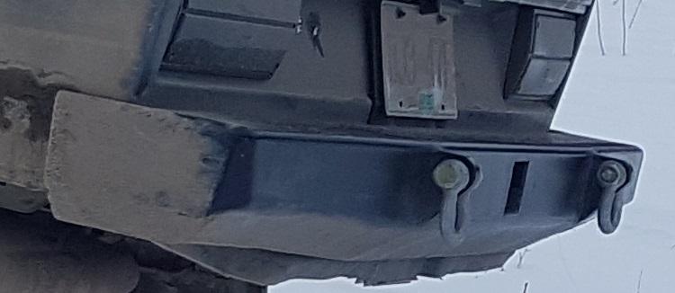

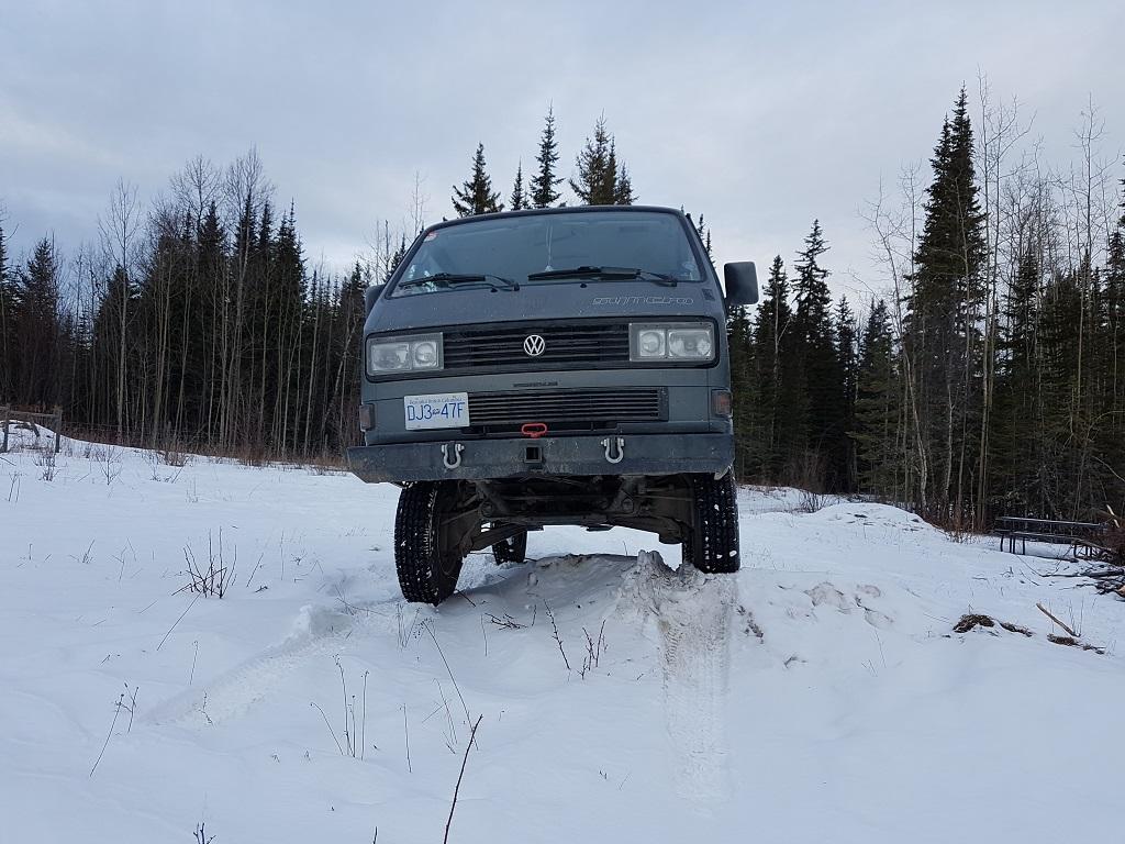

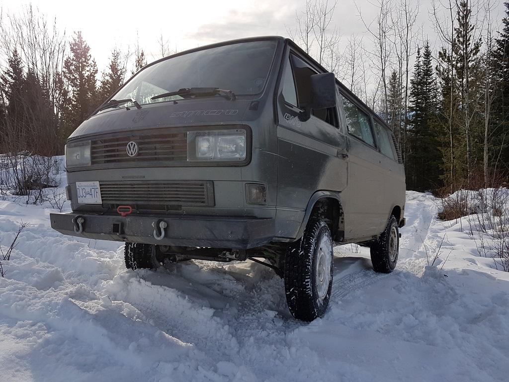

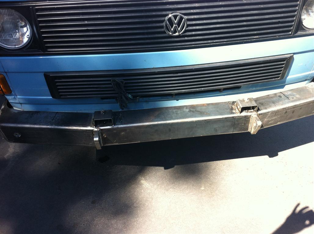

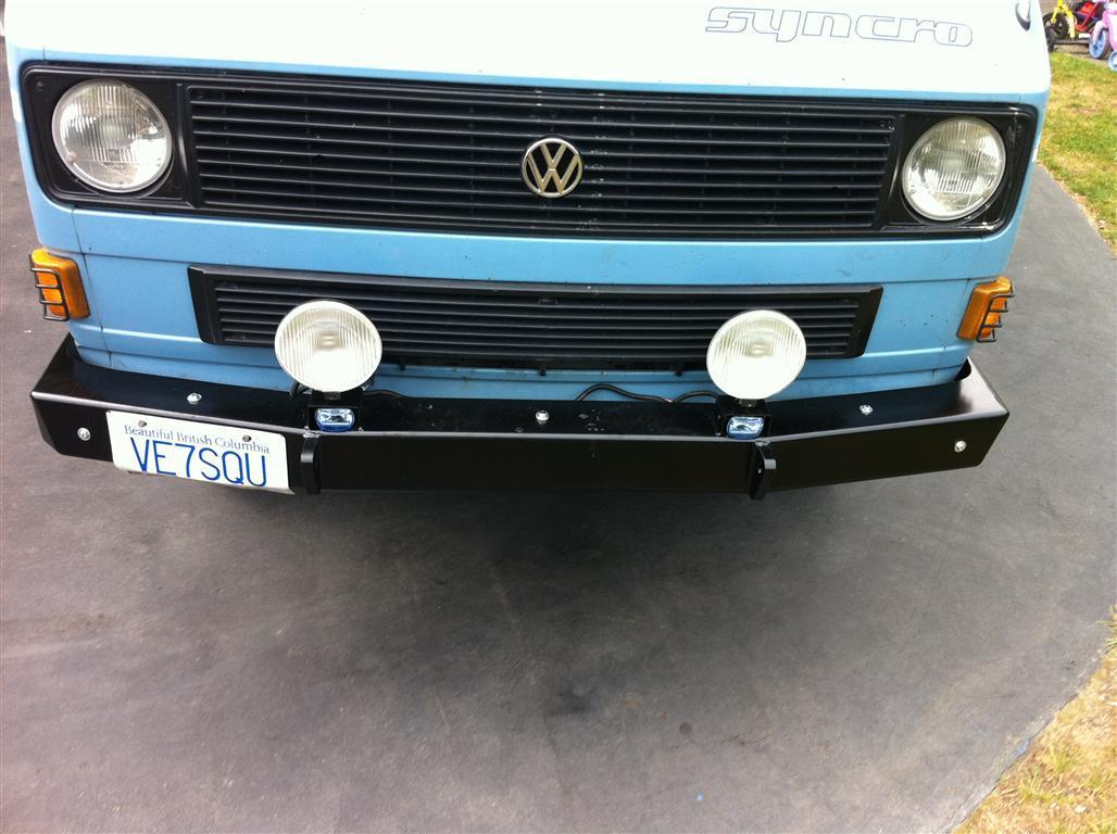

The big goal of anything I design is simplicity and functionality, though I do try to make it look good too. If you have read my last bumper topic then you already know that when I designed my bumpers it was because I wanted something less bulky and flimsy than the other offerings at the time. Since 2011 there have been a fair number of new bumpers that have hit the market and some members have even done a great job making their own versions of what I had proposed.
The following is a list of requirements for the bumper design with some amendments:
1. Must maintain the factory approach and departure angles without removal of the crumple(crush) zone.
2. Must have D rings or Shackle mounts for towing. (though I may make this optional)
3. It should be winch compatible.
4. It should be skid plate compatible. For custom skid plates.
5. The bottom lips front and rear should be angled to prevent digging in while off road. Perhaps the corners too(as was the case on the1.0)

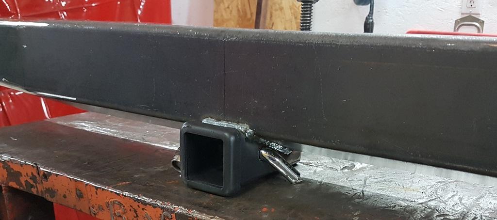

6. The rear bumper must have a high clearance 2" receiver.(Though I am experimenting with a lower clearance design that allows the use of a horizontal pin since the last design required a vertical pin)
Below are some pictures of Version 1.0 and 2.0. I know it is hard to please everyone when developing a product but I would appreciate your feedback.

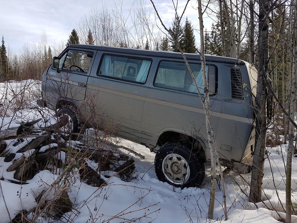

This was an unintentional strength test of my rear bumper a week ago. I was having some fun in the back yard and while driving over a snowy pile of logs the van slipped back and to the right. Even in person from a couple of feet away it looked like the tree had hit the back hatch, thankfully when I looked up close there was about 1/8" between the tree and back hatch. I was very thankful that I have a beefy bumper.
Below are two pictures of the latest receiver design. Let me know what you think. Personally I like the flush mounted receiver like you can see pictured on my front bumper pic above, this requires a vertical hitch pin which means drilling whatever you insert into the receiver. The new design allows you to use the receiver in the normal configuration but does encroach slightly into the departure angle.

Finally steel bumpers that don't look like slabs of beef stapled to slabs of plywood.

I forgot to mention in the first post that the ones pictured are 3/16" steel plate but due to peoples weight concerns I will be offering these in 1/8" steel.
My personal rear 3/16" bumper with receiver, shackle mounts, shackles, body mounts and some extra gussets weighs in at 57.5lbs., the stock rear with end caps and mounts was 30lbs. On the back that's only a difference of about 28lbs. On the front the stock bumper is about 23lbs(23.5lbs if I recall) and my bumper replacement would be lighter than the rear as there are no body mounts or reciever (unless requested). I estimate that my front bumper would weigh about 24lbs more than stock. The 1/8" should be roughly 1/3 less than the 3/16" so it will be a minimal weight gain but whole lot stronger.
