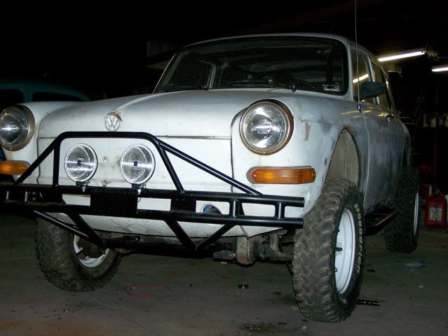

... So it's not really that big of an adventure... But it was to me. I actually have this thing running and got to drive it around a bit.
WOOOO HOOOO!!!
For those of you that aren't familiar with this project, my 15 year old son and I are building a Baja Bug from a Squareback for his first car. Yes, it's not your typical lowered T3 that you'd find in this forum. Quite the contrary. Here are a couple of pictures of progress so far....
And here it is driving on the street.....
So here's where I could use some ideas:
It drives OK, but it seems to be overheating miserably. The previous owner had it stored for many many years, so it wasn't running when I bought it. The guys said that there was about 30,000 miles on the engine, but he could have been giving me a line of crap. Who knows? I don't have any gauges on it to get actual temps, but after you drive it for about two miles, the oil light flickers on the dash. I used some synthetic 5W30 in it that I had laying around the shop from my baja, and plan on trying some thicker oil. I've looked at timing and timed it to 30 BTDC at full advance (009) with dual ICT's (new). I know I should change the idle jets to 55 or 60, so maybe that's contributing. I didn't do a full compression check, but I did check one cylinder and found it pumped up to 100 at full operating temperature. Maybe I should check them all. It seems to have plenty of poop, so no issue there. It runs smoothly through the whole power band. There's no smoke and no smell of burning oil, either. Anything else you can think of? I'm going to drain the oil, refill it with 20W50, and do a valve adjustment today. I'd sure like to have it running well before the Classic, but know that it may actually need an engine.
I have about 20 years of VW experience, but very limited with a T3 (I only had one once before).
Your thoughts?

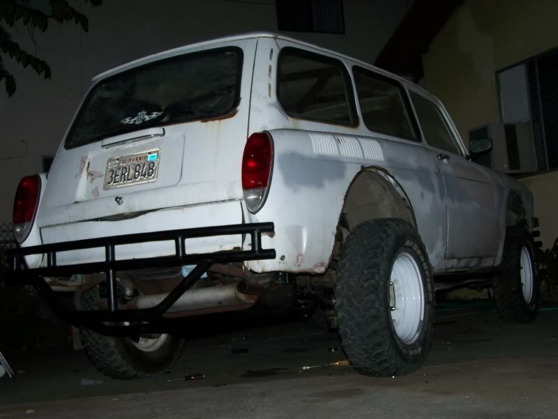

He's got the cooling bellows in place as shown in this pic.
I am however wondering if his taller than stock sized tires (look like 235-75's) might be causing the engine to lug, thereby overheating it. d'oh!

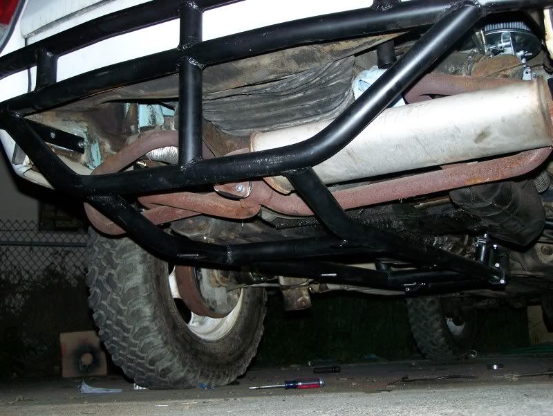

Thanks for the encouragement guys. Here's an update:
I was thinking about the bellows misalignment and found that to be restricting the airflow, as it was pinched somewhat. So.. I removed the bellows for now. I have cut up the fenders so far that it is actually service as a ram-air intake for the cooling air behind the tires. After removing the bellows, it didn't make any difference whatsoever.
So I adjusted the valves, changed the oil to Royal Purple 20W50, and took apart the passenger's side engine tin to check for problems with the thermostat. I discovered that there is no thermostat, and there was no debris in the engine there. That was a very good idea about the mouse nest. I'd never have thought about that.
So I took off the hose that goes to the heaters on the driver's side, and it literally fell apart. Hmmm. After looking at it, I noticed a couple of great big holes in the aluminum flexible tubing going to both sides. So for now, I removed both sides and capped them off with the bottoms of baby bottles. I hope my wife doesn't notice them gone or I'm gonna be in trouble!
I just drove it about 8 miles, 3 of which was on the freeway. It runs fine with no oil light at idle.
Hmmm????
Maybe there is/was a rats nest in the driver's side? Maybe the cooling air escaping was causing havoc, but I would have never thought it would have been happening that quickly, and with the ambient temperature as low as it's been lately.
Hmmmm.....
For now, I'm going to continue driving it around town until I see reason to do otherwise.
Keep the suggestions coming, though.
