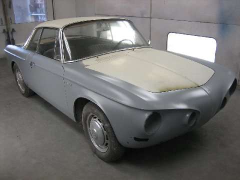

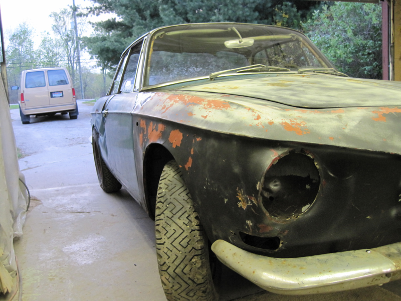

I had some time to work on the T-34 today, while I was waiting for the clear to dry. Here are some pics (I posted them because otherwise it didn''t happen). These are of the roof. I wanted to find out how hard that was going to be to fix. It wasn't.
This one is of the dent in the right front fender (afterward). I used the turn signal housing to get the fender close, then added the bumper to find out how far off the clip was. It's not too bad, but I think the bumper irons need a little tweeking. the gap across the front looks consistant though.

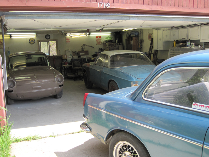

And of course we needed a group shot, now the Krusty got his rims back.
Hopefully the 1500 club doesn't mind me using Thing tires and wheels on the t-34, but they are german (OE 1973 Continential's), and have tubes, so they hold air. They're great for rolling around the shop, but I wouldn't want to drive on them. Rolling Eyes Also, are T-34's supposed to sit so high in front? I keep looking at the April 2010 T-3 calendar, and it seems this one's nose is up in the air. It's probably fine, and I'm just used to lowered cars. Wink I'm trying to keep this car 1500 club eligible, but it's hard. Wink
I'm going to use this thread as a build, since I know I'll be asking questions on what interchanges with a t-1 ghia, seals and other hard to find stuff I'll need. So far, most of what happened, happened today out in the shop. It was a nice day though, so I figured I'd find out where I stood on what I had to work with.

Hey Bob, welcome to the Type 34 world. It does look a little high in front, maybe an inch or so. I think the 1500 Club would be OK with a slight adjustment to even out the height. Wink

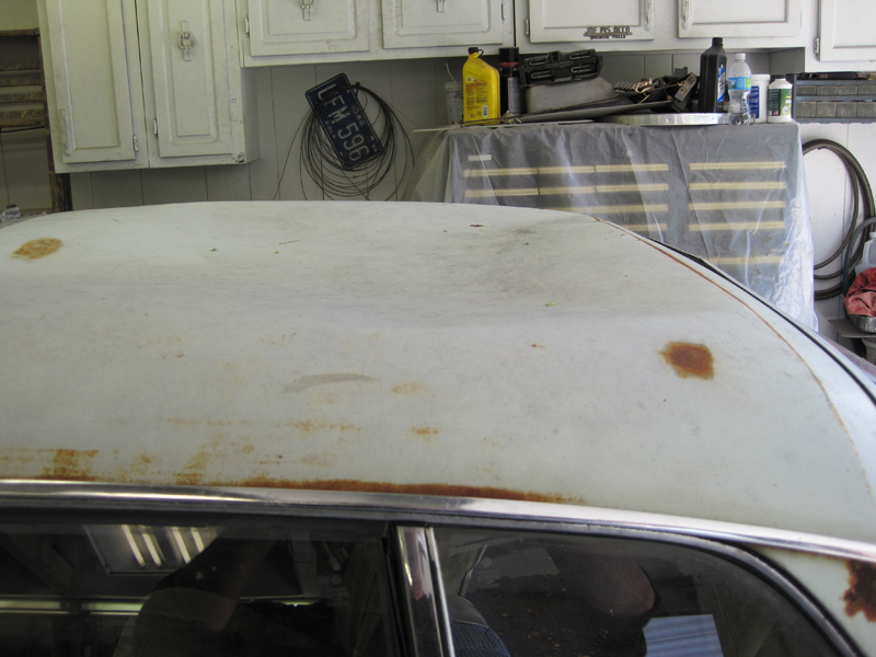

Yeah, it just popped out with a couple of slaps from my hand. It still has a small dent up front that I'll get later, along with a pinch point at the rear where the tree branch probably made contact 1st. It did come out pretty good though, and does look better than it did. It's kind of like the tire dent on your Square you picked. After Dave removed it, it popped right out. Thanks for the compliments though. Very Happy

Being high in the front, could be because the front suspension has been unloaded for the last 6 years.
As I discussed with Bob, many of the small dents are salvage yard damage. That car sat around savage yards, from 1968 when it was wrecked, until I bought it in 2004, as a parts car.

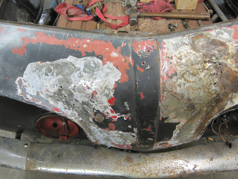

i remember when i changed out the nose on mine,..the PO pushed most of the dents out, then hit it with a side grinder, laying waste to all the subtle curves and details, burning the edges to razor thin thickness.
it was a disaster.
it was a disaster.
This one kind of looks like that too, maybe even the same guy did the work, except I don't think so, since he didn't even bother to knock the dents out. Shocked Sue came out last night, and started "playing" on the t-34. She was just picking at the flaking/cracked bondo on the right side. She didn't stop until it got thin at the edges. In some places it was a 1/4 inch thick. Here's the pics.

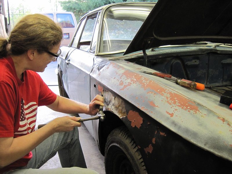

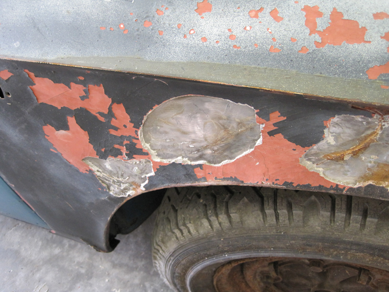

While she was doing that, I was beating on thebig dent in the nose. While smaking it, the rest of the "Cali arrowhead" came out. It's the right one in this pic.
Here's a couple of after I beat most of the dent out, along with removing some more bondo in the right side of the nose.
That was it for last night. It also looks like there were 2 different antenna locations in the left front fender that got brazed over. I'll investigate that later.
