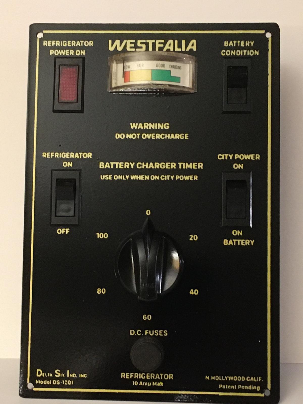

I might be a bit late here but.....I found the EXACT switches the Westfalia Delta Six control panel uses at our local RV Shop.
The Transformer should put out 12.5 volts minimum.
Consider using the control panel to power Relays outside of the control panel to eliminate any high amperage going through the panel itself.
I just finished restoring my old, worn, faded and burned panel.
78 Westfalia Campmobile Deluxe
As long as I have my Bus, I have a home.

PostPosted: Sat May 07, 2022 3:53 pm    Post subject: Re: Westfalia Refrigerator Reply with quote
how did you restore that panel? my etchings are faded

jmstu76 wrote:
busdaddy wrote:
Systems vary, some have dual elements, others have a single 12V one and power through the converter (transformer), but start by checking the fuse inside the transformer, some are blown, others have dirty tabs. Unplug everything first, there's live things in touching distance in there.
Good information. I have dug down to the glass fuse before. I am thinking a new transformer may be the ticket to a better charger and a higher cleaner DC output.
Well yeah, something that managed battery charging and supplied cleaner power would be useful.
There should be one of those plastci terminal blocks where the wires join inside the fridge cabinet, some meter work there can determine if you are getting power, and/or if the heating element has resistance.
