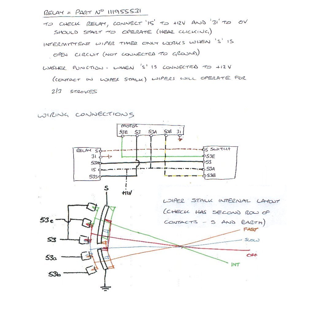

PostPosted: Fri Mar 10, 2006 1:07 am    Post subject: Reply with quote
Well, looks like sammypsycho beat me to it, but here goes anyway:
[img]http://www.thesamba.com/vw/forum/album_page.php?pic_id=261257[/img]
If the picture doesn't show, sorry Embarassed it's in my gallery, look there.
I can't remember where I got the relay from, might be an early Golf (Rabbit in US). You need to check the part number though, as some of the Golf ones have extra terminals and might not work the same way.
You also need to check that your wiper stalk has all the necessary connections to make it work, look for the second row of contacts, or check the number of wires coming off it.
It's not written in my notes, and my Bug is 100 miles away in London so I can't check, but I seem to remember that the wire for an electric washer pump was black & red. Can anyone else confirm?
Hope this helps anyway.

PostPosted: Fri Mar 10, 2006 6:59 pm    Post subject: Reply with quote
the relay # is on the diagram, the relay with the extra leg can be used for electric w/washer pump { i have been told haven't tried it}.
