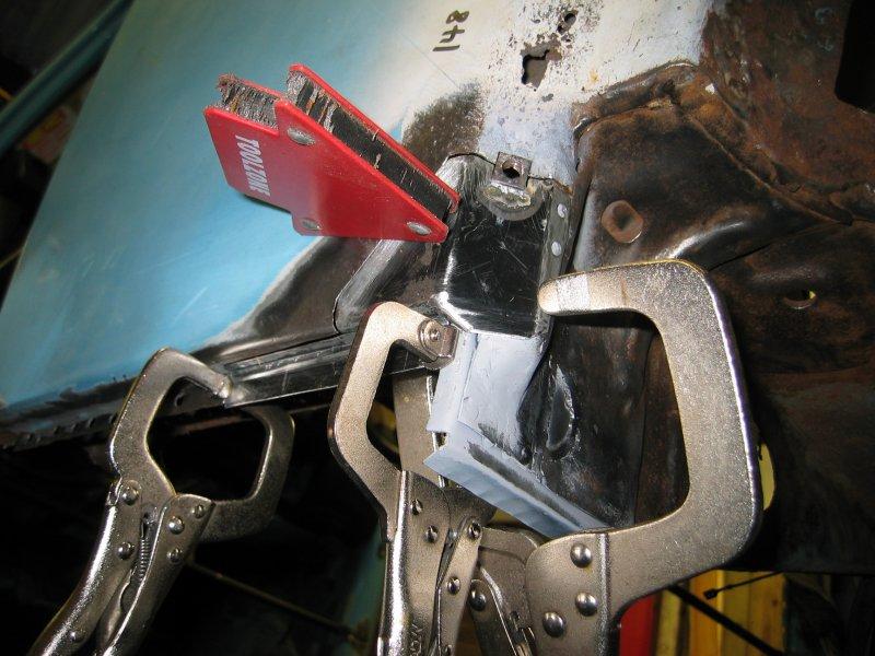

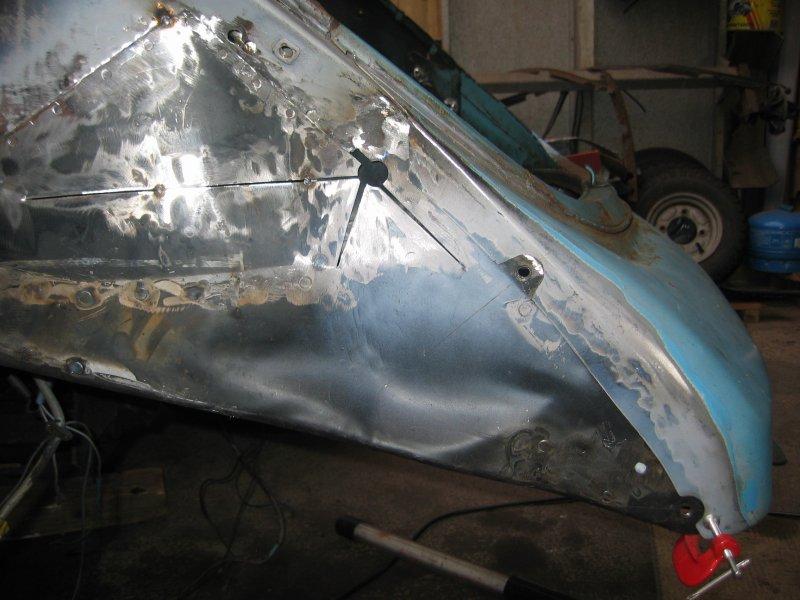

Having done some stripping down I decided to start on the rear bumper hangers as an easy job to get back into bodywork. These had been badly patched in the past. I don’t think I was fully prepared for how crap pattern panels are these days…
Rear panels cut away on both sides
First fit of the pattern panel. I found pretty quickly I couldn’t get it to fit against the engine side tray correctly without all the pie cuts you can see. You can see by this stage I had removed the bumper bracket from the panel and had to relieve that too, to match the new (correct) shape. Major headache starting!
With everything tacked together I trial fitted the wings and the bumper brackets. The brackets were pointing out of the rear at really crazy angles, and also too low for the wing slots. Cue more major surgery. Honestly it would have been easier to beat these panels out of flat sheet…
Surgically altered bumper bracket before final finishing and refiting to inner wing
Rear end all reassembled. Some of the welds will need a skim of filler, but this will all be covered in stonechip so I’m not being too precious. I had to rebuild both edges of the rear apron to reproduce the factory spotwelds as they got shredded undoing the previous repair welds on disassembly. Looks good now, and both bumper brackets exit through the wings square and in the centre of the slots.

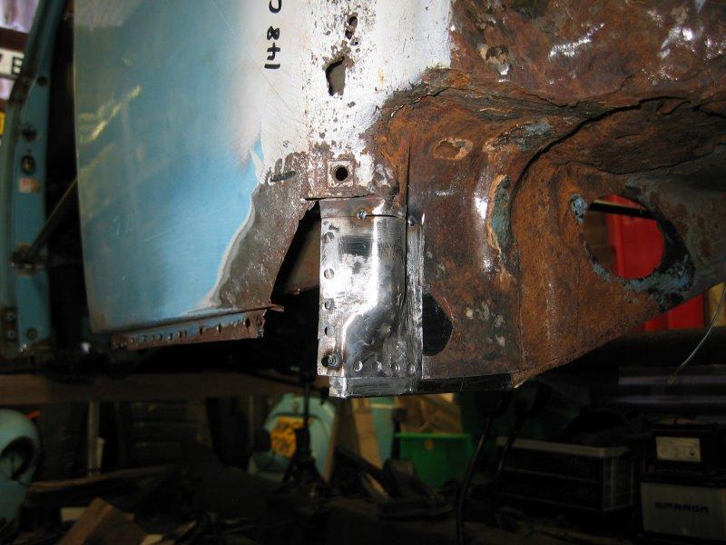

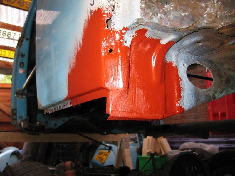

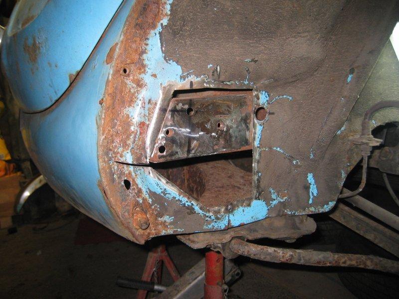

So onto the front end. Both front bumper mounts looking crusty…
Cut away the outer panel and find the reinforcement is pretty rotten too. Mostly superficial but the centre was crumbly.
Cut away the rotten bits and replace with new steel and captive nuts
New plate fitted, horn bracket and the reinforcement piece on the other side of the panel were transferred to the new piece

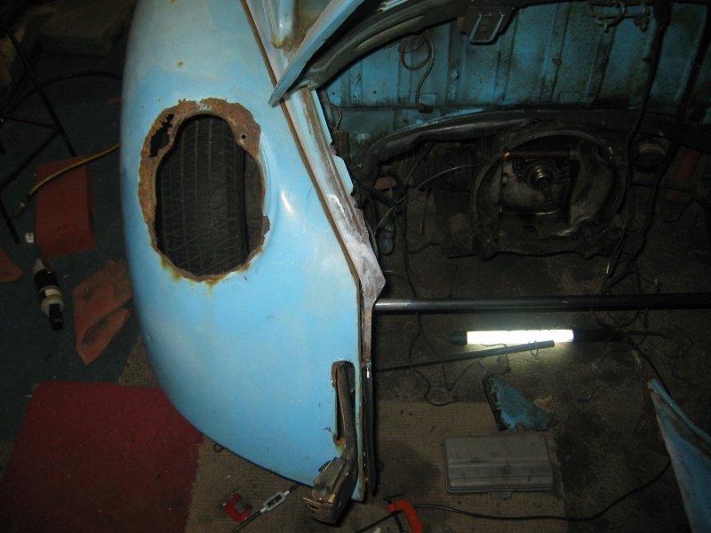

Front apron was kinked and pretty crusty on the edges, so off it came…
Both edges of the quarters needed repair. I got a mate to make up a little press tool so I could reproduce the recess around the captive nuts for the wings for the factory look. No-one will see it but me, but it makes me happy!
Replacement front panel fitted. I removed the seal clamp as will be fitting a ‘mexican’ type seal.Fit was OK apart from where the latch fits, which was a bit tight. The secondary latch for the bootlid was really flimsy, so I transferred the heavier gauge part from the original panel.
I found that the new panel was thinner gauge steel than the original (no surprise there I guess…) so had to make a little reinforcement bracket to rigidly support the bootlid latch as it was flexing too much. Tried to make it look ‘factory’ rather than bodged. Not sure whether to leave the rivets or fit it more permanently

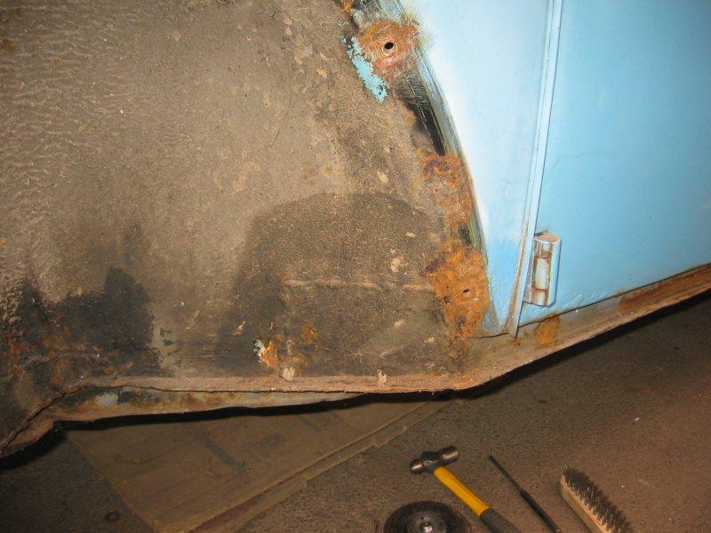

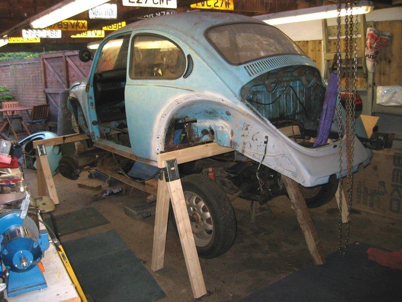

So – heater channel and body off time! Undoing the body mount bolts:
“It just came apart in my hands” (This was after attacking it with the air impact gun)
Hooray for air tools! All but one of the body mount bolts came out in the end without shearing or loosening the captive nuts. One rear mount in the inner wing had a rounded head which I had to cut the head off and undo it after the body was lifted off.
Body braced for the lift and heavy surgery
Body is off!
“The first cut is the deepest…”
Full horror revealed…

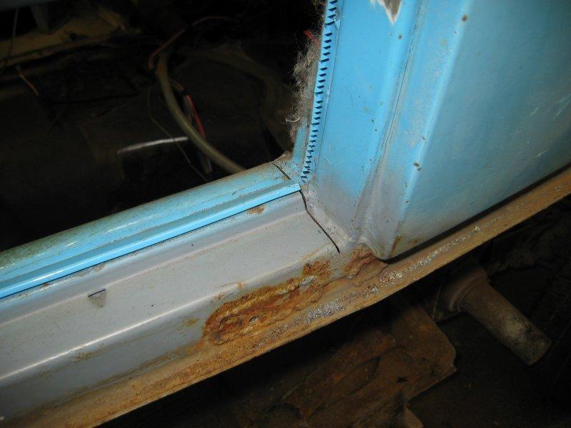

Thought I’d start at the back, rebuilding the parts around the heater channel before the new channel can go in. This area wasn’t too bad, so I made small patch panels up rather than fitting pattern panels. (Other side of the car is much worse)
Done!

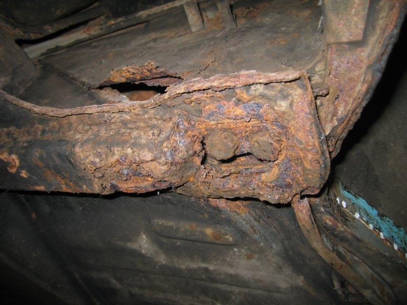

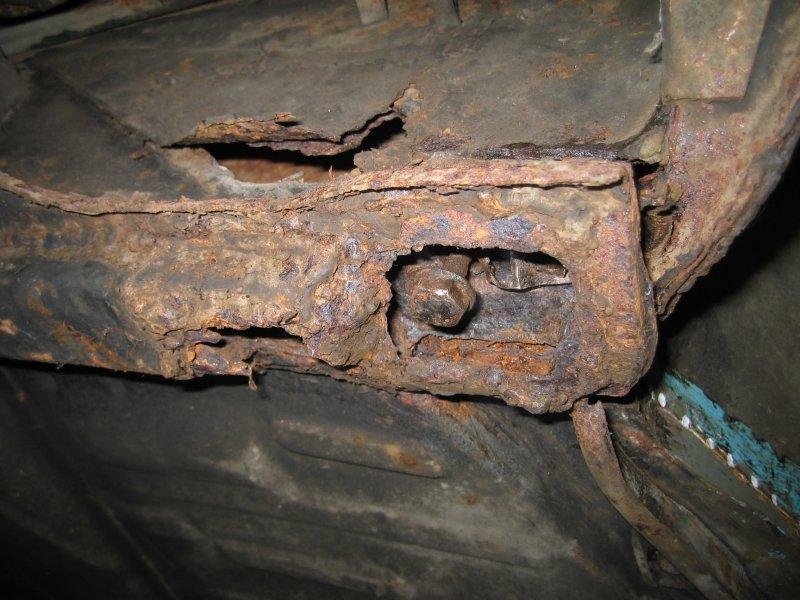

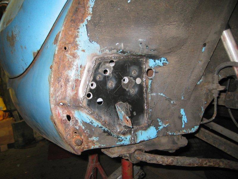

Did some more digging over the weekend.

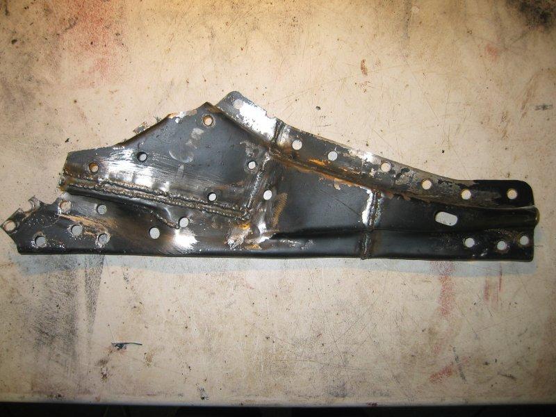

How does a small rust hole on the outside become such a big hole as you dig to find the extents of the rust? Shocked
Getting the inner corner reinforcement bracket off without chewing up everything around it was a sod of a job, but I got there in the end.
At least everything here is simple sections, patching it shouldn't be too horiffic... maybe
I had that same area on my car rot out too! One piece at a time it went back together.
Yeah, I think VW missed sealing around the inner corner reinforcement piece which allowed mud and water to get behind and rot it out from there. This one will be well covered in seam sealer when it goes back together!
As this is a UK car, this is the worse side from splashing in puddles at the (gutter) side of the road. Driver's side is not rotten at all apart from lower edge of the bulkhead, a much simpler repair.
Looking forward to posting a photo like yours with all these holes replaced with fresh metal!

Been doing more digging in the quest to get to the extent of the rust - LH side of the front bulkhead is basically all air now, and still more metal needs to be cut away. I think this is way beyond patching and I'll have to bite the bullet and fit a pattern part. Evil or Very Mad
The panels available seem to be basically standard beetle bulkhead inner pressings which are altered at the edges where the super beetle attaches to the heater channels differently. Anyone fitted one of these? Does it cause any problems fitting the centre brace to the floorpan spine or the pedals / footrest panels?
As I'll have to do a significant amount of work on the pattern bulkhead anyway, I'm thinking of transferring what I can of the original inner panel upper onto the new bulkhead, and just using the lower part to give me the correct profile to seal onto the napolean's hat panel on the floorpan.
