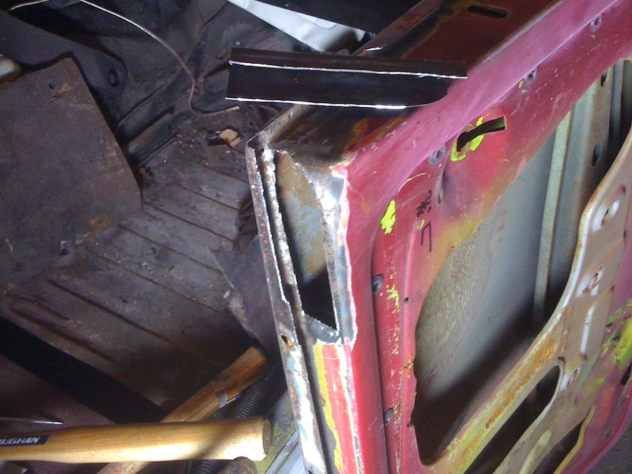

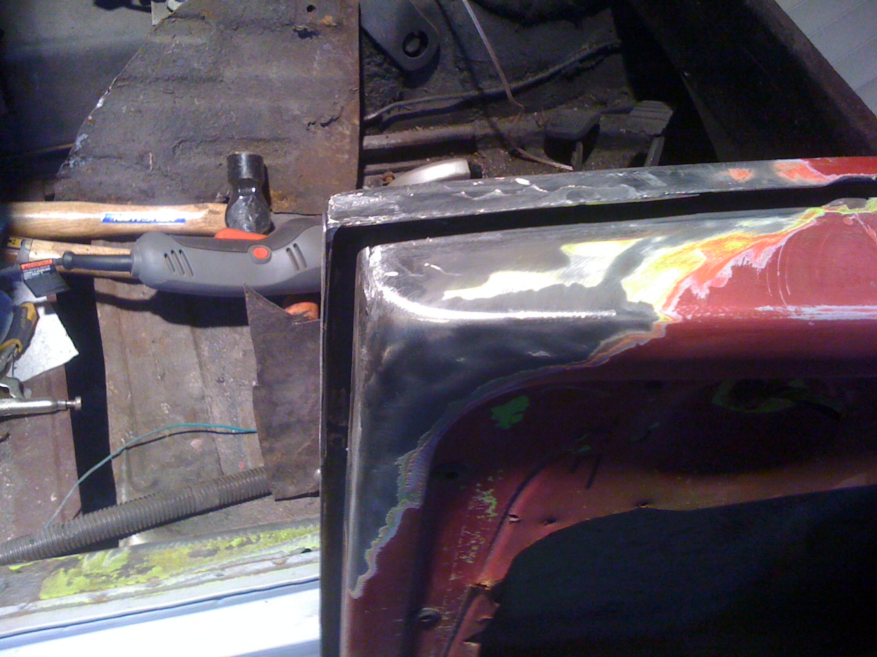

PostPosted: Mon Oct 03, 2011 5:21 pm    Post subject: Reply with quote
Doing the door repairs....
Bottom rear of drivers door.
About 1 hour invested so far in this door repair patch, time for evening relaxation......
Patch piece bent, rough hole cut for it, will nip and fit until it sets in flush with the old metal.
Cut out the old, fit it more exactly and welded in on the door bottom...
Welded in a new door seal flange and ground off welds. Still detail work to do on flange and "B" pillar hinge side seal flange to weld on (where ground clamp is), but almost done....

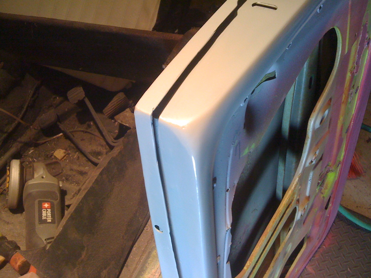

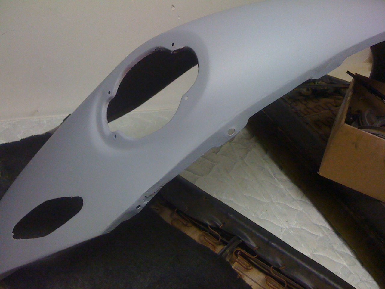

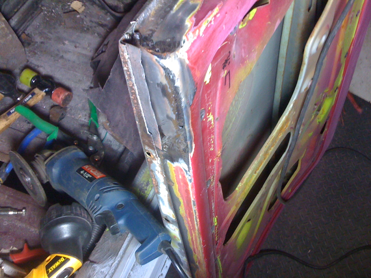

PostPosted: Tue Oct 04, 2011 5:57 pm    Post subject: Reply with quote
Continuing on, another 1 1/2 hours and it's ready for scratch fill, primer and color.
"B" Pillar seal flange welded on. Still needs a little grinding....
First primer coat....

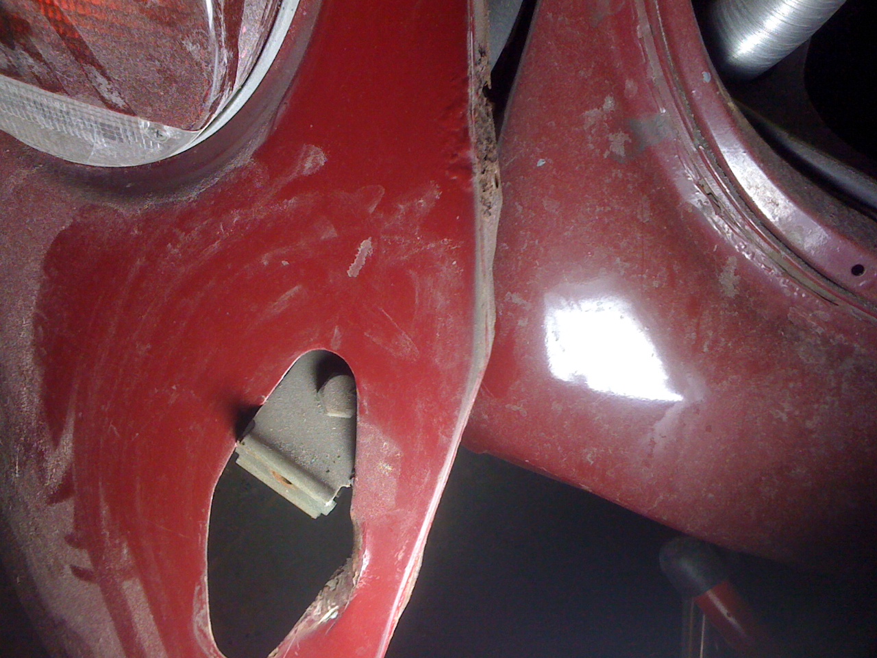

On to the next rusty spot!!! The rear fender!! See that bubbling paint to the right of the tail light? That in almost all the way through. It's going to be a cut out and weld in process. The bumper hole, straightening is all that's needed. The rear apron, bubbling lifting paint....oh joy!!

Yeah, it's coming along. That rear fender will finish off the driver's side body repairs so I can get it painted. I'm losing my good painting window with Winter rushing in!!
I'm not finishing the floor pan just yet, I want to get the Passenger side body done as well. I can weld in floors during the winter months inside the garage and do the interior without worry of being too cold or collecting fumes inside a closed area.

So happily the Right rear fender isn't as bad as I thought! Good NEWS!!
The rust perforation was only along the bolt on edge towards the body and the fender surface ended up with solid metal after grinding off the rust.
Cut out the rust and welded in some metal, treat the rust and putty it up and all will be well!
In the grinding process I've found that this fender is a replacement being from a Gold Beetle. Who knows why or when!?!?
The worst of the perforation.....
a 2nd perforated spot...
1st successful metal graft...
2nd graft...
Edit: Fender primed, ready for sanding and color coat.
Now to quickly turn the car around (have if favoring one wall to give working space) and pull the other two fenders. A few quick repairs and maybe, just maybe I'll have some paint on this before this warm early October break fades away!!
