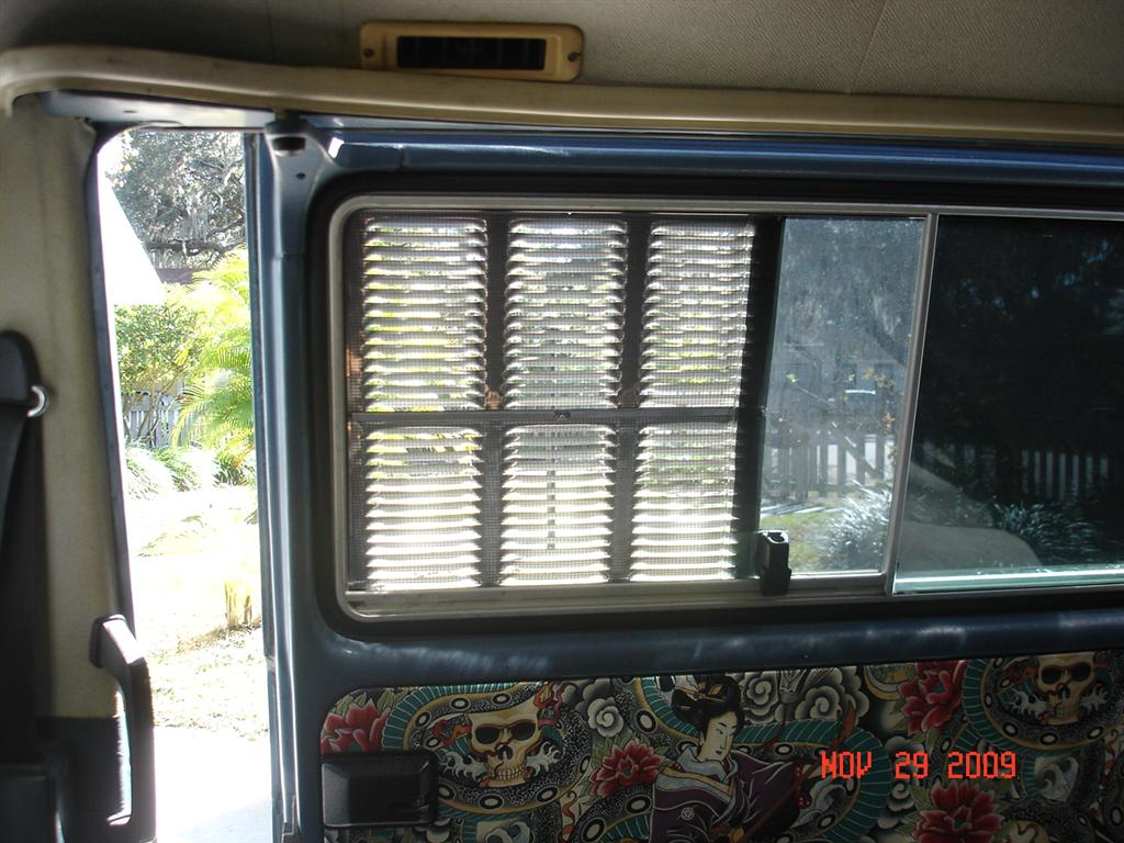

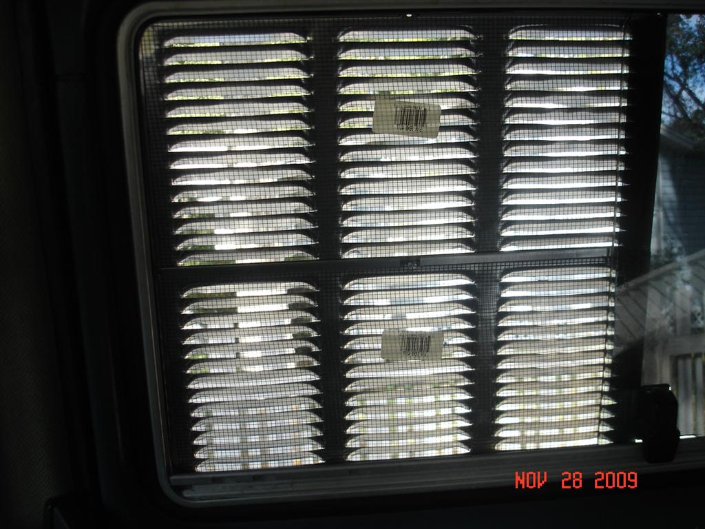

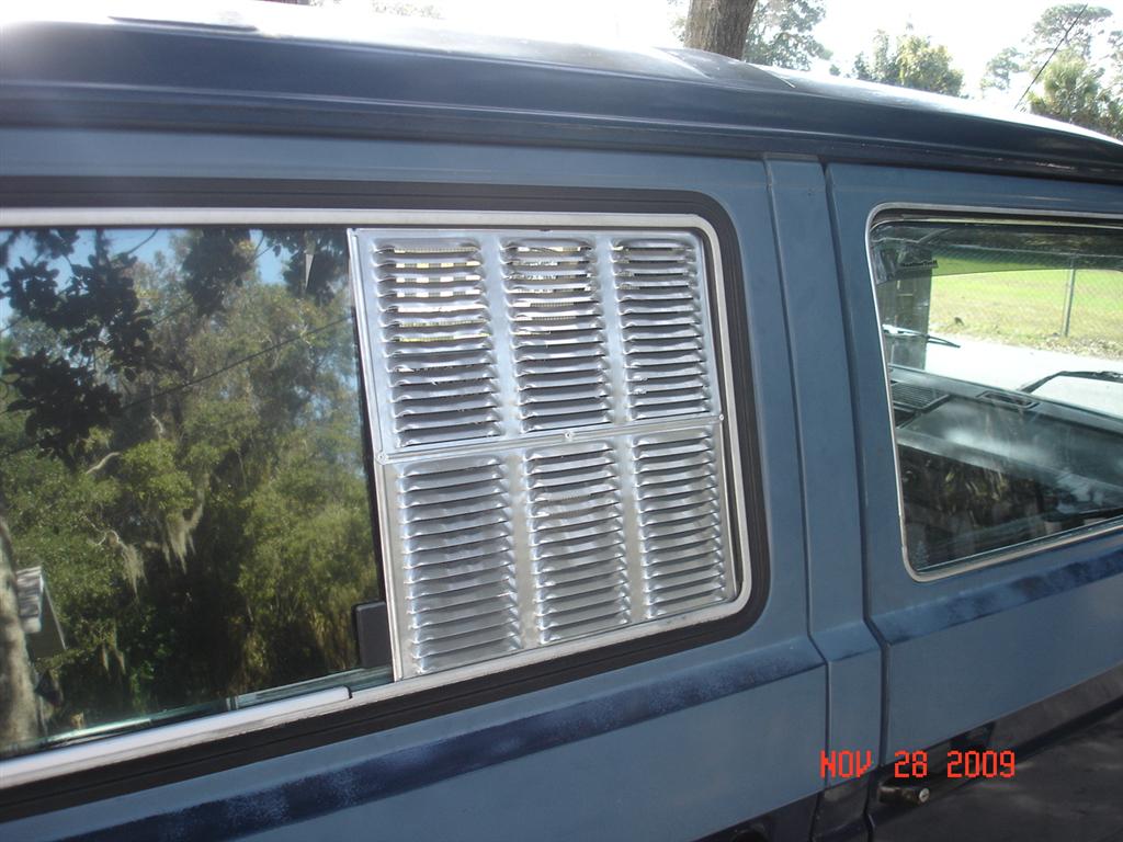

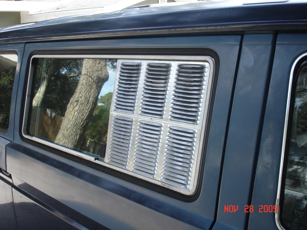

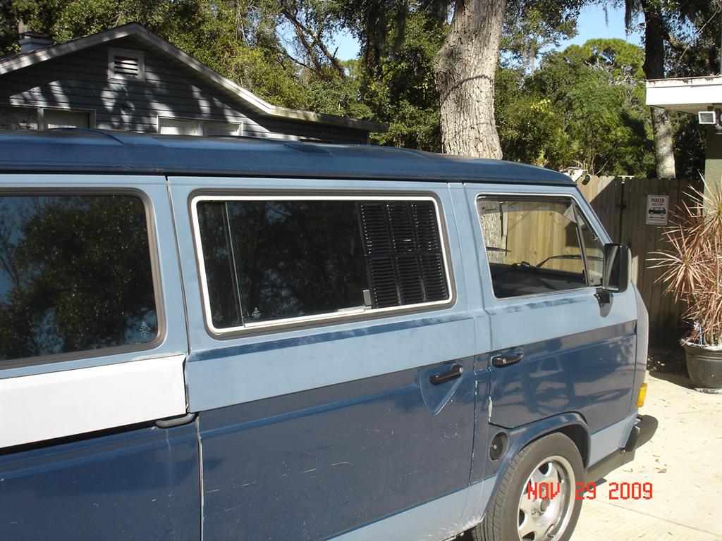

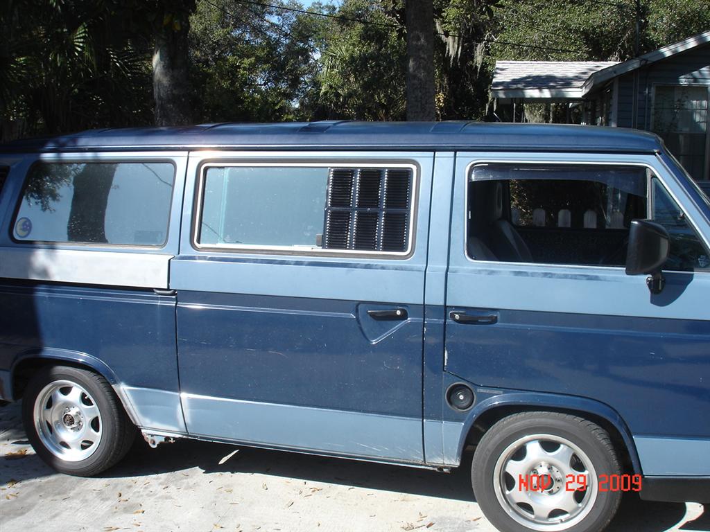

I picked these up at Lowes for @ $2 a piece. They are 8" x 16" aluminum vents. I pop riveted them together to make one piece. The size is perfect to fit in the window opening. It is flexible enough to "bend" into place. I had to increase the radias on the top and bottom to fit the contour of the frame better. I closed the window to hold it in place using the outside of the latch to push it towards the frame. I think I'll end up painting it black so it doesn't look so obtrusive.
I don't recon they'll hold up in a hurricane but they should do fine in a rain shower Laughing

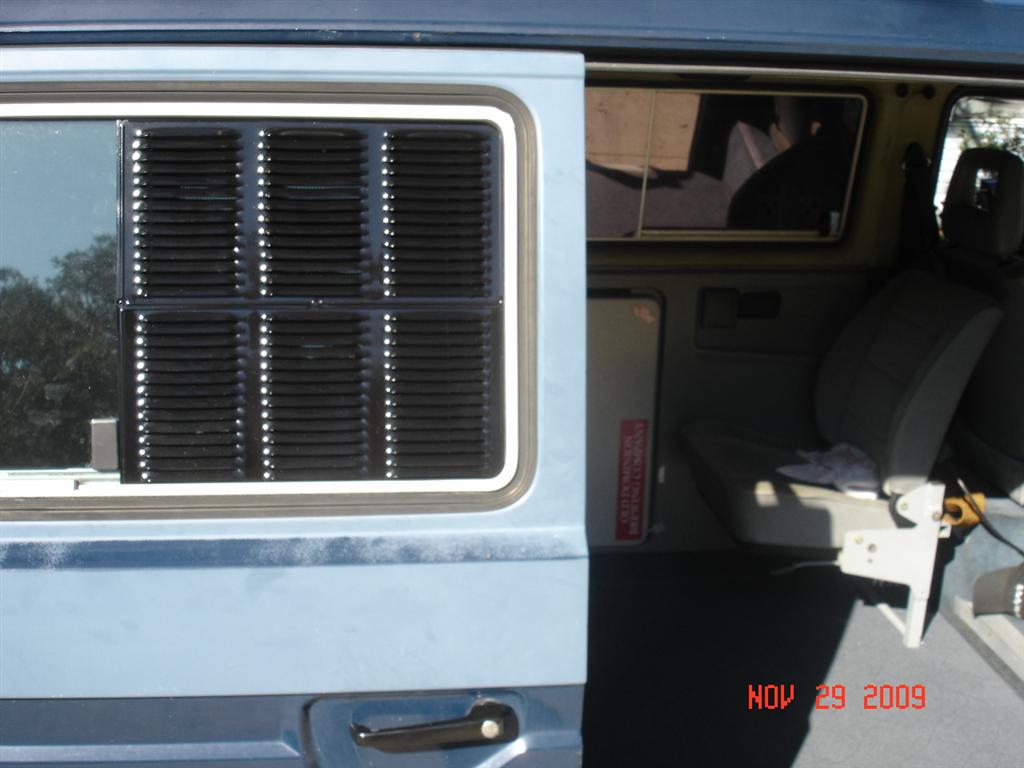

Take those UPC stickers off from the inside. Have pride in your work man, don't stop before it is fully elegant.
-- 1987 Westfalia automatic (Captain Vino)
SteveVanB
Joined: June 01, 2008
Posts: 1645
Location: This side of Daytona
SteveVanB is offline
PostPosted: Sun Nov 29, 2009 11:20 am    Post subject: Reply with quote
Alright, stickers removed and paint applied! Mmmmmm.......... elegant Wink
