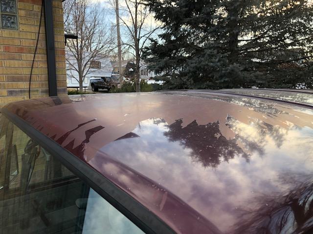

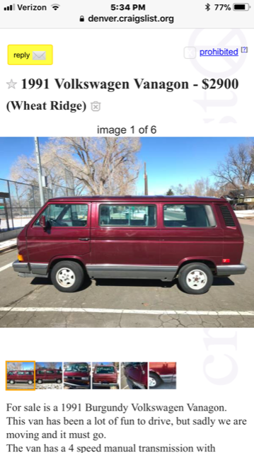

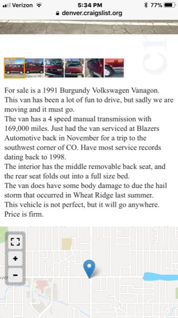

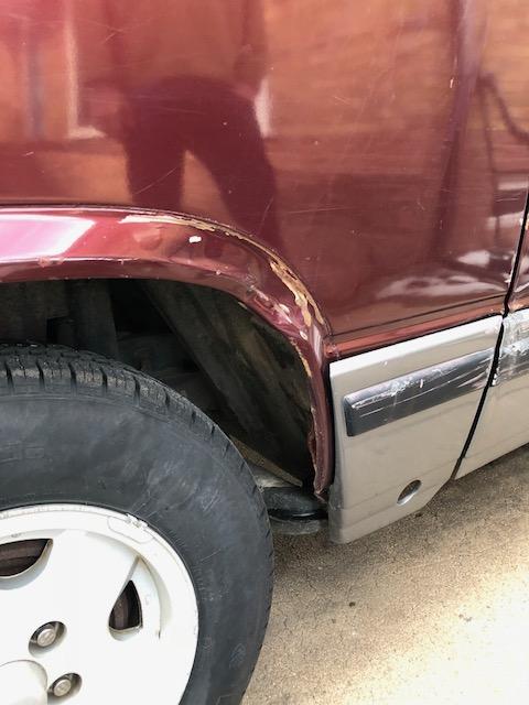

I just bought a nice 1991 tin top in Denver with the help of the good samba folks. It has some hail damage, is a little scruffy, and the roof is in bad shape paint wise but I think that a NAHT will cover that nicely. Very Happy And almost rust free.

I have a one way ticket from BWI to DEN on April 14, 2018. I plan to fly out, replace the fuel lines, fuel filter, oil change?, and drive it home to Maryland by Tuesday April 17.
Thanks to sambanite raoul mitgong for keeping the bus warm and cozy at his house until I can arrive. Very Happy
Total cost to date:
Purchased the bus $2900
