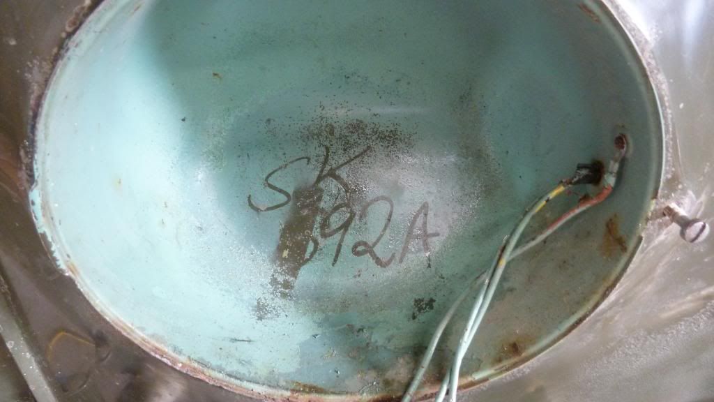

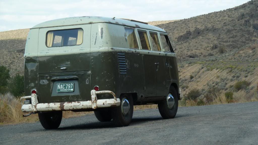

I thought I would start a thread for these buses with the paint code SK 692A.
I say special paint because they appear to be relatively uncommon, and possibly available for a short window of time. I am not 100% convinced that the paint codes used are the same as that of palm green/sand green as seen on 55 through 58 standard microbuses. I have a 58 standard with amazing original paint that I have done a few comparisons with. The upper color on the westfalia is considerably more green than that of sand green. 50 years can do a lot to paint though, so who knows.
The buses that I have found in my research have all been built within a 4~5 month period with the last bus being a couple months later than the earlier grouping, and a different camper model. All of the so-23's are of the same code designation A23 which is the most basic model offered, no icebox, no stove or toilet...odd?
I speculate that possibly westfalia and/or volkswagen wanted to offer a new color option to its customers for the new 61 model year. 6~7 months of production before the transition was made into so-34's and the more common 62 and later colors.

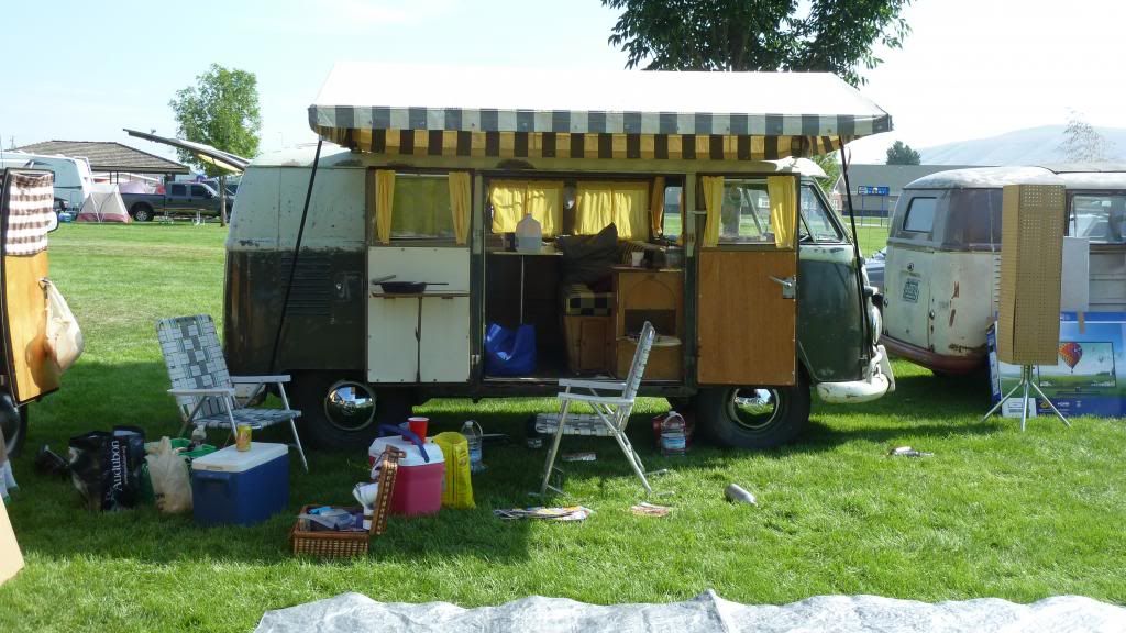

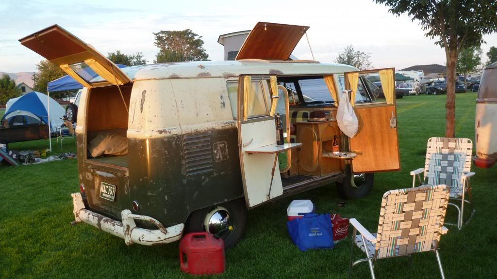

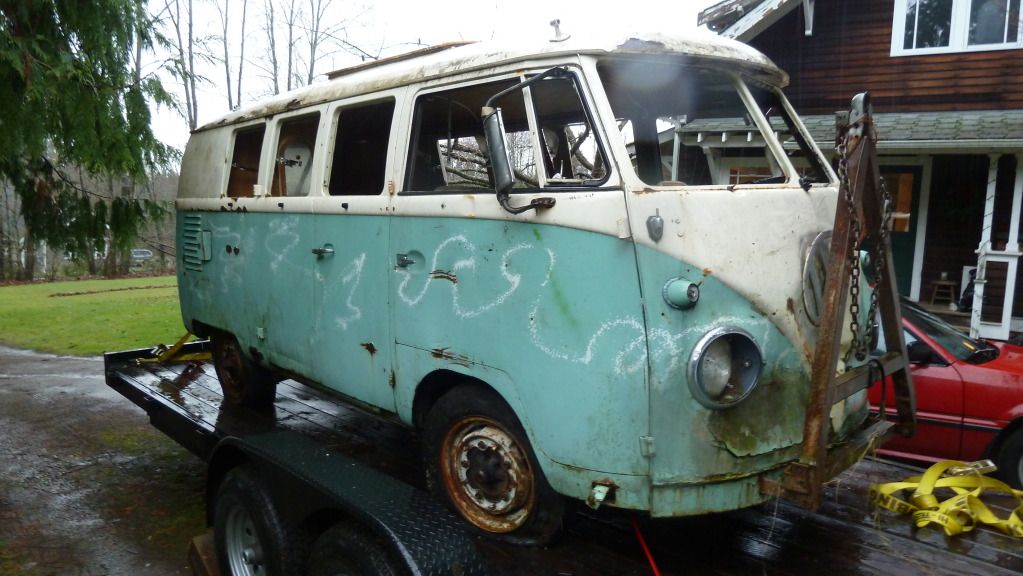

here is my bus initially, while no show stopper by any means, every bus has its potential. Unfortunately the bus was left outside here in the northwest for 8 years with no windows and only a shitty blue tarp thrown over it. The engine was removed and set on a pallet new to the bus with an equally poor tarp covering it. Some kids sprayed some white graffiti on it at one point as well.
I wont bore with tons of pictures of the little things Ive done along the way, but first I brought it inside and set some lights and fans inside the bus to keep it warm and air moving..hoping to dry out the completely saturated woodwork.

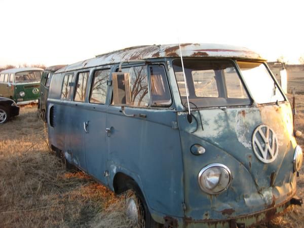

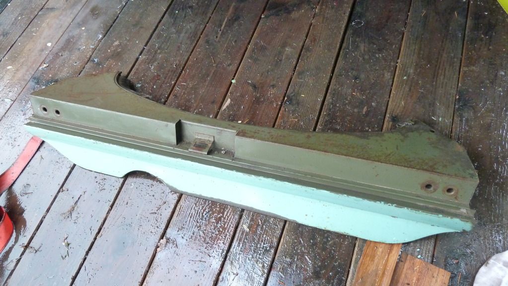

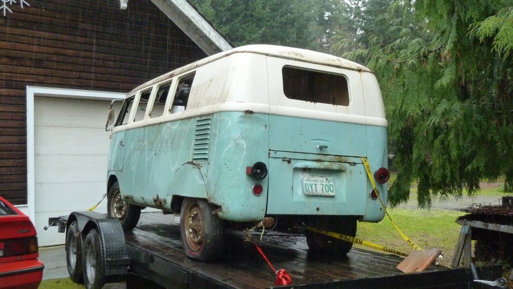

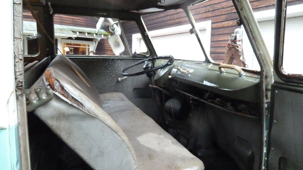

Like anyone, I was very curious what the paint was like underneath that hideous baby blue and white. Well there was a layer of Turkis/blue white that I am guessing was used to 'update' the bus or maybe the owners just didnt like that dark green paint. Either way, hundreds of hours later stripping/sanding/buffing I have an original paint SK692A so-23
the aforementioned 58 standard in the background
removed to the let the tar strips dry and clean/flatten

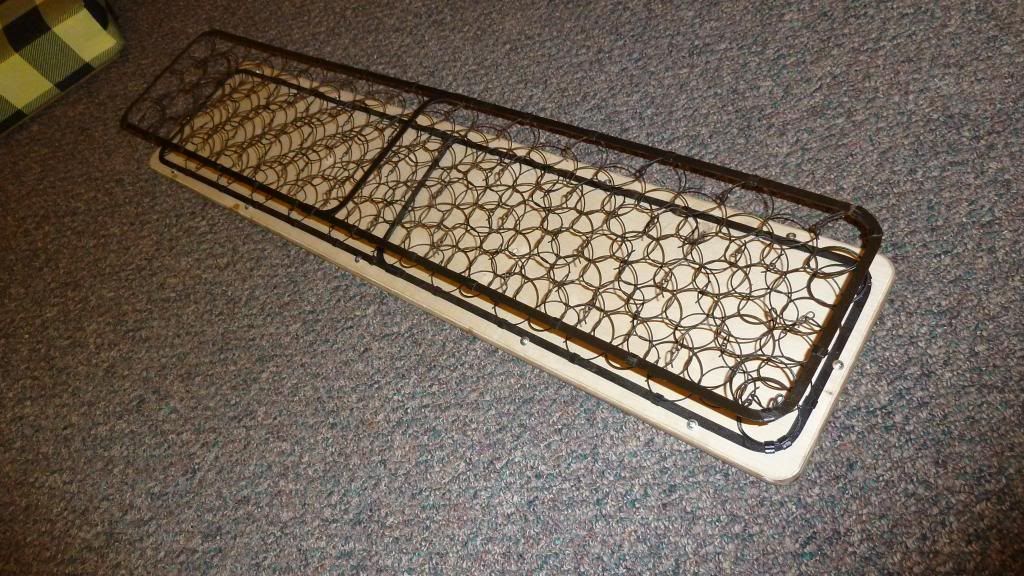

some cushions that I made using original springs (thanks mark) and fabric that is not perfect but is far cheaper than the material from europe, maybe some day I will pony up for that fabric. I also fabricated a rear backrest frame as mine was missing.

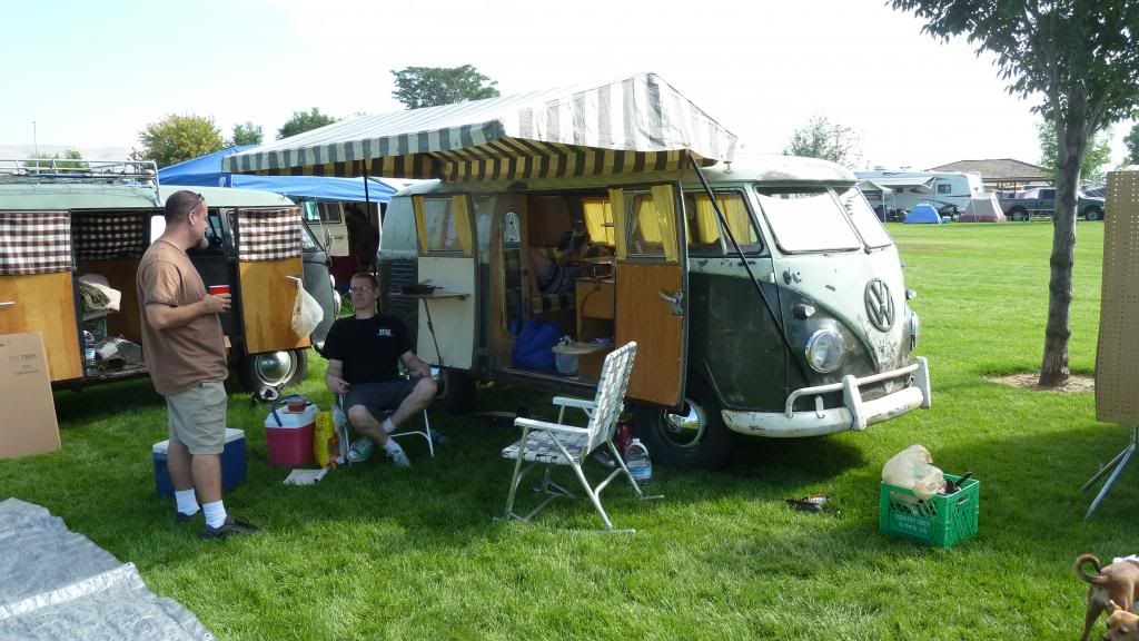

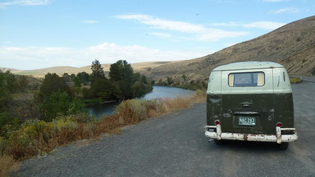

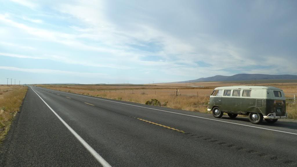

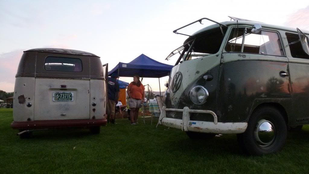

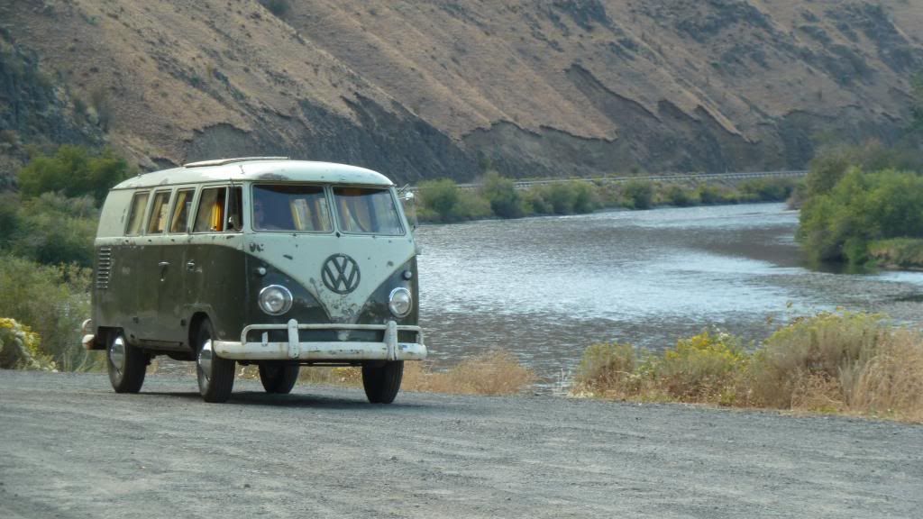

The bus just completed its first real test with a 550 mile trip to a show/campout. It passed with flying colors.
greg keeping an eye on his beautiful tent and previously NOS poles, set up on my bus this weekend.

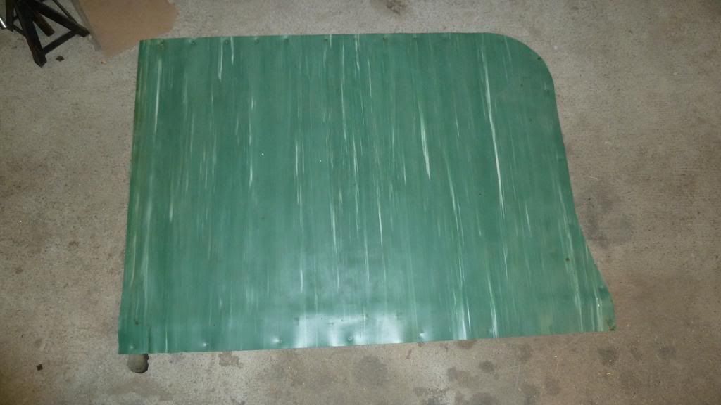

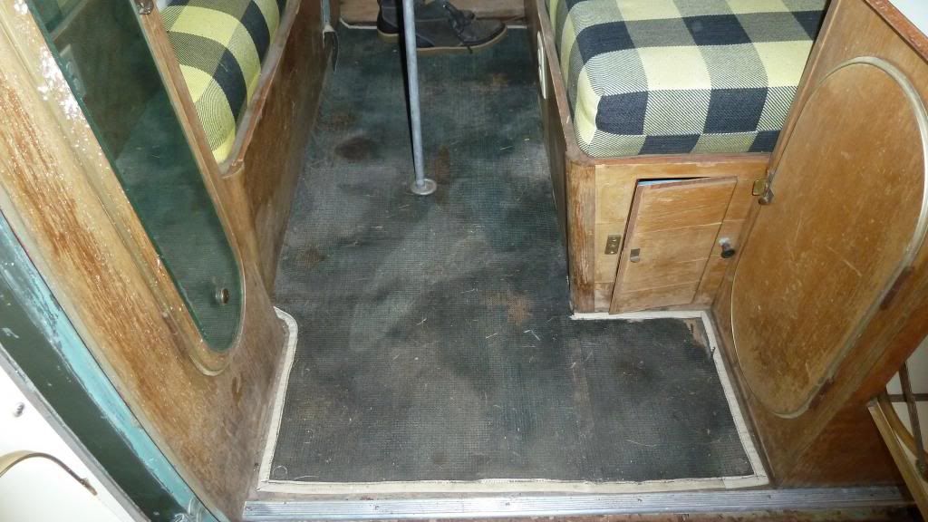

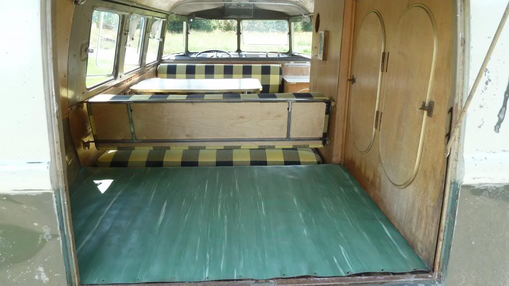

the original BLACK sisal mat which I believe to be a late so-23 transitional thing into flipseats where the mats are always black.

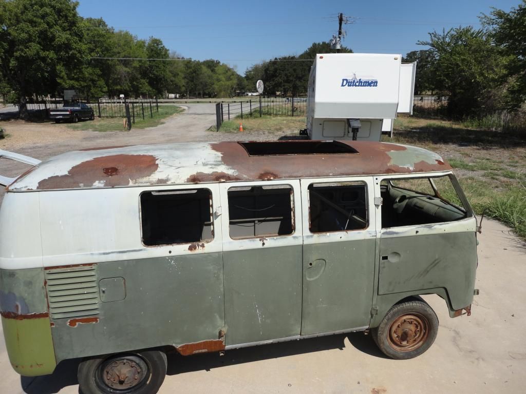

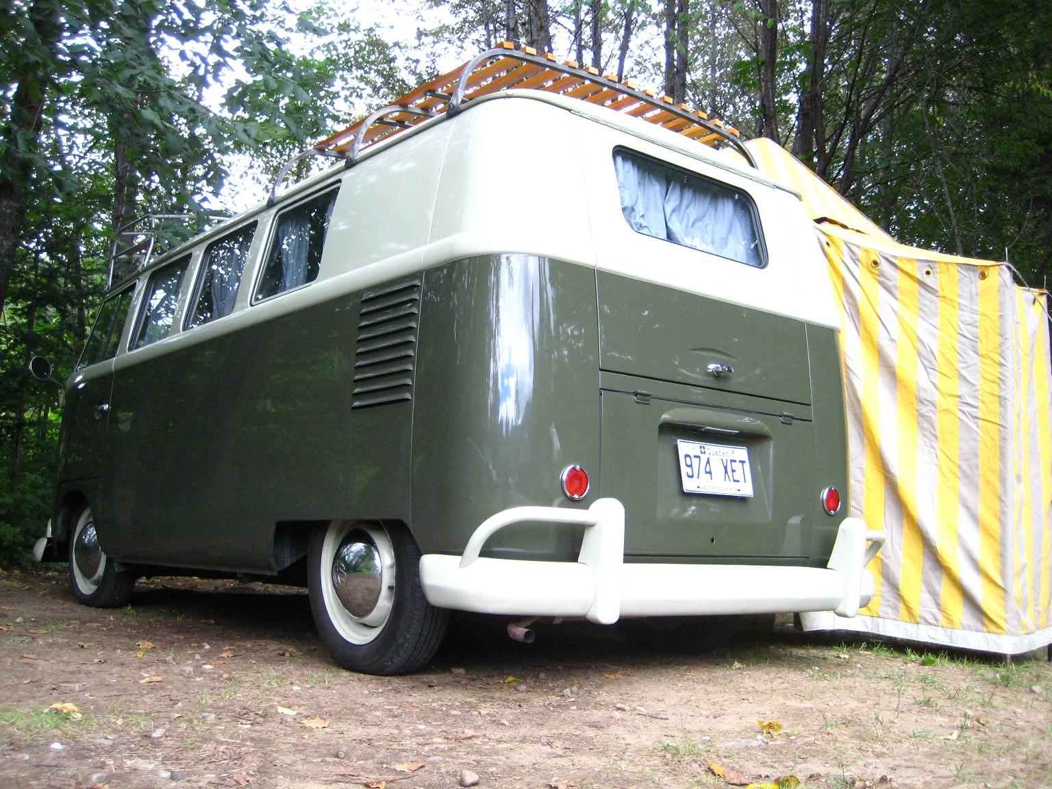

The oldest bus is owned by Grailoc up in canada. Built september 30th, three months before mine. The bus is currently beautifully restored inside and out. The upper color is seagull grey because at the time of restoration he did not know the paint code or have a sample to match.
as found
currently

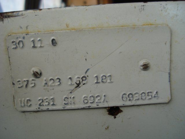

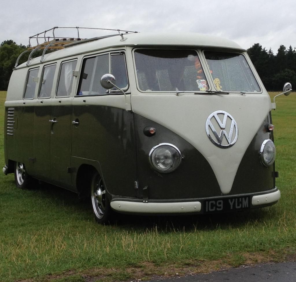

The next oldest bus is in the UK. (and for sale currently!)

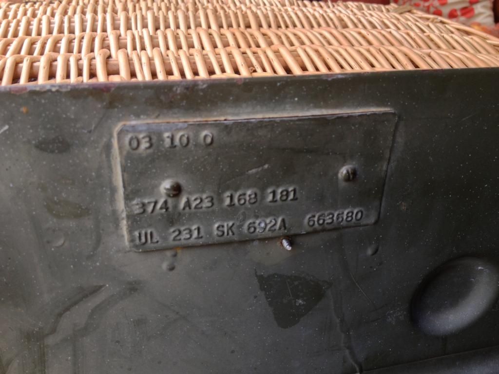

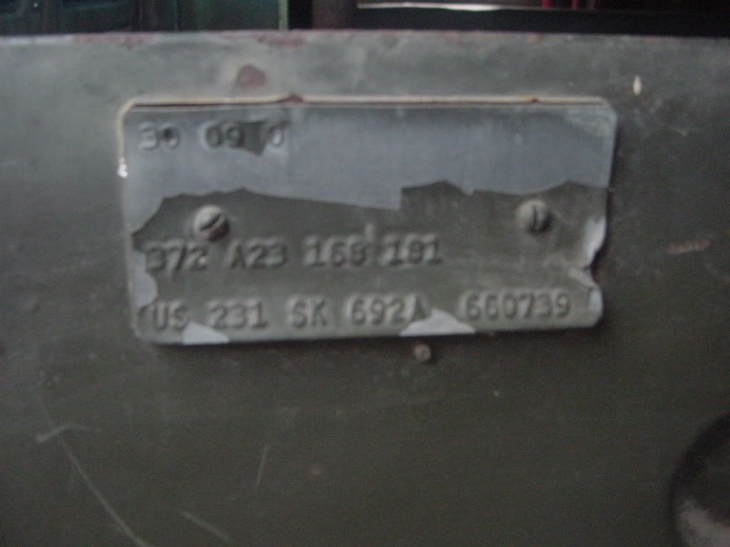

built very early october
m-codes 374 A23 168 181
destination UL (st loius)
was partially original paint, now has all rust fixed and is mostly blended paint. Has a very nice reproduction interior kit from the Netherlands installed.
the pressed bumper is not correct but the owner preferred it.

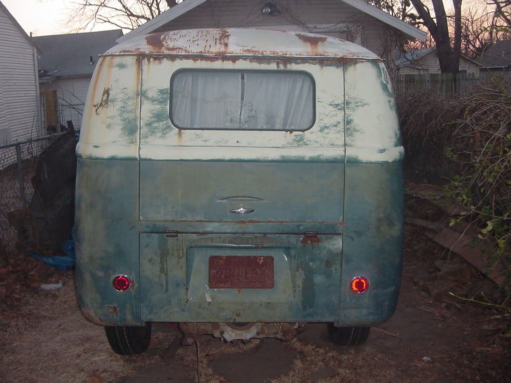

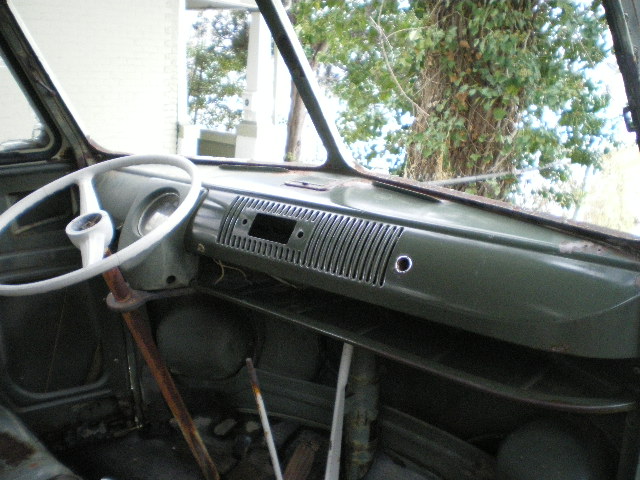

The next bus is located in the midwest and is a stripped shell painted completely white. This bus is identical to mine other than being built 30 days earlier. Same codes and destination. Maybe a customer saw this bus and wanted one for themselves, ordering mine?
There is another so-23 located in virginia that is rumored to be nice original paint, but is awaiting full restoration as that is what the owner prefers. I am hoping he sees this thread and contributes with some photos and information.

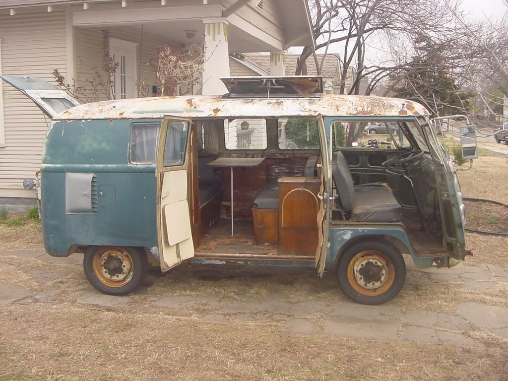

The last bus is actually a so-34, built very early april. Possibly one of the earlier so-34s? Located in utah undergoing complete restoration
Vin 775,XXX
as found

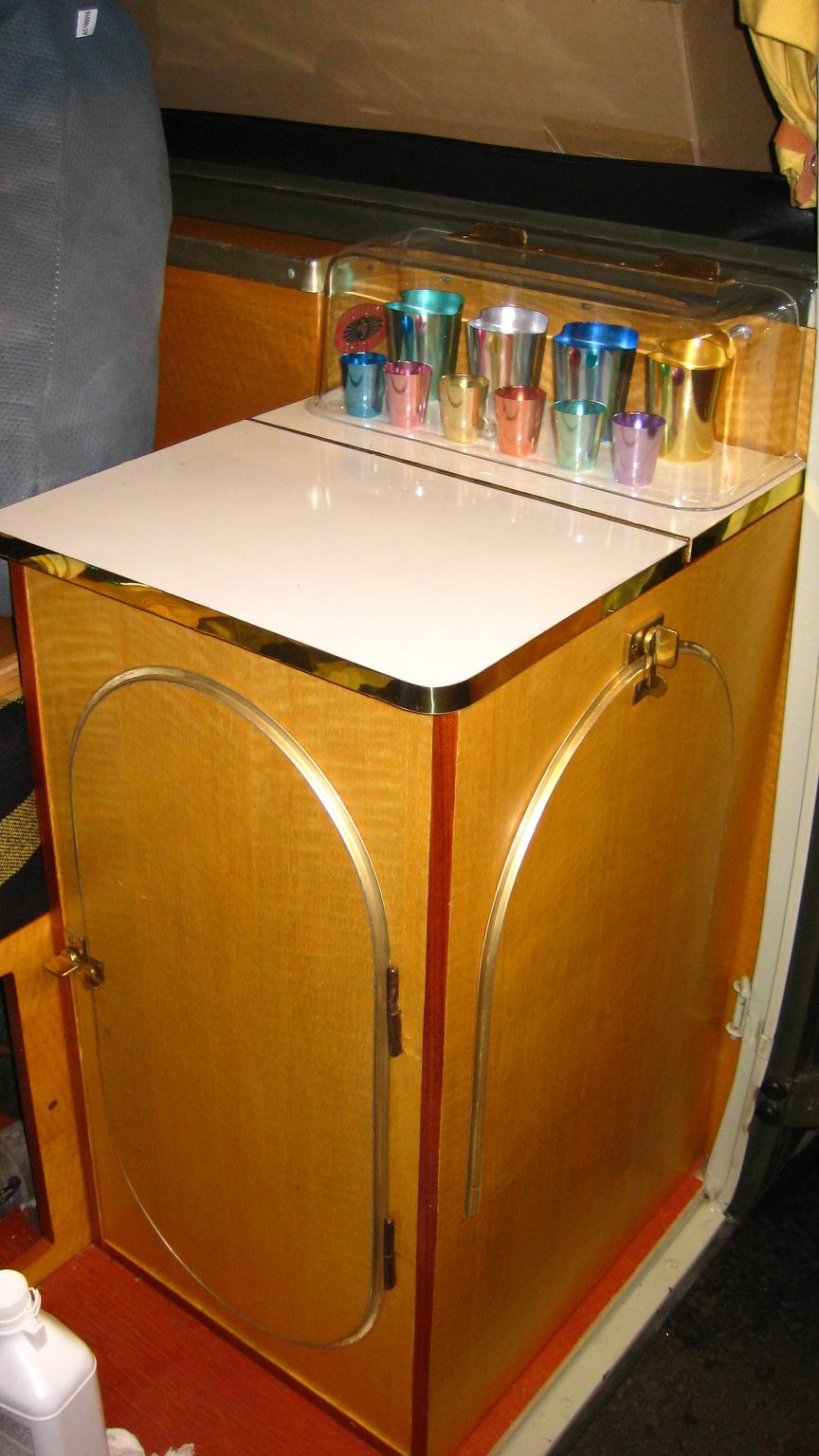

the cushions were fun. The material I found is quite heavy like original but I could only find white/black so I dyed them yellow. I used upholstery cotton as foam gives them a bizarre puffy look, not like the original horse hair pads.

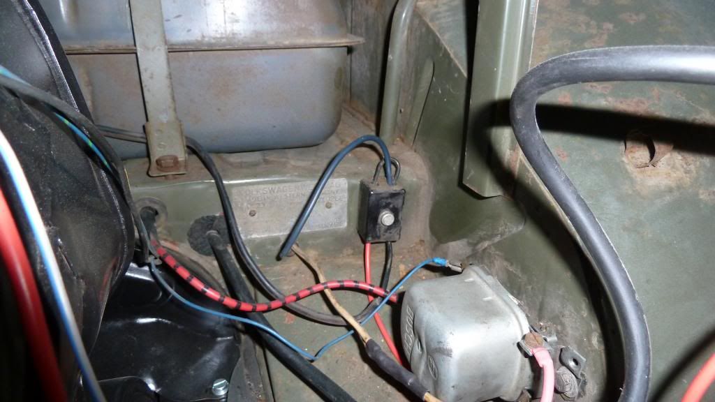

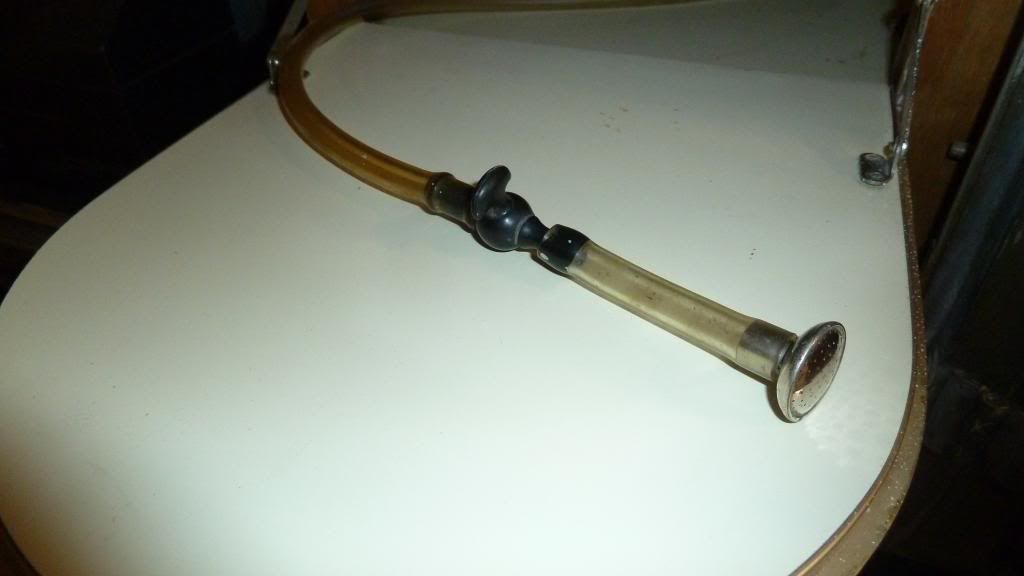

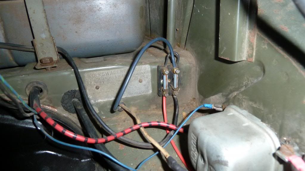

original wiring for the clamshell lights and the water pump. The original water tank filler neck is in place but dry cracked beyond use. The water pump works but is still 6v and I had to unhook the switch as its wiring is melted so it constantly spins.

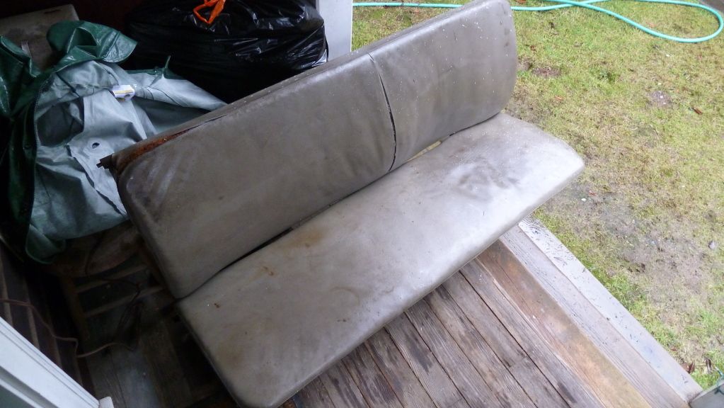

the front humpback seat was in very nice condition other than all the seams being blown out. I restitched them through the original thread holes...dont do this unless you have way too much time on your hands!!!

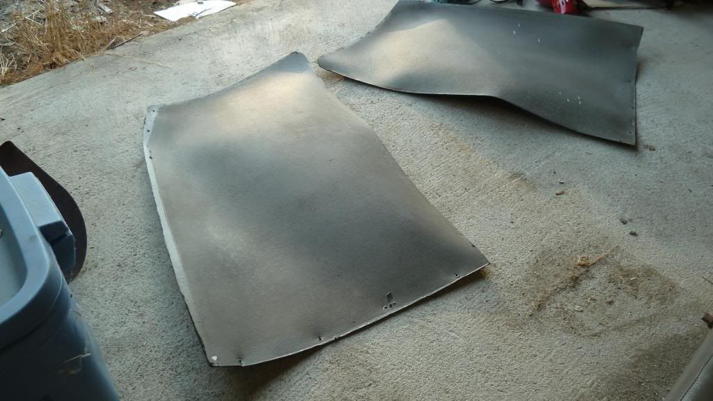

removed the headliner cards, soaked them, set heavy items on them, and let them dry to flatten them.
