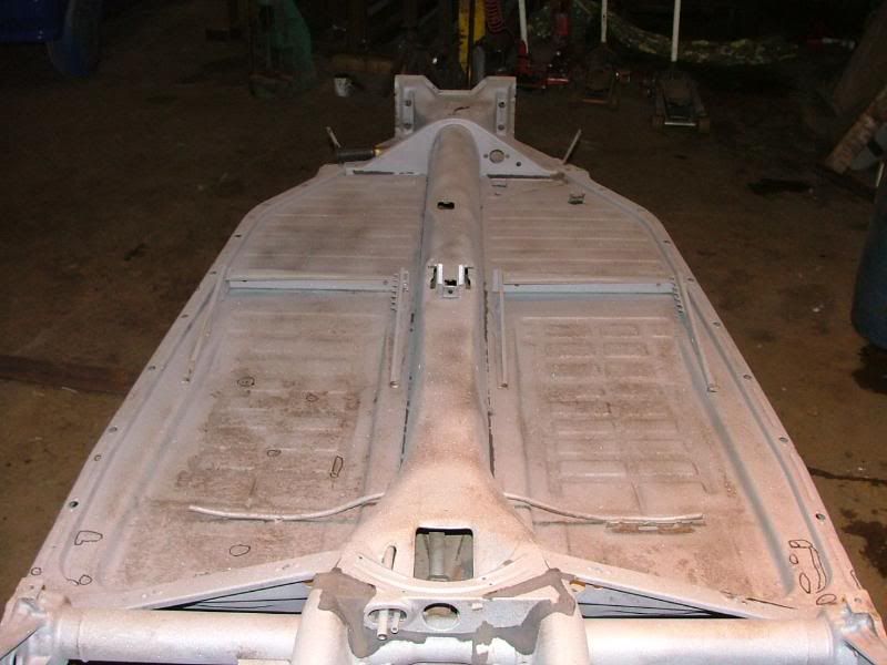

Bought this on eBay for £25.00 its a 1970 Beetle Cabriolette Floor pan on an A-Plate originally LHD but you would never tell as it is now a RHD.
Brought it home stripped it shot blasted it, welded all the holes up & had it Hot galvanised. Now I have a 25 year guarantee on it even if I don't paint it. I have painted it so it will last forever. I haven't decided if it is going on my 1971 Baja or my 1965 Herbie project.
As it was when I bought it
Back from the Benetts after shot blasting. Peugeots have their uses!
Almost ready for Galvanizing. Black circles are where welding is needed
Nice & shiny from Cardiff Galv
Etch priming
Almost ready
Just needs putting back together now

A few questions about the galvanization.
Did you plug the fuel lines or plug the threaded areas like for the tranny mount and excet ?
If you did not have you had to run a tap through the threaded areas?
If I remember correctly some of the later VW hard fuel lines were an aluminum steel or stainless steel alloy. I was under the impression that galvanizing these metal alloys reacted badly and would cause them to corrode. Or perhaps I have had a stroke….
74 super beetle AKA The Pirate.
We are currently offering a rebuild service for Beetle rack and pinion steering units. PM for details.
Service with a Yahhrrr.

Very Happy Hi all, when galvanizing, you must make sure that all of the rubber, underseal, paint & rust is removed otherwise the Zinc won't stick, all of the threads had to be re-tapped, this is easy because the metal is soft. some of the pipes in the chasis were blocked at the end so I just put a blow lamp on them & rodded them with some stiff wire. you cann't galvanize any part that has a sealed end otherwise the galv will explode inside the void & spit the part, luckily the VW floorpan has no sealed areas.

For some reason I was thinking that paint would not stick to galvanized metal.

If you put paint straight on it wont, if you wipe it over with thinners to get the salt off & then etch primer it it will take any paint after that. Very Happy

Chris, I was reading up on galvanizing last night, and it seems that the method they use to hang it is important to venting and draining. Do you know how they hung yours? Did they hang it from one side of the floor pan, or did they hang it from the frame horns?
Did they have to drill extra venting/drain holes?

They put it in flat then spun it around & let the excess run out. No drilling or venting was needed. Very Happy

is not nice looking doesn't really lay down smooth it doesn't really work for parts that move wont flex and looks like crap if you try to paint over it.
Chris, what do you think of the look after painting?

In the UK there are loads of Galvanising factories, the tanks are normal very big to take large gates & railings. Very Happy

If I done it again I would leave it unpainted or get it powder coated. Very Happy

I found 5 that are within about 20 miles of me, and It looks like this one has the biggest tank,, but I'm not planing to do A hole pan like you so I dont need them to have A huge tank Smile
Single-dip dimensions of 22' (length) x 5.6' (width) x 6.6' (depth).
We are capable of galvanizing material up to 38’ in length or up to 12’ in height. (Double-Dip method)
Unless the VW pan is under 5 1/2 feet wide??
I seen pics of there work, Shocked thy do A lot of out door decorative stuff. and say It has A life of 50+ years

White vinegar works well to prepare the freshly galvanized surface for paint adhesion.

Ive been told that as well. Unfortunately I've never been able to make it a reality through several attempts. I think I'd stick with the method Chris detailed in this thread.
