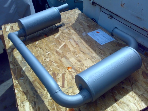

I built this, on to a A1 sidewinder.
Nice layout, you should produce it !

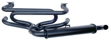

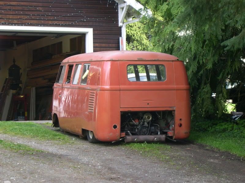

I'm running a 1679 in my kombi, and would like to be able to mount my rear bumper and hursts- but the muffler I have
wont allow it (unless I cut/bend and reweld it) -which will then create dragging issues from my drive to street (drive is uphill a bit)..would I be better off running this?
http://www2.cip1.com/PhotoGallery.asp?ProductCode=VWC%2D211%2D251%2D051%2DE
here is what i have now- the pressed bumper brackets can't be mounted (nor the hurst brackets).

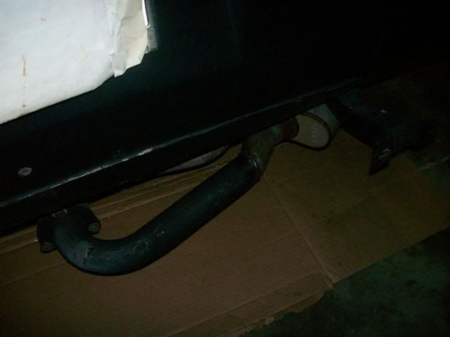

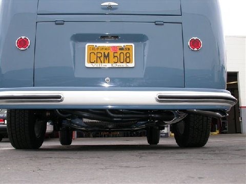

Here is the one I just put together for my westy:

I was going to try one of those FatBoy exhaust (similar to what you have) but the engine and trans was raised in the bus so I was thinking that it would probably hit the bumper. The 3 bolt flange drags the ground when I come in and out of my driveway.

PostPosted: Sun May 25, 2008 6:09 pm    Post subject: Reply with quote
There is a way of cutting the pipes and flipping the flange over and giving your self more clearance. I had this done on my really low kombi.
It is a little hard:

Whoa... You can barely see that exhaust. Got any more pictures?

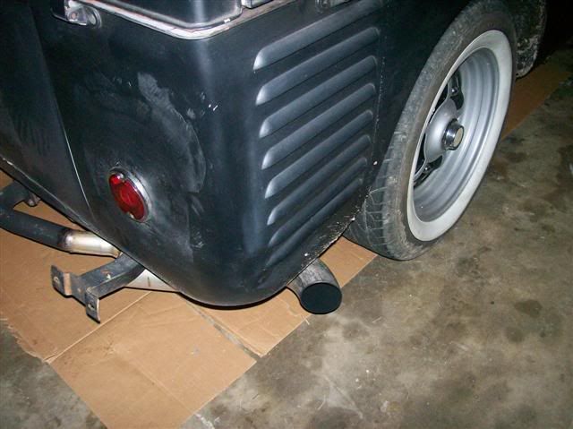

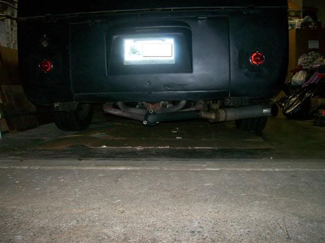

here is my ghetto setup but it works and cost me $33, pipe was $13, muffler was $20. i need to space my bumper a it or dent the bottom side so it clears, oh well.

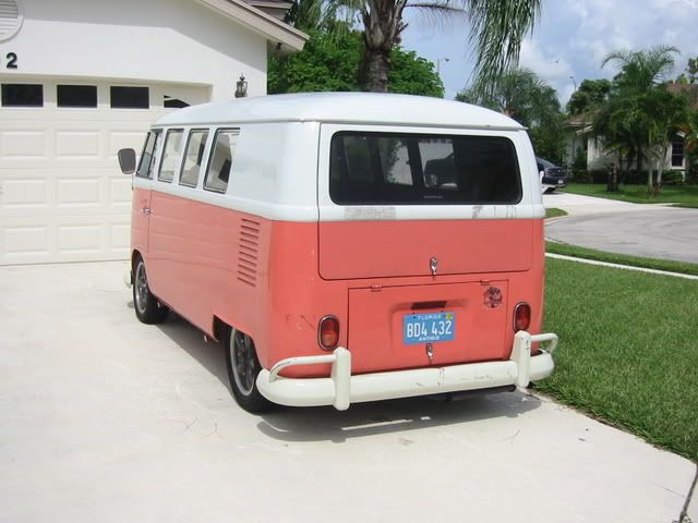

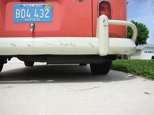

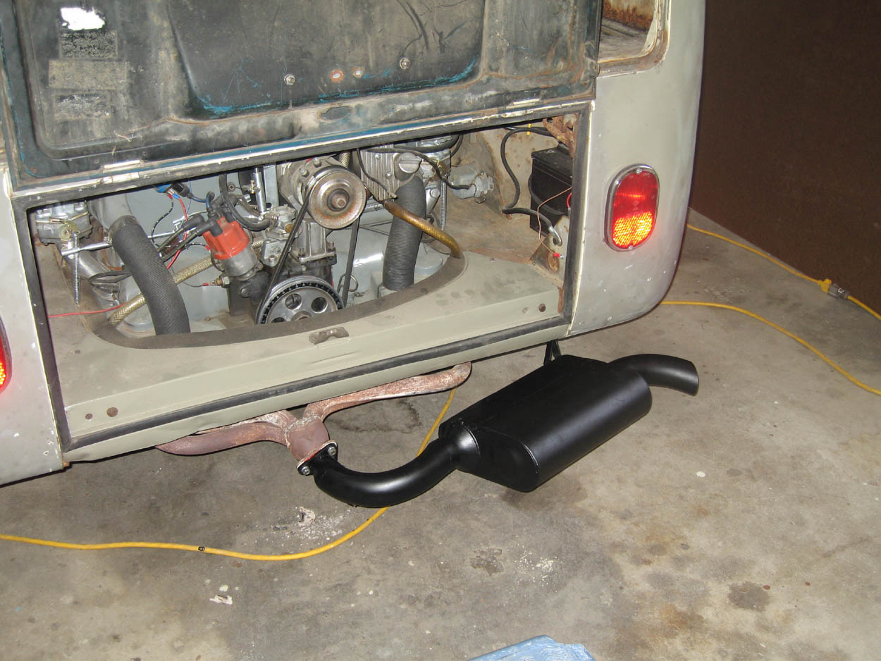

I did this:
Bought the replacement muffler ONLY from this:
http://cbperformance.com/catalog.asp?ProductID=389
Then already had old rusty version of this:
http://cbperformance.com/catalog.asp?ProductID=1288
Notice the merging of the pipes are much tighter, so the flange is tucked under the apron.
Took both to muffler shop, cut off muffler and added a 3 bolt flange so here is the result:

PostPosted: Tue Sep 23, 2008 9:20 pm    Post subject: Reply with quote
this is just for stock motors, or SUPER mild motors...and only if youre EXTREMELY low. everything hides up and behind the apron and bumper. Cant see the tips even when laying on the ground from the rear.

PostPosted: Tue Sep 23, 2008 11:18 pm    Post subject: Reply with quote
Got another picture of that? It looks pretty cool.
