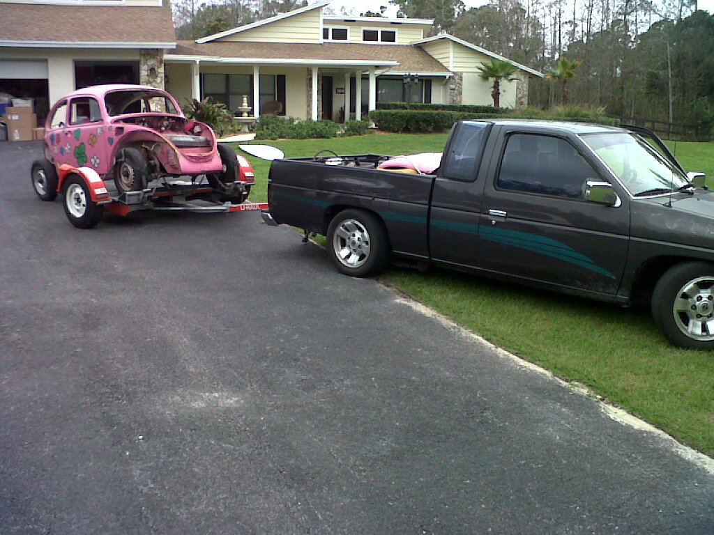

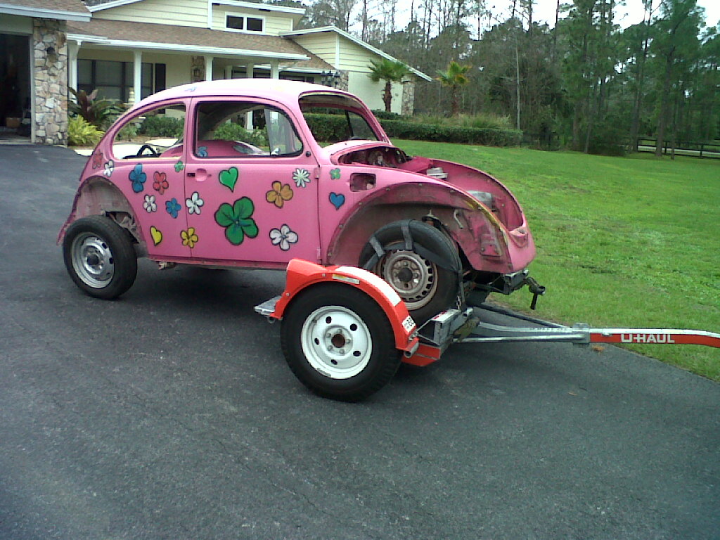

Picked up this little beauty after finding it in a U Pull and Pay junkyard on blocks last weekend. It had been in the yard for about 15 minutes before I stumbled across it, I offered to buy the whole car on the spot. So it really is a rescue.
Its a 2001 mexi- beetle titled in FL, It was all there except the radio, no rust, solid pans, small dent in the rear passenger fender, and a mangled front bumper. It was allegedly driven into the yard under it's own power. The story was that someone traded it in at a local Kia dealer who kept it on their lot briefly then sold it to the junkyard. I had it towed home yesterday.
In the 15 minutes before I saw the car someone had taken all of the relays out of it, I bought a new ECU relay for it today, I had a spare fuel pump relay and plugged it in but still wasn't getting any power to the fuel pump. Jumped the relay and it fired right up and drove it around the yard.
Does anyone know what other relays this thing came with and may still be missing? Or a pic of then relay panel with the relay numbers?

PostPosted: Tue Mar 13, 2012 6:05 pm    Post subject: Reply with quote
Where did the hood go?
1973 Super Beetle
2003 New Beetle
Post your Super here: http://www.thesamba.com/vw/forum/viewtopic.php?t=331999
Beetle Bums VW Club Member
