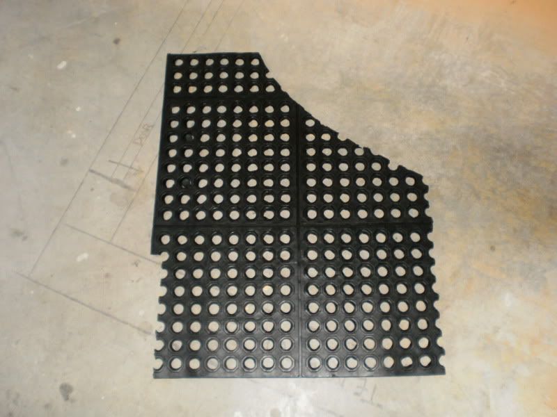

Reposted from my local VW forum, 'cause I'm mighty proud of these:

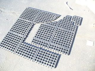

I'm fairly broke, and I have bare metal floors. I've been thinking about making 'duck boards', but that would require tools and money that I don't have right now. At Lowe's they have this rubber floor covering for the garage... about $20 bucks for a 4x4 sheet. I've been eyeballin' this stuff for a while. I made a cardboard template by cutting, and fitting.

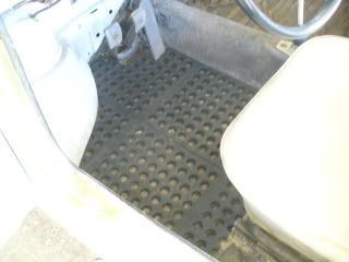

Once the cardboard fit good, I laid it on the floor mat, and cut around the edges. I used the flat, smooth edge of the mat to go against the tunnel. I measured and cut out the part for the pedals. I just used a box cutter to cut the mat. I'm surprised I didn't cut myself. I'm good like that.
The passenger side mat ended up being the same shape, but an inch narrower due to the wiring harness and it's cover running down the tunnel. My tunnel has carpet on it, too, which may have taken up a little room.
Awesome fit.
I like this rubber because it has nipples on the bottom (and nipples are my second favorite thing in the world Smile ). Water will not get trapped under this floor mat.

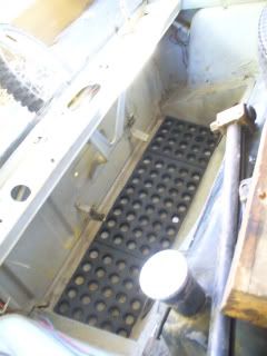

With the extra pieces, I made a liner for the bottom of the nose, where my jack and tools ride. I also made one for the shelf behind the back seats, but I didn't get a pic of that.
So, I have $40 invested in these mats, but they are custom fit, and I like them a lot. They are cheaper and fit better than some other alternatives.
On the test drive, they are absolutely solid and have no movement at all. They don't index with the floor mat 'tits' that VW put on the floor, but they are trapped between the tunnel, the seat and the edge of the pan. I think they look very industrial, too, much like the rest of the car. Me likes. I love the thought of all the nipples and tits under my toes.
The only think I would do different is to continue a strip down the side of the seat from the mat... I had material there that could have run all the way back to my roll bar, if I had thought about it. Oh well, next time.
Anyway, if you need custom, all weather floor mats on the cheep... These are not half bad.

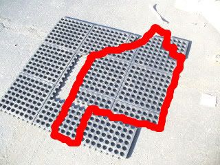

PostPosted: Tue Nov 25, 2008 5:22 pm    Post subject: Reply with quote
When you cut your front mats, cut them like this, so you cover the area to the side of the seat:

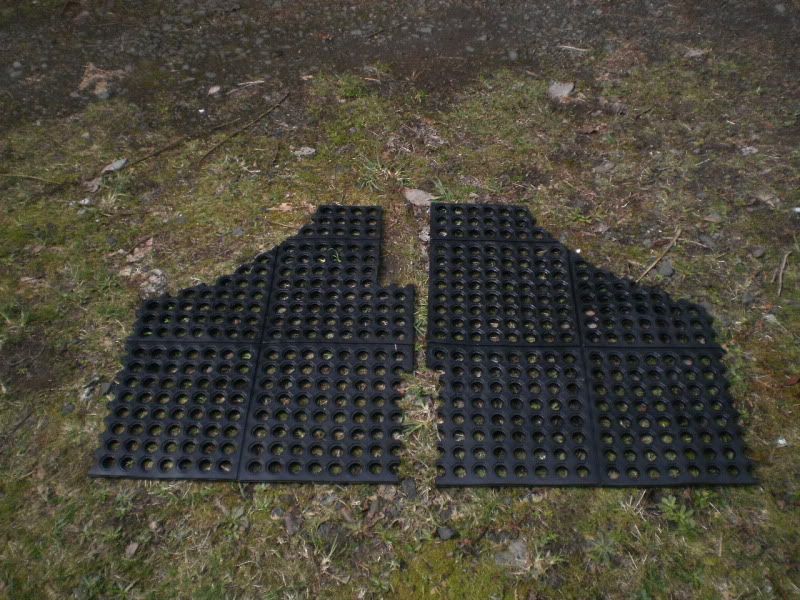

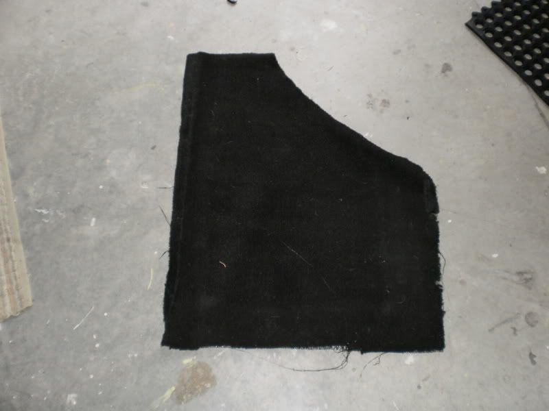

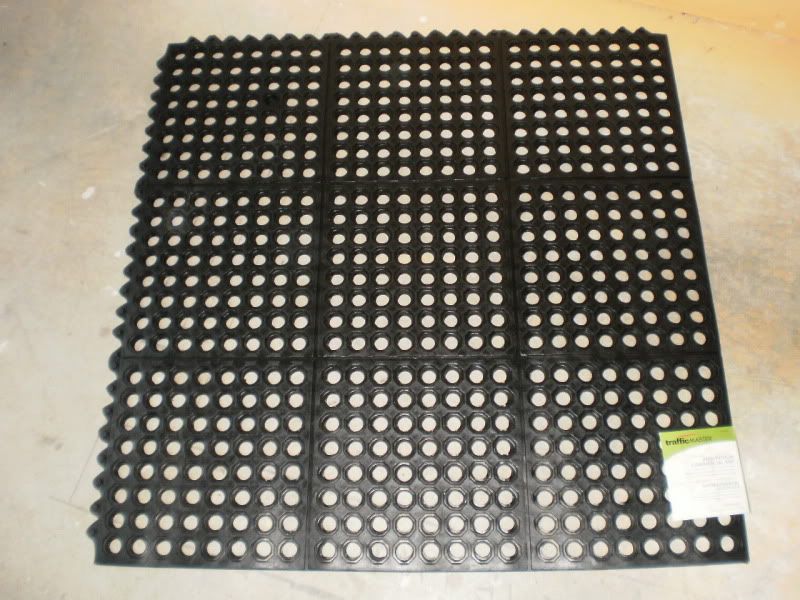

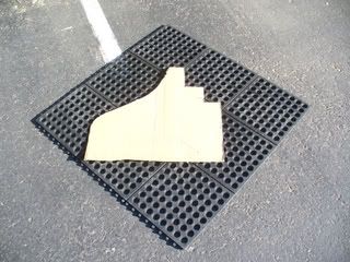

Didn't want to start a new thread on this so I resurrected this one. I found the mats at my local Home Depot. On sale for $17.98 each no less. They are called anti-fatigue mats. I bought two in order to do the fronts.
Used the carpet the PO installed as a template. Believe it or not there was aluminum trim SCREWED Evil or Very Mad down to the floor completely around the perimeter of the carpet leaving dozens of little screw holes. Sealed them up with silicon until I can weld them up later.
Here's the 3x3 mat I found at Home Depot. Looks identical to what EODinert used.
Using a utility knife with a brand new blade. Cut like "budda"
Passenger side
Both sides
Installed
Very happy with end result. Now I need to do the rears. I think I have enough scrap from the first set to make a mat for the front well and glovebox.
