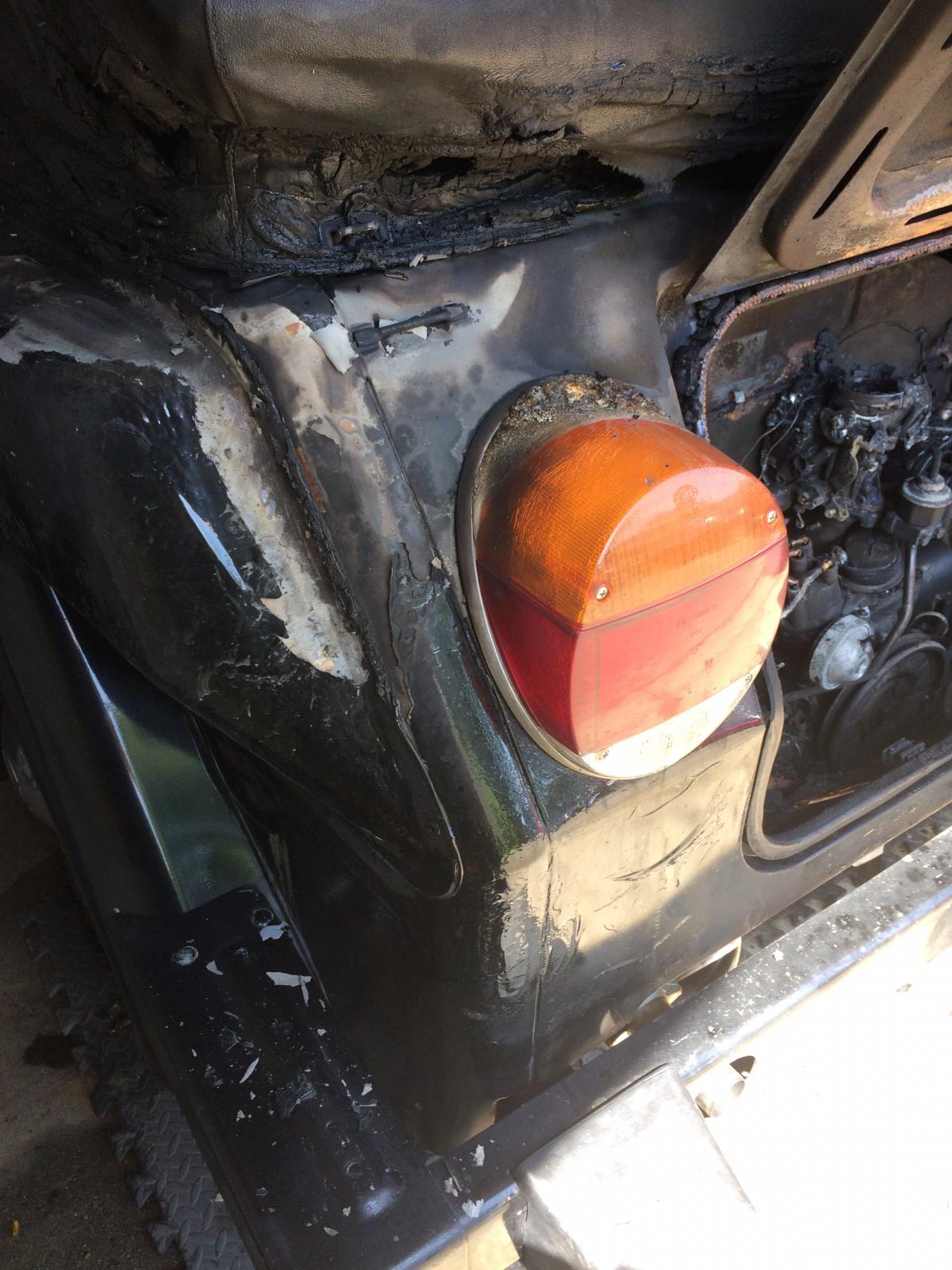

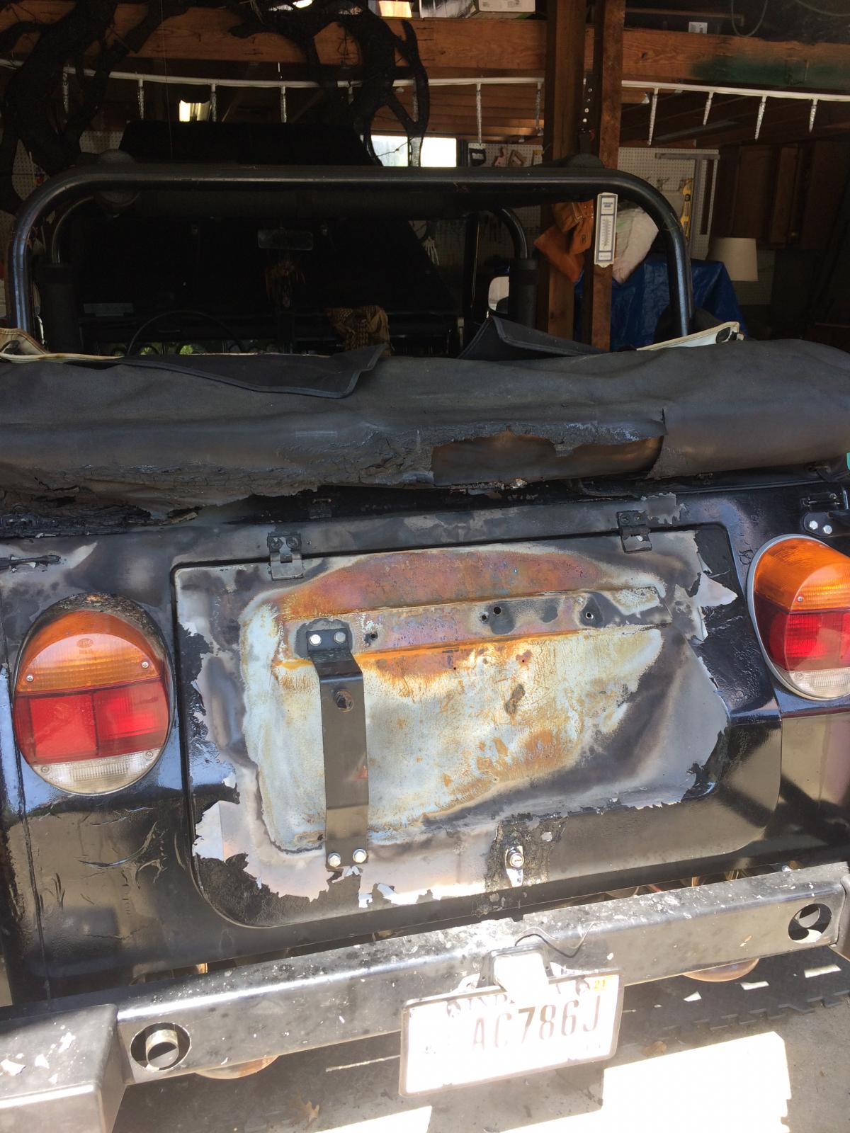

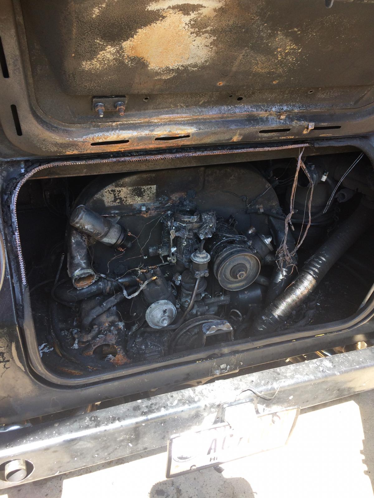

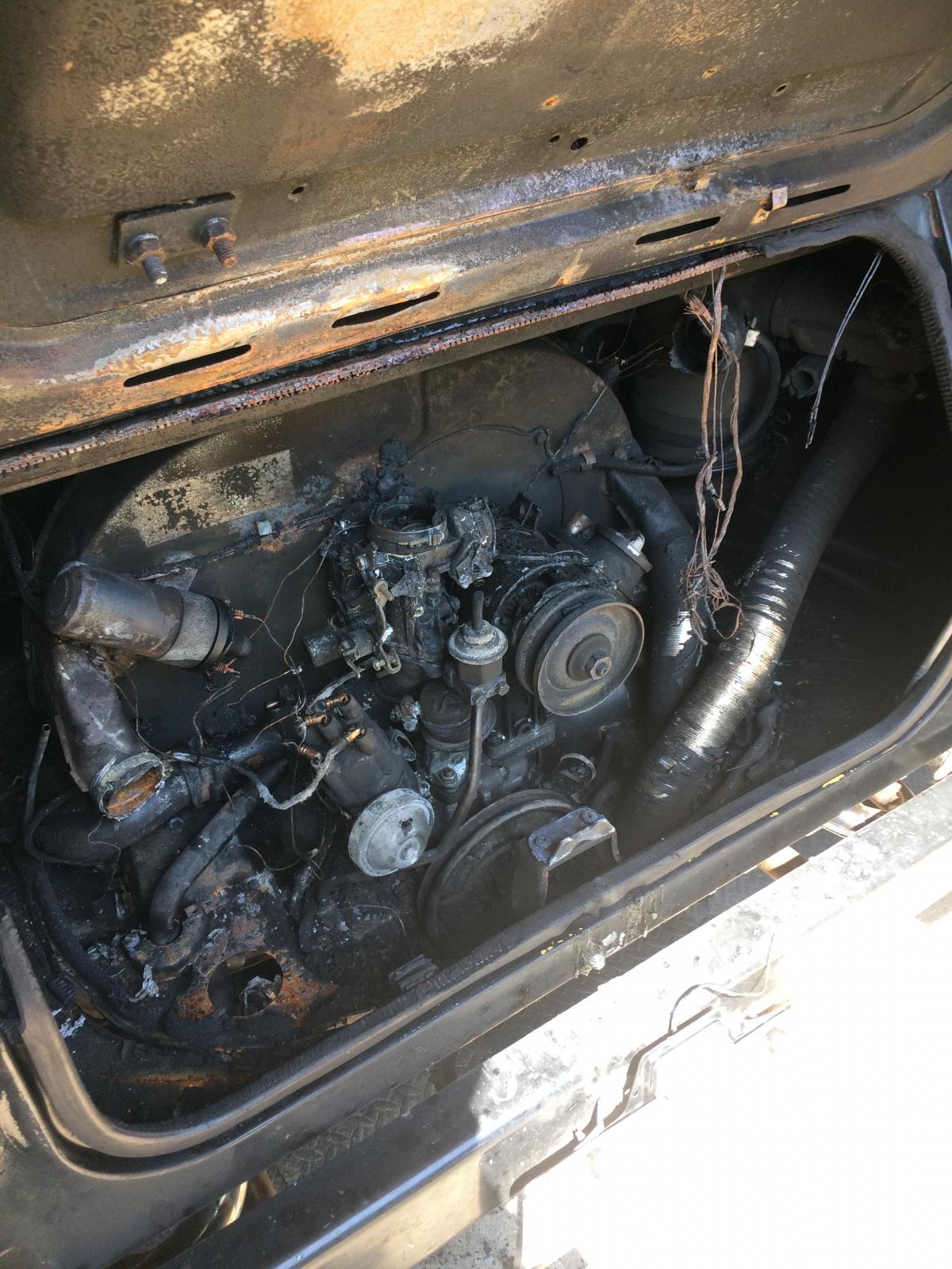

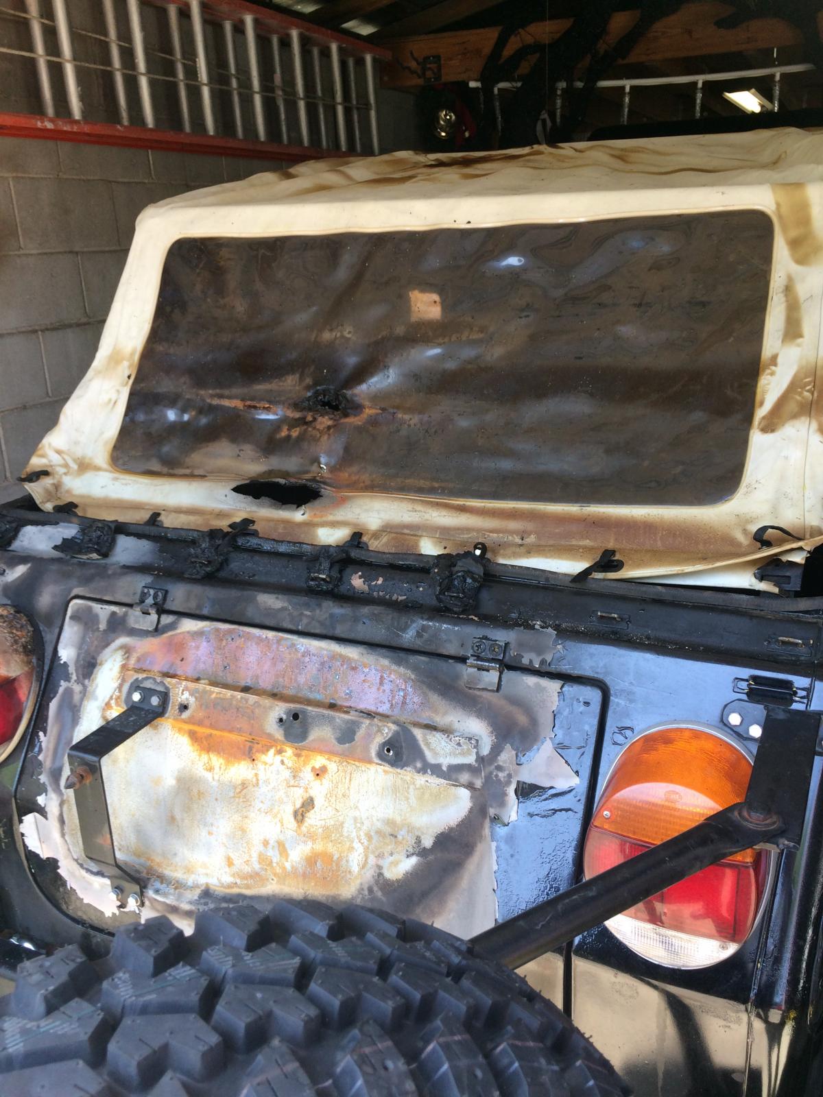

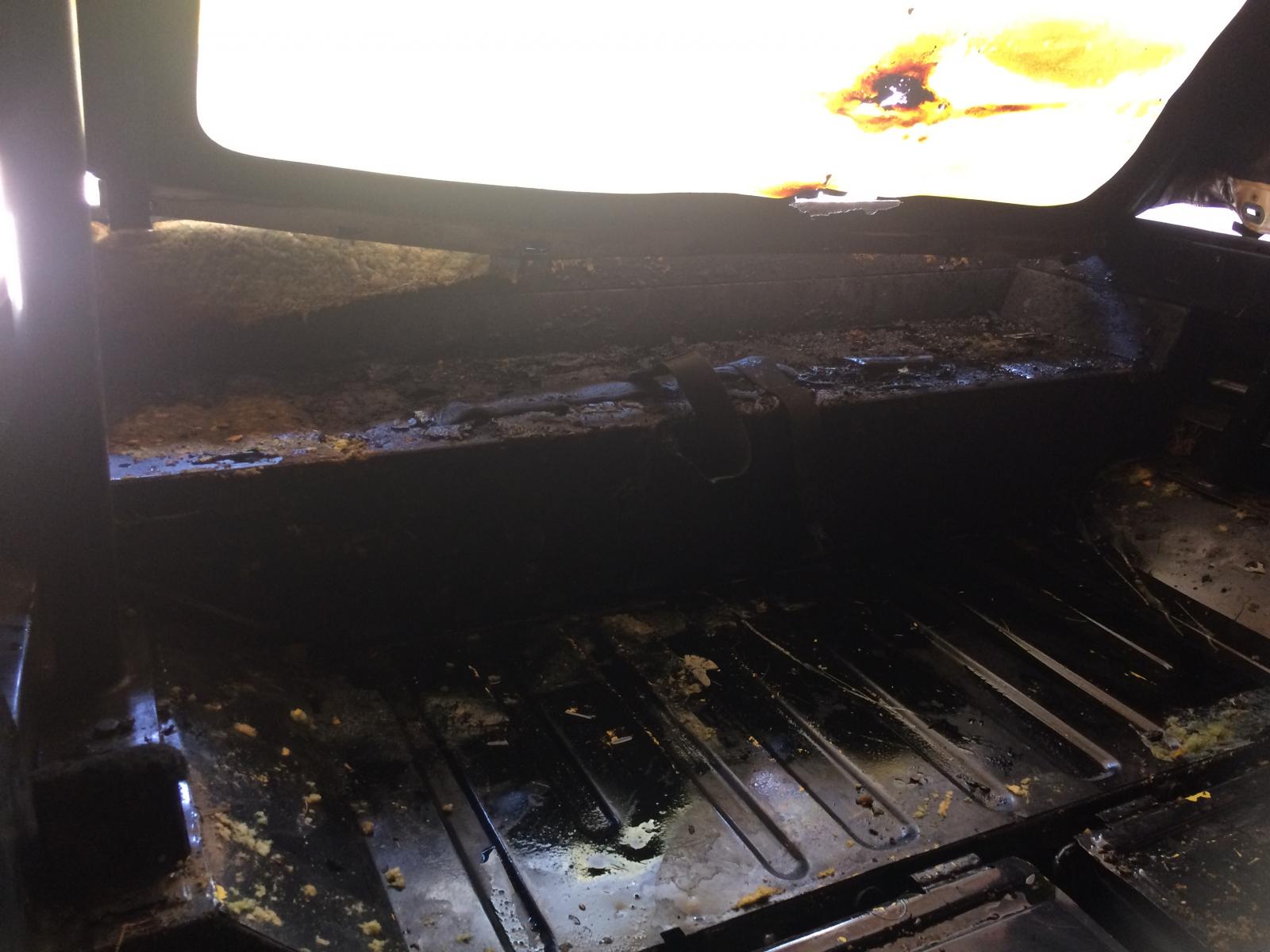

Had a bit of an engine fire last week. Broke just about every rule except I had moved the fuel filter out of the engine bay several months ago.
End of the day and I was moving the car from in front of my house, around the block and into the garage. Made the first left turn about 100 ft and then the engine began sputtering. Conducted a moving restart and the engine came back,... for a about 50 feet. I saw a bit of black smoke coming from the back of the car in my rear view mirror. Pulled over to the curb and jumped out to check on things. When I opened the deck lid there was a small fire near the carburetor. Dropped the lid and went back up front to grab the extinguisher only to discover it was no longer charged. Called 911 and reported the fire. Response was pretty quick, like 10 minutes or less.
Here are the results. No injuries (at least physically). Insurance adjuster (Hagarty) scheduled to assess tomorrow. Top was down and booted so it burnt up.
Maybe I'm being a bit optimistic but I hope to restore. Blazecut system will be installed along with at least 2 portables.

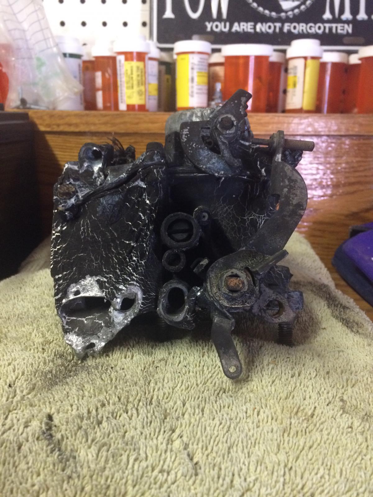

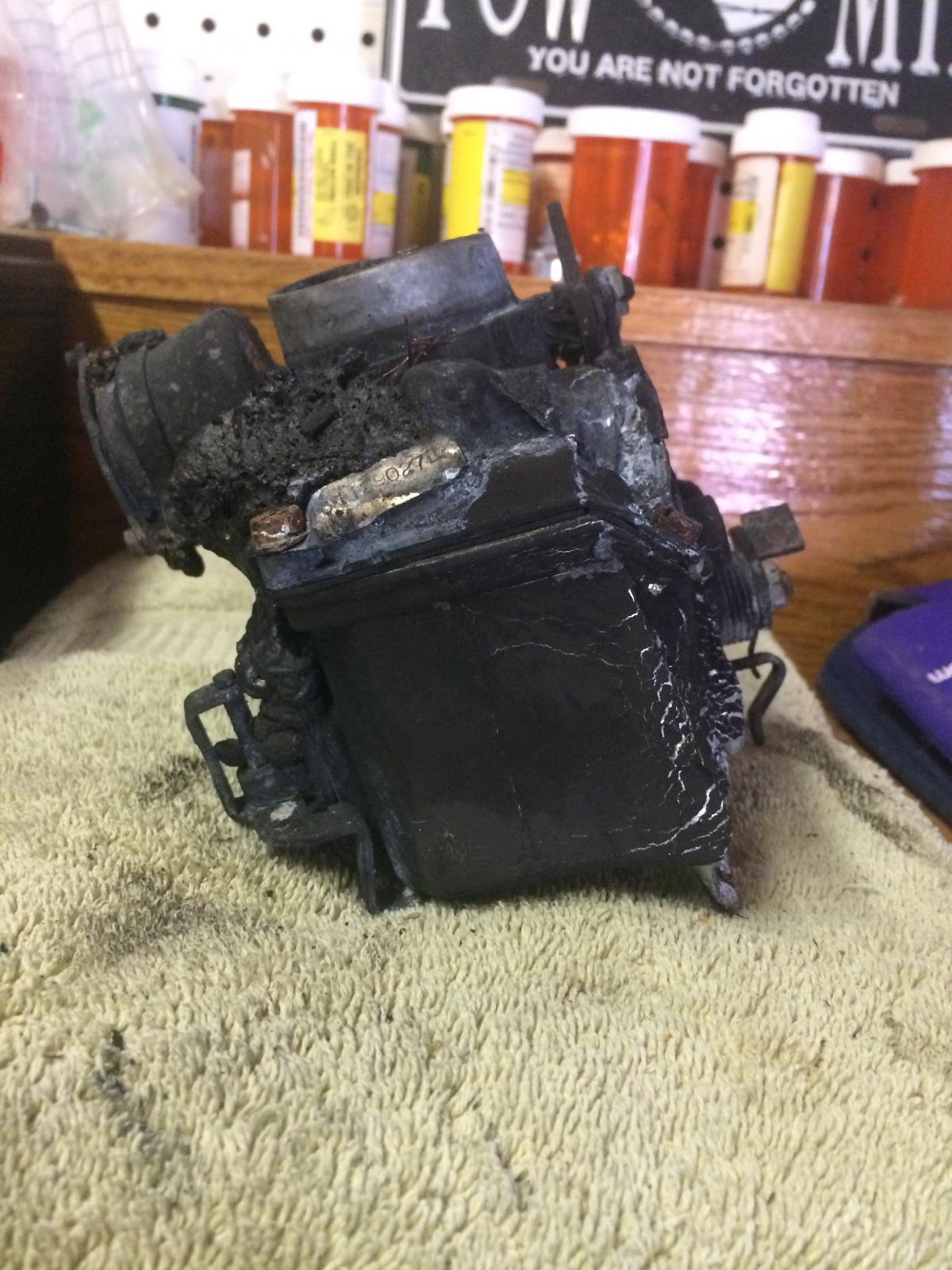

Joe 20 wrote:
Any idea what did cause the fire? Crying or Very sad

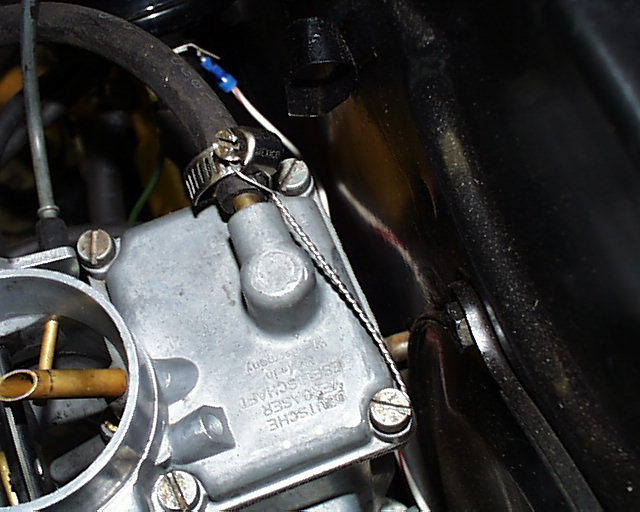

Found the carburetor brass inlet tube sitting beween the air shroud and intake manifold. At this point I assume it separated from the carb, spill some gas, and then caught fire. Suspect ignition source came from electrical contact with cutoff valve or electric choke. Engine hadn't had time to get warm.
The inlet pipe is just peened into the carb. There's a couple of options to prevent the pipe from popping out. 1 is to machine a threaded connection. The other is to safety wire the clame to the carb.
From the gallery

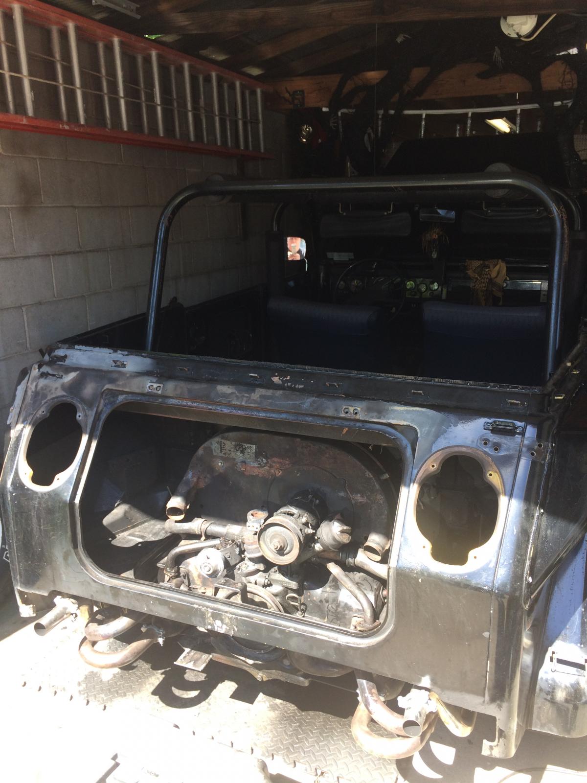

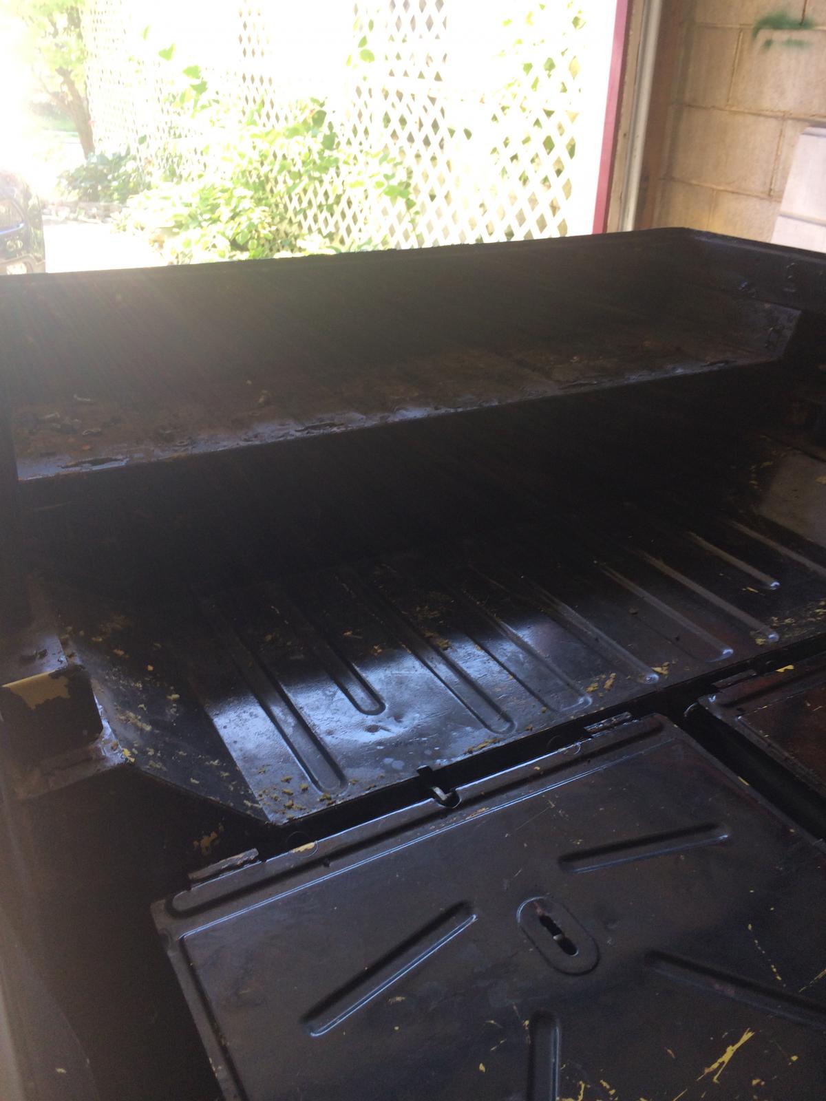

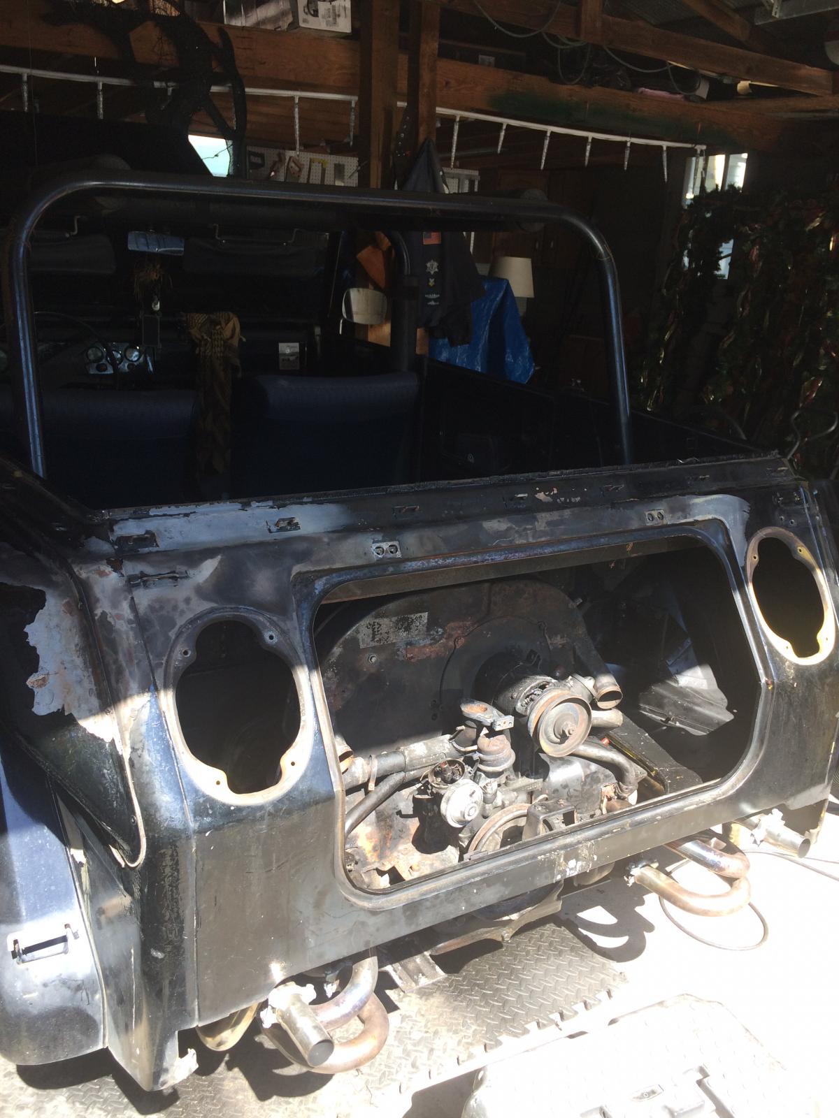

Still waiting for damage assessment from Hagerty but started cleanup and disassembly.
Removed: Top and frame, rear bumper and tire carrier, carburetor. Vacuumed up the crispy chunks
Going to need a bit more than a rebuild kit
Next on the list is air muff and rear fender removal, then engine drop.

Semper-
There are a couple of details in that gallery photo that give me the creeps.
The worm drive hose clamp is the worst choice for a hose clamp.
The "safety wire rig" does absolutely nothing to guarantee a seal between the brass tube and the carburetor top.
Those "Home Depot" red/blue/yellow crimp terminals are a dead giveaway of a half assed job.
The best option for the carburetor fuel inlet is a 1/16 NPT x 1/4" hose barb fitting. The carburetor inlet is very soft material, and is easily threaded for 1/16 NPT with no drilling. The fittings and tap are available from Amazon, among other places.
Use open barrel crimp terminals for your electrical connections like VW did.
They can be insulated with heat shrink tubing, or better yet, with purpose made insulators.

Fully agree on all points. Consider the wiring option simply a bandaid fix. Correct permanent fix is a threaded fitting.
I use the crimp on hose clamps whenever possible.
Yes again for the electrical. Open barrel connectors with additional shrink tube insulation is the way to go. I'm glad I have a proper pair of crimpers with the amount of electrical work I'm going to have to do.
