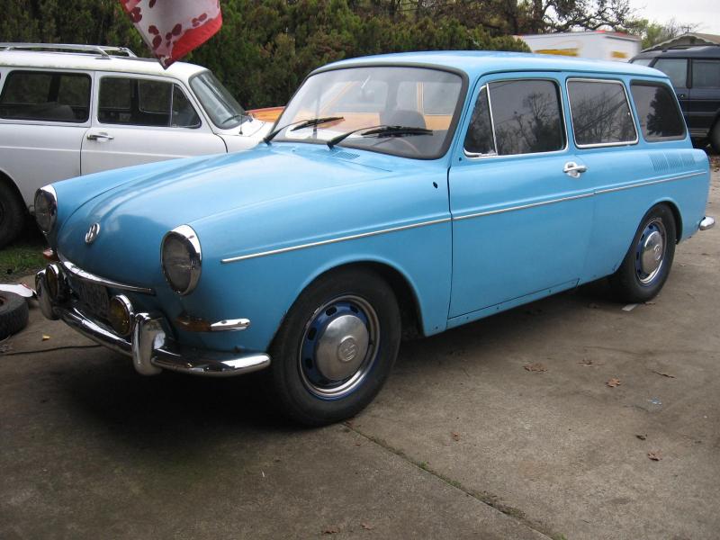

PostPosted: Wed Dec 31, 2008 6:35 pm    Post subject: Reply with quote
like this?
you cant' really see in this pic, but the blue shows again at the outside of the wheel...
