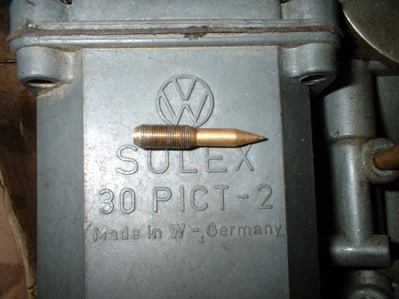

i use this older post to show the photo of the famous hidden "screw" of a pict-2
it is very difficult to remove.
i discovered that also earlier pict 2 have another hidden screw. it is in the top of carb and is an adjustable air bleed screw for idle jet.. very nice!

The 30PICT-1 was the carb used in 1967. The one used on 12V US-Spec 1500 Bugs had a base flange modification state number of VW 105-1 and the matching distributor was the 113905205K.
The 30PICT-2 jets are all removable, of course. But, it's not a jet that is behind that little cap screw, it's a needle.
