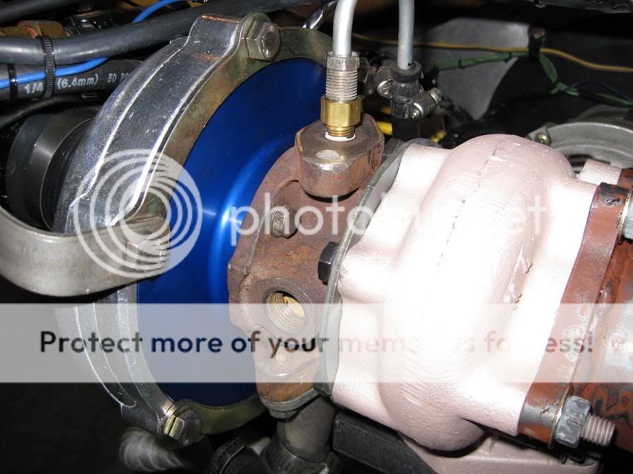

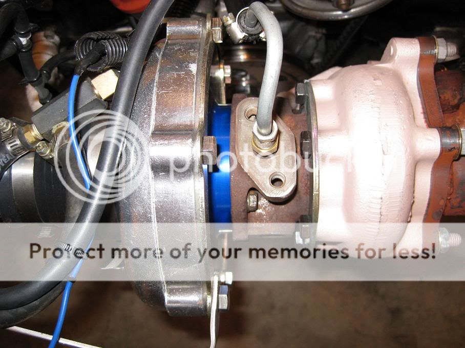

PostPosted: Sat Jul 18, 2009 4:41 am    Post subject: Reply with quote
Pictures of the new backplate!
Hi folks,
My USB bus decided to have mercy on me this morning and allow downloading of the turbo pics. Rolling Eyes
The carbon seal and backplate fit perfectly.
I couldn't be happier.
Besides....it looks SWEET, don't you think? Very Happy
