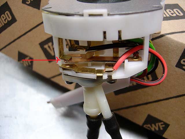

I've also heard that some of newer replacement wiper switches may already have some electrical contacts you can use to activate an electrical pump. They were originally intended to activate the intermitant wipers when you pulled on the stalk. Our Things don't have the supporting wire and special relay for that.
As you can see in this picture, this switch has both the washer valve AND a set of contacts that are activated when the stalk is pulled. One could wire up those contacts to activate a pump. I suspect that later Mexican Beetles used a wiper switch that had these contacts. Whether this switch is interchangable with the OEM switch (111953519G) is a good question. Unfortunately, I don't know the part number to the switch in the picture. I believe it's a later bay window bus part.

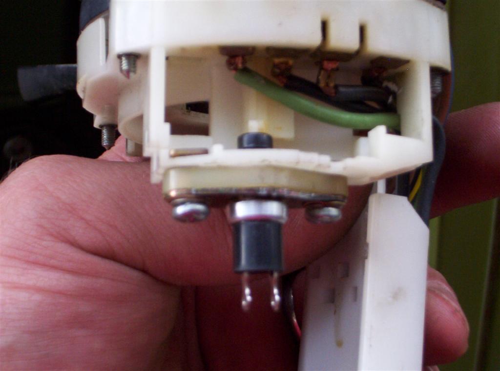

I went ahead today and removed wiper/turn signal switch assembly. Pretty simple really.
1) Disconnect battery (for safety)
2) Remove horn cover (Snaps off, turn 90, disconnect horn wire)
3) Remove steering wheel (Socket with 6in extension)
3) Unscrew but do not remove the 4 screws holding turn signal/Wiper switch assembly to steering column
4) Carefully remove washer hoses from washer valve
5) Disconnect the two plugs to the switches.
6) Turn/Wiper assembly will slide right out. Be careful to keep upright so those 4 screws and spacers don't fall out.
Once removed I took the switch assembly to my workbench where I have better light and access to tools.
I removed the washer valve assembly from the switch assembly (2 Screws). Modified (hacked) the washer valve (it was broken anyway) so it could be used as a mount for the switch. Reattached the new switch/washer mount and tested.
I found it easier to keep the switch assemblies together. It's stronger when kept as a unit. Becareful not to turn the switch assembly upside down otherwise the mounting screws will fall out. After the switch was mounted, I tested it with a ohm meter. Reinstalled the switch assembly into the car and tested again.
Used the fuel sender hole to route one wire to the front of the car near the existing reservoir. It will get connected to the electric washer pump. The other wire will get connected to the fuse panel.
Just butt connect the two hoses together that were connected to the old washer valve.
Pretty much looks like this: (not my picture)
Note:
Notice that the valve assembley was hacked off flush with mounting flange. In addition, the flange was "flipped? around so the metal plate is now on top. You have to drill out the flange to fit the body of the switch. The mounting nut for the switch should be flush or below the plastic part of the flange. You also have to make a hole under the flange for the switch's button to fit through.
