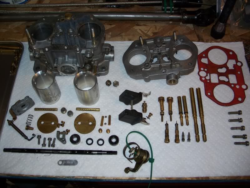

i am in the process of cleaning and rebuilding my dells. Should i remove the spindle bearings from the throttle shaft before i put them in a carb dip? Also, is that all I need to remove or should i remove the the throttle valves and the entire throttle shaft? It turns freely now, and i have removed everything else. i do not have the dell tech book yet, but i am going to buy it when i buy my rebuild kits. I am just trying to get everything clean and ready to rebuild. thanks
i have not removed these plugs. Do i need to? and if so how? [the brass ones in the pic]
and here is a few pics of what im dealing with.

Do not remove the plugs
Do not remove the throttle plates
Do not remove the throttle shafts or the bearings.

Sounds like you'll proceed with dipping them - fine. I've done that at home too on numerous sets. Let them sit overnight, then scrub the surfaces with toothbrush. After rinsing with water per the carb cleaner instructions, put on safety goggles and spray into every opening with compressed air. The stuff will fly out of unexpected openings so the goggles are a must. Once everything's dry I'd recommend oiling all moving parts (e.g. throttle plate shaft and bearings) with 3-in-1 oil which is thin enough.
Then write down your main and idle jet sizes as well as your venturies so you have a baseline when you start the engine for the first time.

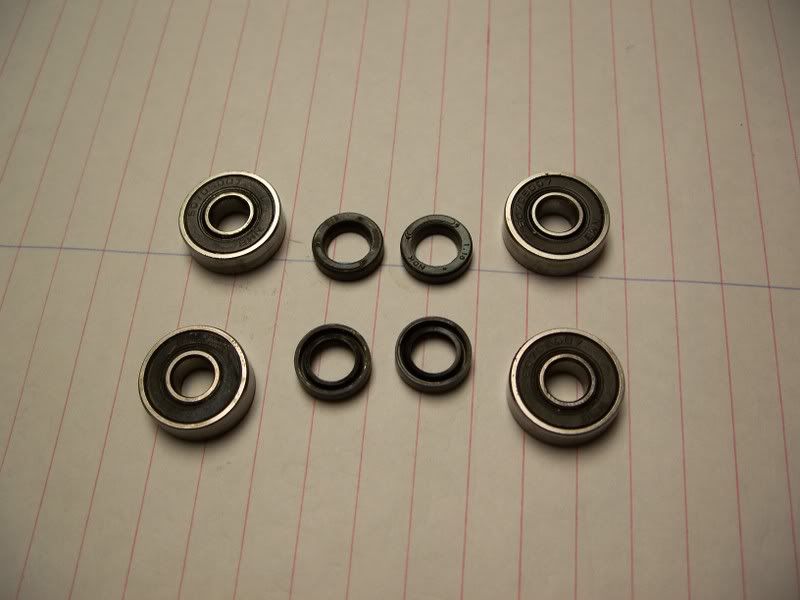

I've got a pair of Dell 40s that I "tanked" 2-3 times over the years, leaving the shafts and bearings installed. I finally decided to do a full teardown on them and was supprised to find the bearings only wanted to rotate ~90° before binding (with throttle plates removed). They're sealed ball bearings available from CB Performance for not too much $. I think the carb cleaner damaged the seals and allowed dirt and gunk into them over the years (in a baja). I wouldn't say it's necessary to remove everything like this for cleaning, but just something to think about if your shafts are stiff at all without return springs insalled, etc. Here'a a couple pics of when I took mine apart for their most recent cleaning and turbo-prepping.
These are the bearings and shaft seals. Non turbo-prepped carbs won't have the smaller seals on the inner shaft bushings.

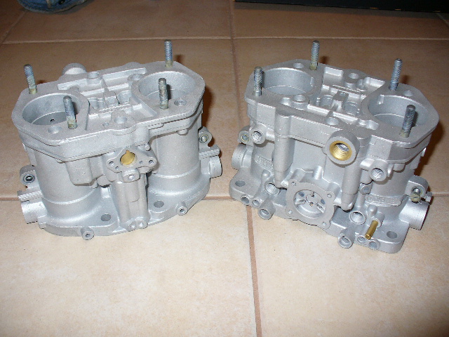

well, i soda blasted my carbs and i was quite pleased with how clean they ended up. However, the metal finish had lots and lots of little black dots on the outside(on about 3/4 of the body) that wouldn't blast off. So i pulled out the dremel and used the little wire wheel to remove them, which worked. However now my carb is all shiny and i cant figure out to get the dull stock finish back. So...looks like i will be buying some aluminum polish to make the finish a consistent shine, which isnt my favorite finish but i dont think i have another choice.
1967 Beetle

PostPosted: Fri Nov 19, 2010 12:56 am    Post subject: Reply with quote
kolt10 wrote:
...looks like i will be buying some aluminum polish to make the finish a consistent shine.....
Don't do that! It will look worse.
You could blast it again.
You can get them from your local bearing store. They're about $5 each.
607-2RS is the bearing number.

Ya I tried soda blasting them again but it didn't help. It wouldn't return to original finish

These Dellortos had a lot more corrosion than yours. I gave them a light glass bead blast to clean them up.

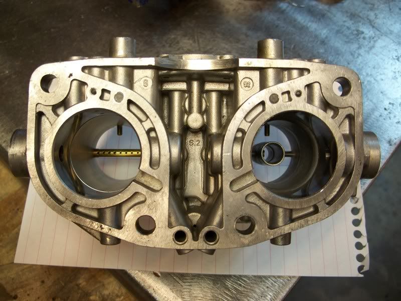

I have a friend that has a blasting cabinet at his machine shop that I can use. So what exactly do you mean by a light bead blast. I thought it wasn't a good idea to bead blast Carbs because the media could get stuck.in the passages

PostPosted: Fri Nov 19, 2010 6:46 am    Post subject: Reply with quote
For those that are not detail oriented, this is true. If you are capable of detail, and will flush all the circuits, and dry them out completely, you can do it. If you do not remove EVERYTHING from the carb that comprises a circuit, and throttle shafts, etc., don't do it. If you are capable of being systematic about flushing everything out it'll be fine.

ok i am in the process of taking them down to just the bodies. So once i have the complete bare casting i should be ready to bead blast them. Is there anything special i should know before doing this, like anywhere i should avoided blasting or be careful around or hit very lightly? Basically i am just curious how i should go about blasting them. thanks
