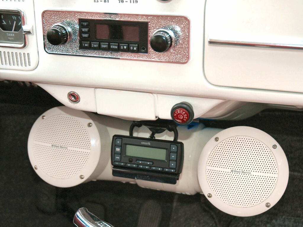

Hope everyone is doing fine...haven't had too much time to do much to my new-to-me single cab, but thanks to this website I managed to take care of some little things and found those locks made of unobtainium for the '67 treasure chest.
Wanted to shoe a pic of my stereo...bought a cheap ass "motorcycle stereo" off of ebay for about $30...wouldn't recommend for a bike, but fit perfect and only had to make on small drill hole to bolt down the PVC pipe I clamped the speakers on. Sounds fine enough for me. Definitely better than the sound of a factory installed one back in the day.

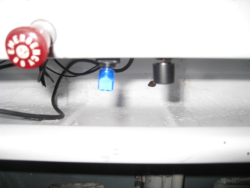

Thanks! I started to use the old tape head input and ran into how to switch it. The old school cassette player had a micro slide switch that would move as the cassette was put in. 6 wires. d'oh! Feed line to the amp that closed to cassette or radio for each channel. I started thinking of double pole, double throw switches and got real at that point. Laughing Dangling switch to mess with or aborted project as I launch it from frustration. You know how some projects start pushing the time invested to out come value mark lol.
So I just went with the RCA into the amp for the iPod. Next Radio donor will have RCA in and out. For sure the best option and possibly worth a redo some day.

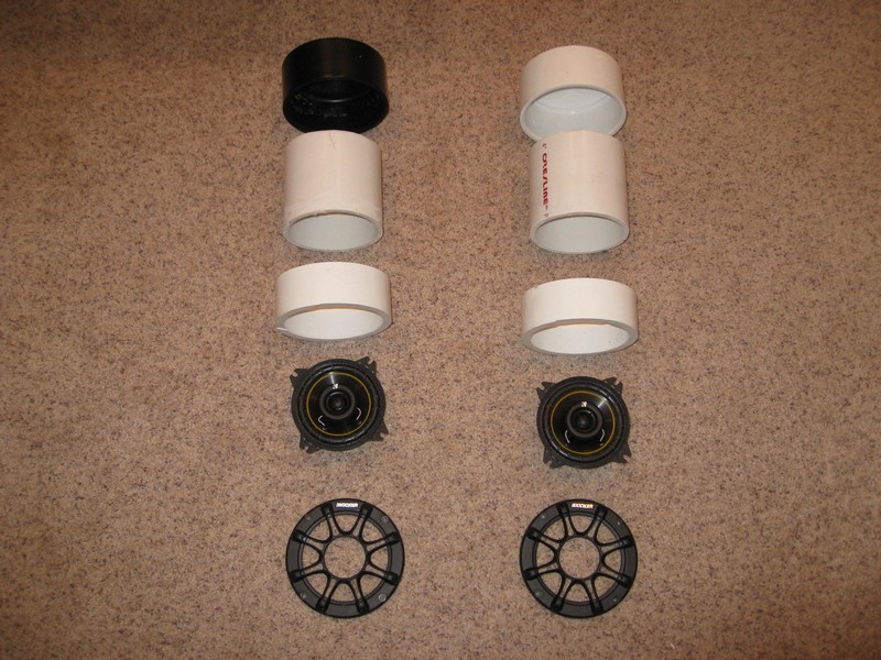

Here is the the system I just put in my bus.
Front Speaker housings.
So I have gotten to the point that I need some tunes for the bus. I am going to go the amp route to run my XM. I called Crutchfield and they got me all of the stuff I needed.

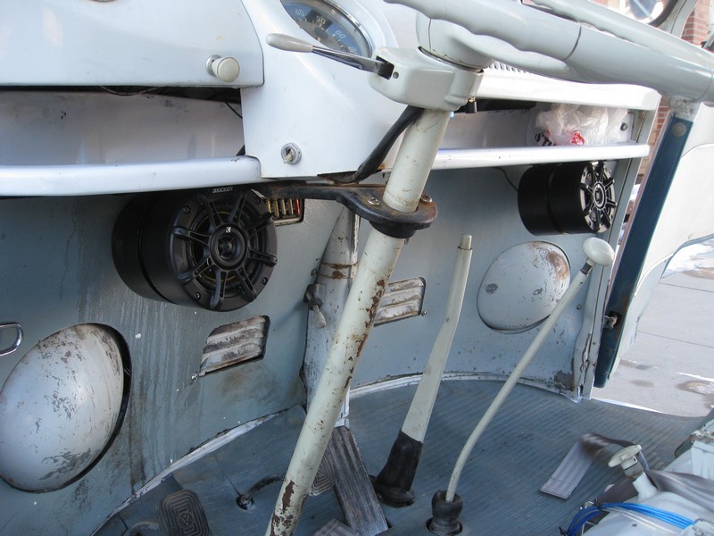

I started on the front speakers. I didn't want to cut into the door panels or the front kick panels so I made 2 tubes for my 4" front speakers. I was going to try and mount them on the parcel tray but there really isn't enough room. I will more than likely mount them to the bottom of the tray with the T brackets I mounted to the bottom of the tube.
I finally have tunes and man does it sound good. I bought all of my components from Crutchfield. I called them up and was lucky enough to get one of their sales guys named Brian. I told him exactly what I wanted to do and he put it all together. I didn't need one extra piece of hardware to do the job.....he nailed it. It cost me $725 total. Based on what I was quoted at Car Toys, this was a much better spend.
I basically have a JL Audio volume control that hooks into my amp that I can run my XM Inno through. 2 4" speakers up front, 1 8" Bazooka/Amp, and 2 6X9's on boxes under the seat.
I have included my parts list in case any of you are interested in copying what I did. I definitely have an appreciation for installing sound equipment. It took me 2 evenings to do it.
I have a toggle switch to power the amps. The nob to the right is the volume control. I plan on putting my old stock radio back in.

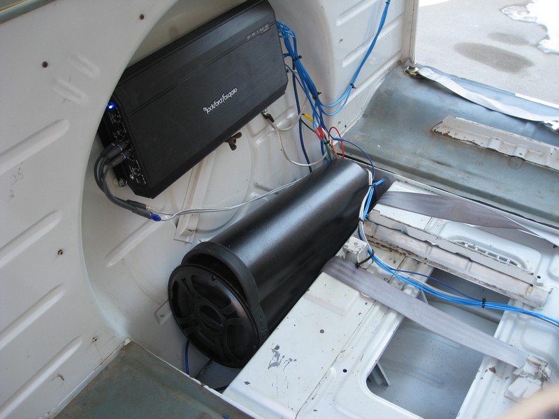

Fibreglass makes mounting options virtually endless - unfortunately the shallow depth of the splitty doors and nose makes it a challenge to fit a deep woofer/driver in comfortably. Here is our most recent (and most complex) installation using 2 x amps, active three way front stage (with splits in the doors and four woofers in the nose), rear splits in the corners and 2 10in subs in the roof.....lots of fabrication and wiring!
This is a rear roof sub enclosure so we didn't have to use the under rear seat area (filled with storage draw and ECU etc etc).
