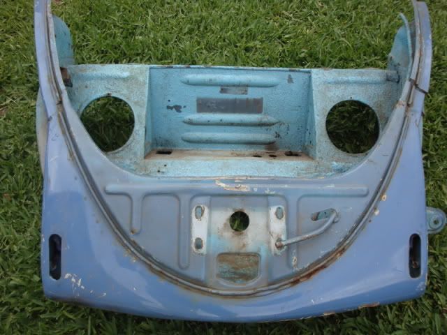

I have a 60's front valance on my 54 RHD Oval cabrio that I want to replace with the correct one. I've been offered an Oval valance but it appears to have 3 fingers instead of 4 fingers. Any idea what year this would be off?
Thanks
Steve

Its a 59 to 60 pretty sure!! My feb 55 cab has a 4 finger and my buddy has an OG 4 finger on his 56 cab!!

1960 model year only used the 3-finger apron.
That is correct. It actually is not even a one year only part as the early '60's had the 4 finger apron.
