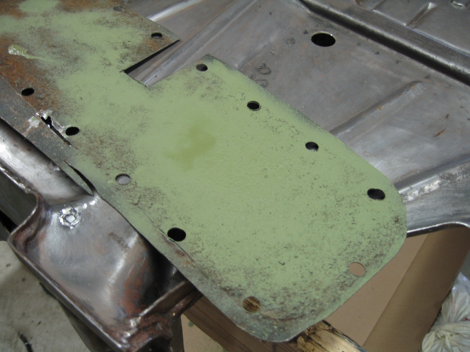

PostPosted: Wed Jan 04, 2012 3:28 pm    Post subject: Test result Reply with quote
*#GTI wrote:
It would be appreciated if we could get an update on on the rusults of this product from some of you who used it from over a year ago. Im really interested in this product . Thanks!!
I sprayed some of this product on a rusty piece of sheetmetal that I cut out of my floor pan. Here it is after I sprayed it on June 4, 2010:
After I let it dry a couple of days, I tossed it outside beside my garage, paint side up. It was rained upon, snowed upon, and even sun-shined upon for well over a year & a few months before I retrieved it. It now looks like this:
Considering I did zero cleaning or surface prep of any kind (just as it would be if used inside a confined area), and then subjected it to our very wet climate for a considerable amount of time, I believe it held up well.
