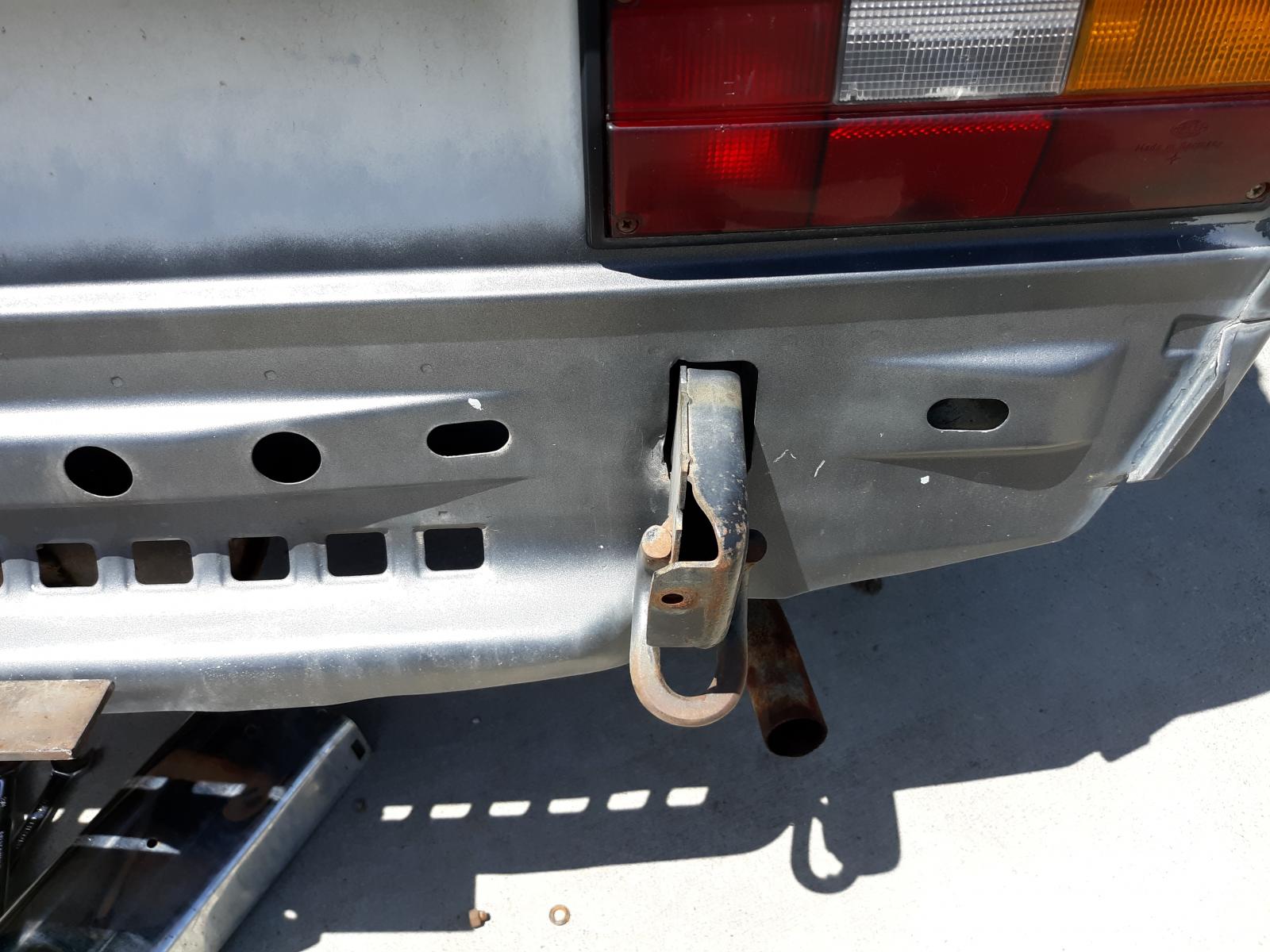

Here is how it was when I acquired it. Removed damaged interior panel and slider panel.(Will be repairing them and door panels) Pulled middle seat that apparently was not bolted down at all through my childhood. Shampooed all the carpeting. The calipers were blasted and honed during rebuild. new upper ball joints. Lowers and all bushings will be done in the near future. I slapped the hubcaps from my bug on it as I do not have any others for it. I have replaced the speedo cable and removed the unused and non functioning box that uses the 2 piece speedo cable.
THe rear hatch is bent. Any ideas on how to fix it???

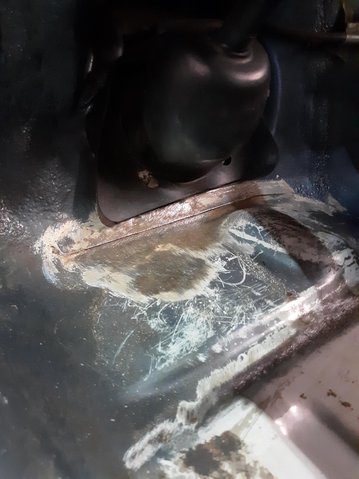

Here is the pics of pretty much the only rust I have found due to the clutch MC leaking. Just three lil holes. Treated the steel with some Rustolium rust remover after a heavy scrubbing with a wire wheel. I covered the holes with small squares of steel that were also treated. I had glued down the pieces with seam sealer and fixed the front panel seam too. Then coated with a rubberized rust inhibitor.

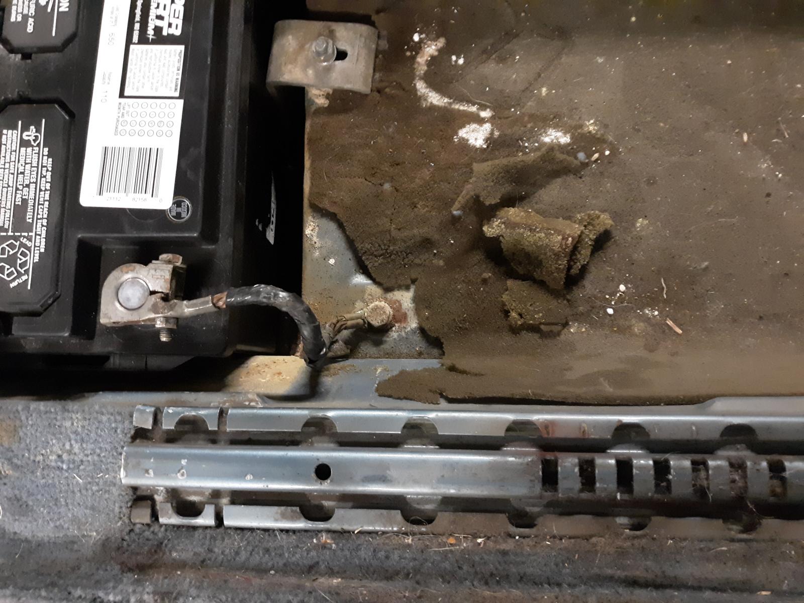

Well I did a bit more digging. I know that there was a leaky battery at some point and I had cleaned the area with baking soda and water during the "just get it running" stage. Now I went back through and cleaned it up proper. Sadly I forgot to get the before picture of the lil mess. Scoured the area and treated with some rust dissolver and converter. Then coated with a rubberized converter and sealer. Replaced the old dead foam with some new sound deadner.
Look at the yummy ground point.
The red wire has its grommet on backwards too for some reason. It has been corrected.
If you are new to these make sure you have the proper size battery and its cover. I removed the tape that someone used to try and prevent it shorting out and you can see two nice little burns.

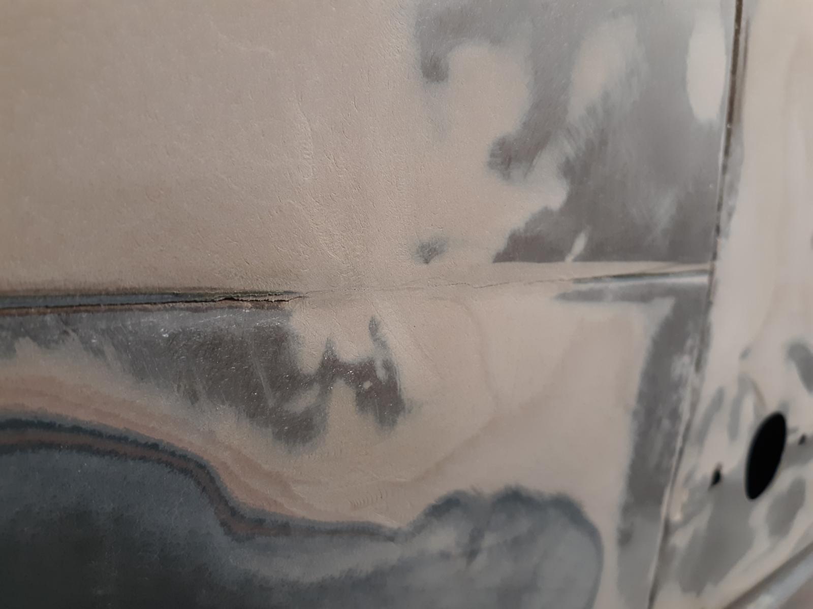

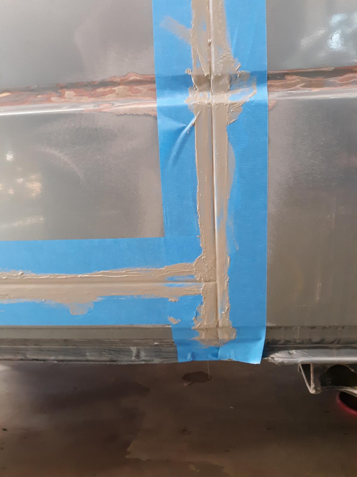

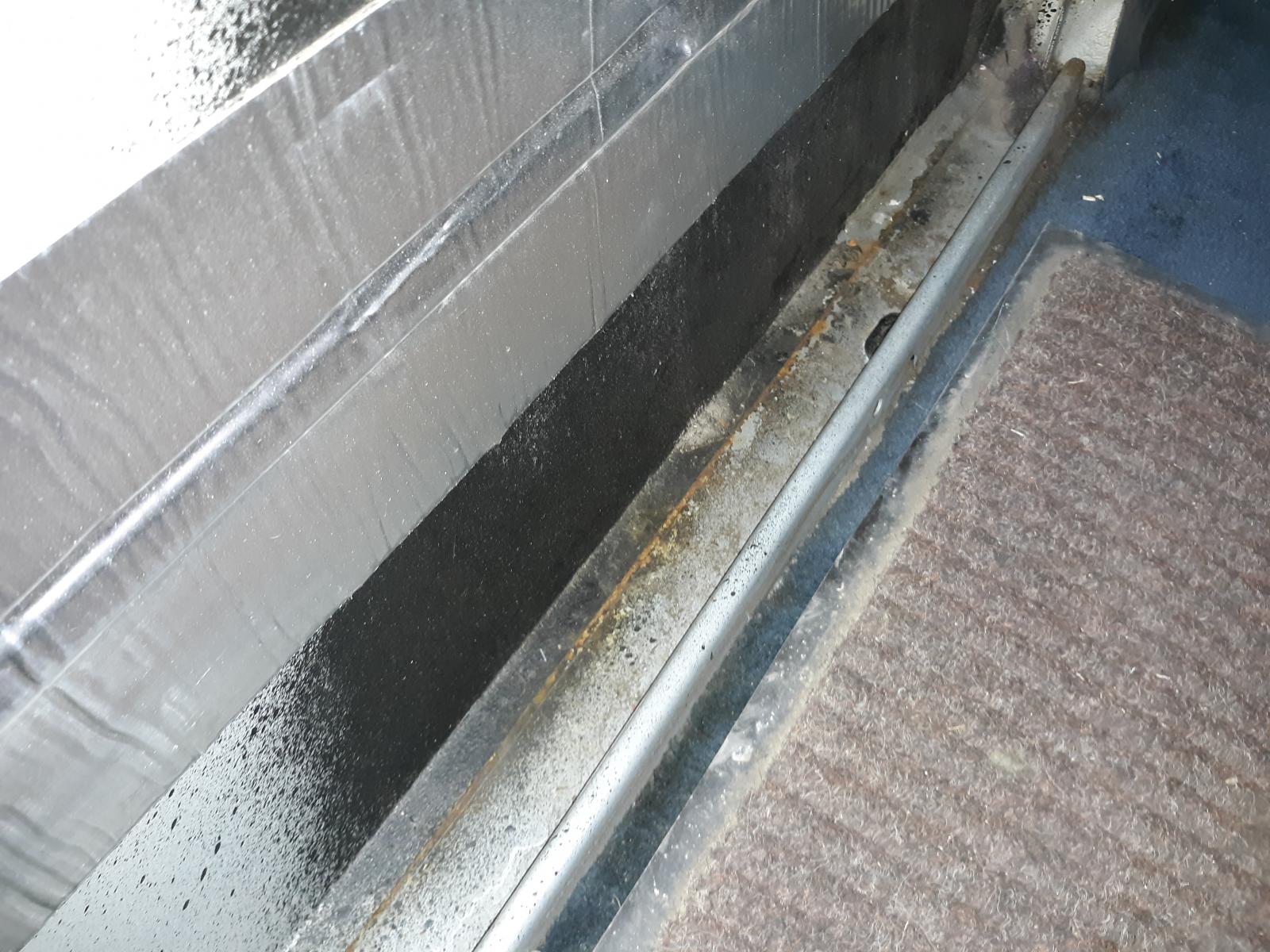

I dug into a few of the seams as the middle panel was leaky. Picked and scraped out all old sealer and sanded down inside. Treated with acid then masked off and new sealer forced in. I did find more body damage than I thought there was. The rear corner and front I knew about as I had helped fill them 20 years ago. They have been primered since then. Will be stripping off old filler and trying to pull the dents out better.
Any suggestions as to how to correct the buckle in the pillar?? The body contour is gon and it is a flat straight area.

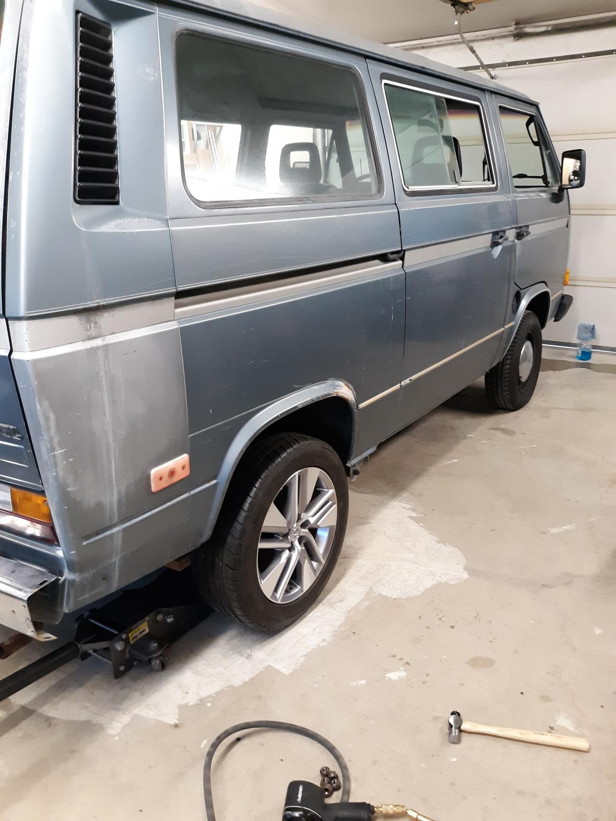

Well I am starting to feel better and well enough to get back to work on the van. The bug is waiting for warmer weather to use paint stripper to get rid of the lead paint.
After looking around online and calling local yards I have not found any donors close enough to make it cost effective over new metal. I have decided to try and repair it. I have the motor and trans out to deal with new problems of old parts finally giving up. Fun part is I know when and where they got the damage. The water pump had given out on a trip and we overheated in the Sierra mountains back in 2000. That replacement pump has started leaking bad and the thermostat housing had apparently melted a bit and is now cracked. Those and a leaking oil pump are why the motor came out.
DO NOT BUY FEQ Axles. POS 4000 miles and both dead on all 4 CVs splines wearing badly and making quite a racket.

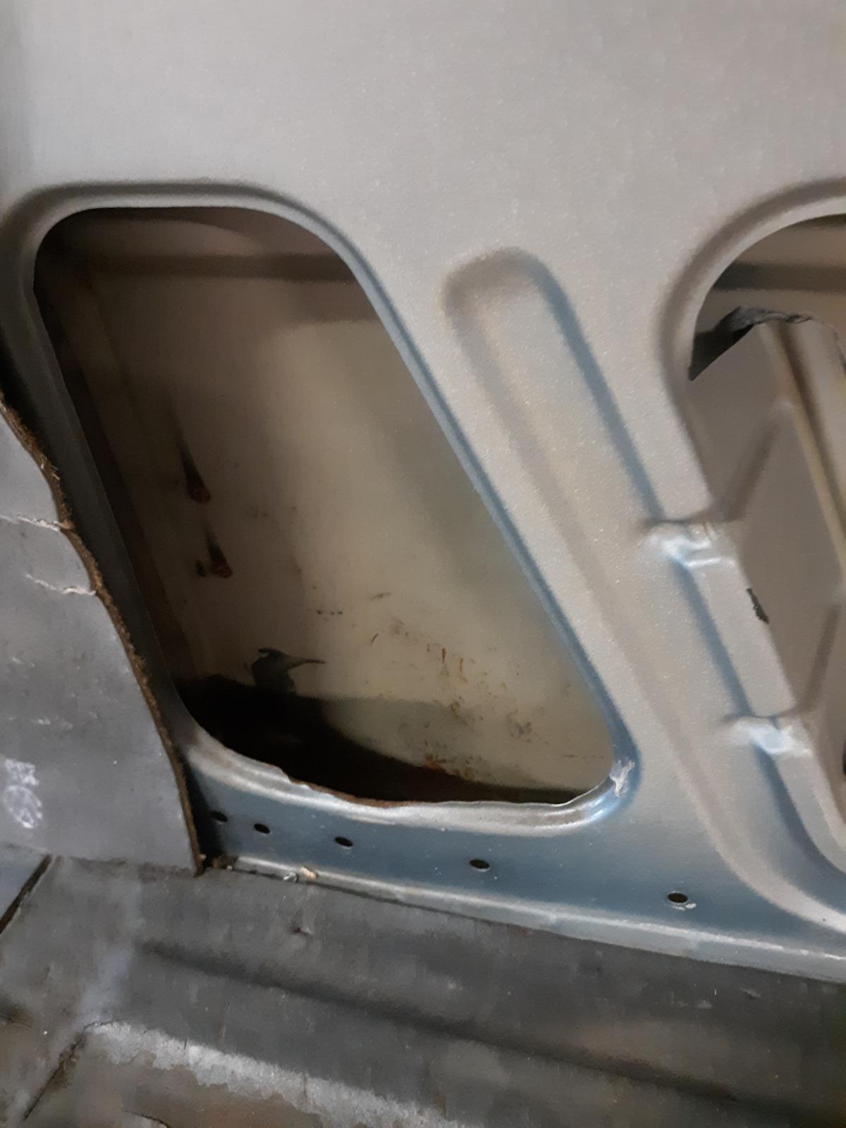

With it all out I now have full access to deal with the rear quarter panel. I reached up into the body cavity and the buckle on the panel is far worse than what can be seen from the visible side. I have a few new toys to try and get it sorted out. I have a stud welder now and have already given it a go on the back edge and now it is far better than before. With any luck my somewhat dubious plan to pop it all out should get it straight enough to be solid and get the body contour back. Will need to fab up the corner bit as it is torn apart.

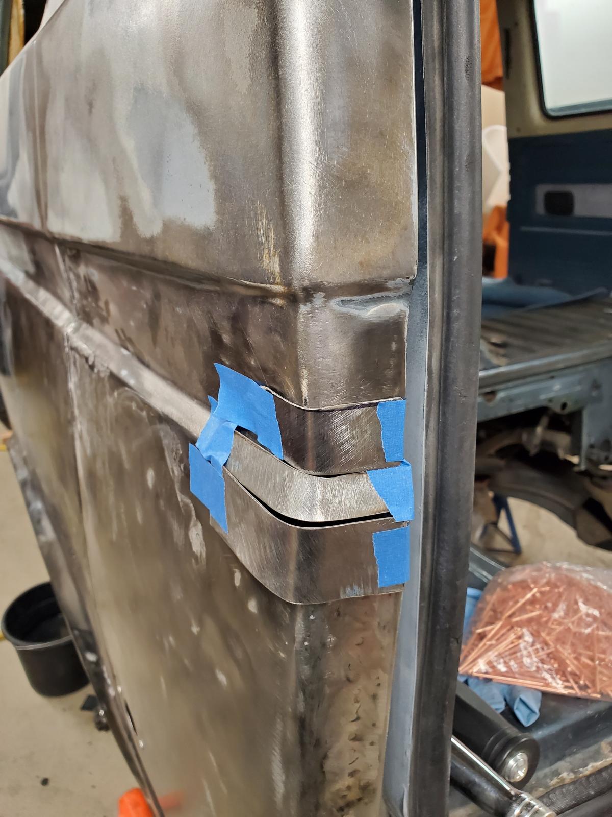

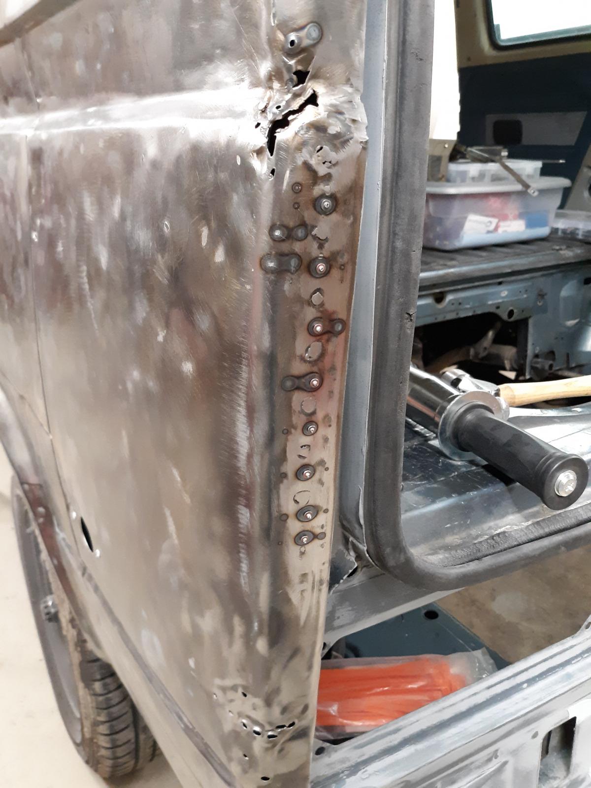

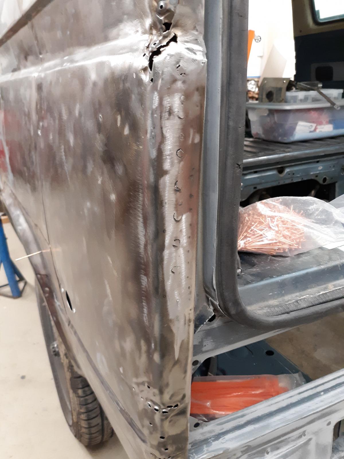

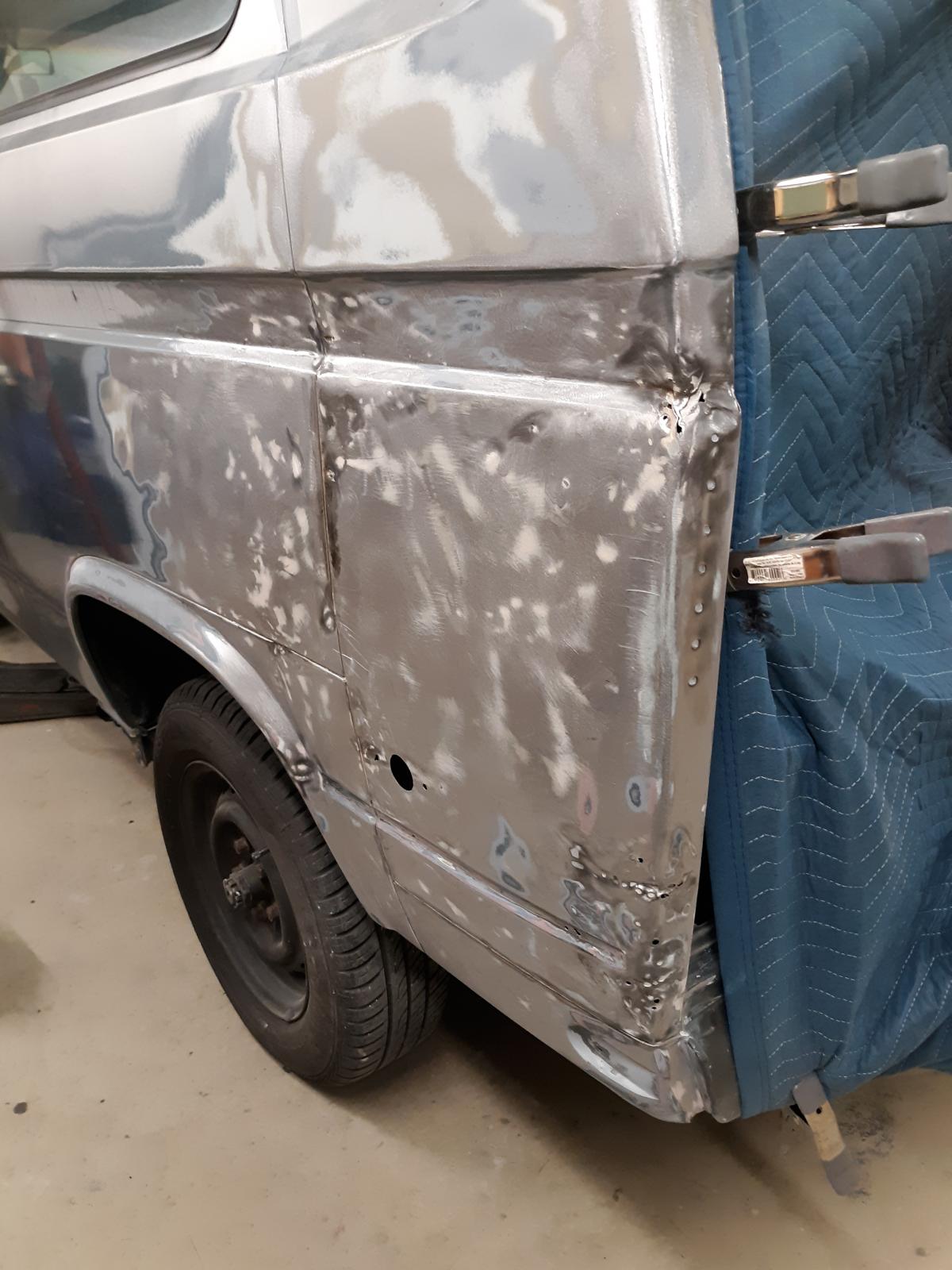

Well got to pulling and hammering. After a few hours I was wondering what I had gotten myself into. But I kept at it and have gotten it pulled out quite well.
Will need a skim of filler but it will be better than the 1/2" thick layer covering rust.
Decided to just fab up the corner. It may not be perfect but will be solid.
