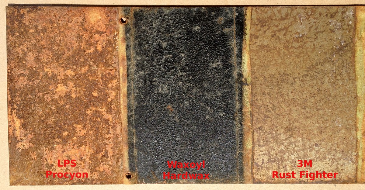

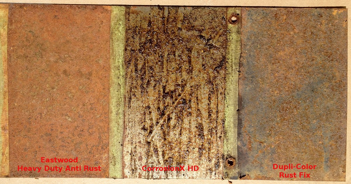

OK! Time for the somewhat surprising results. The test plate spent 6+ months bolted to the engine skid plate on my wife's Subaru. We live in pretty-much a worst-case winter area in the Adirondack mountains. Snow, slush, salt, and sand for 4-5 months of the year. This year the snow was actually pretty light, but I think the rusting conditions were still excellent. Here is the BACK of the test plate (untreated):
Here are the left and right halves of the treated plate.
Procyon, WaxOyl, and 3M rust fighter:
Eastwood, CorrosionX, and Dupli-Color:
Here are my comments/thoughts on each product:
LPS Procyon: I had high hopes for this product. Went on like a pretty hard & durable wax but really didn't make the grade. Complete failure.
Waxoyl Hardwax: Looks excellent. Couple of little rust spots are where the product bubbled on application. Should have used two medium coats instead of one. This is what I'm going to go with from now on for all exposed metal.
3M Rust Fighter: Interesting result. This is actually a softer lanolin wax intended primarily for inside panels/doors, etc... Nevertheless, it held up very well - the rust you see is mostly what was on the panel when it was applied. This goes on much more runny than the Waxoyl and should penetrate into cracks better -- so maybe this is the top pick for inside doors and rocker panels.
Eastwood "Heavy Duty Anti Rust": This was another product that looked pretty tough when first applied but it failed completely.
CorrosionX HS: This is more of a grease than a wax -- probably not a good choice for moving vehicles. I thought it would all wash off but most of it is still there and it's actually doing a pretty decent job of stopping the rust. Still very soft and greasy - never hardened up.
Dupli-Color Rust Fix: I put two coats of this on to give it a chance but it failed and has the worst rust of the test.
So, short answer: Use 2 coats of Waxoyl outside, use 3M Rust Fighter in doors and panels.
