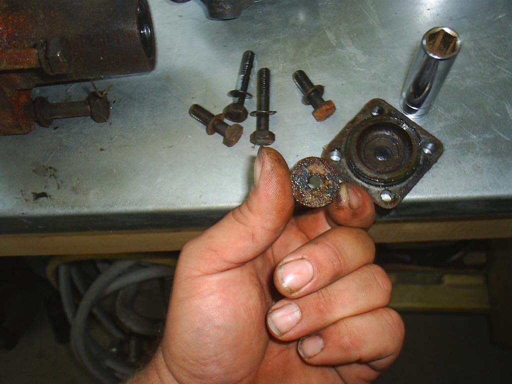

Below are photos from earlier in the thread that I could not add because of the time lock on changing threads. My server is off most of the time. I noticed someone asked for them.
This is a photo of a 1973 early box made by Gemmer in France. It has a smaller thread. The one on the right is a standard late 1973 ZF box. Same basic box licensed by Gemmer to ZF.
This is the French made one apart while it was being restored.
This is the late one being restored. It was a low mileage unit with minimal wear but the seals needed replacing so I went thru it also. It is currently on my bus and will be sold once I mount the NOS one that Hoody sent to me.

I think it was Skills who just bought a rebuilt box and all he got as I recall was a paint job.
Here is a quote from his thread on the "rebuilt" early box he bought. Scary.
skills@eurocarsplus wrote:
as promised
you can see the lower cover to the right, but a plain old washer was what the "rebuilt" steering box used to take up the slop
more rebuilt goodness
you can see the arm was all galled up. this end has no bushing. the housing was just as bad
i will admit, i washed off all the paint, popped it open saw what a joke it was and it did sit under a bench for a while. some of the rust on the guts was there, and some is the result of hiding under a bench
i would like to also point out that the bearings on the worm were each missing 1 ball. awesome!
