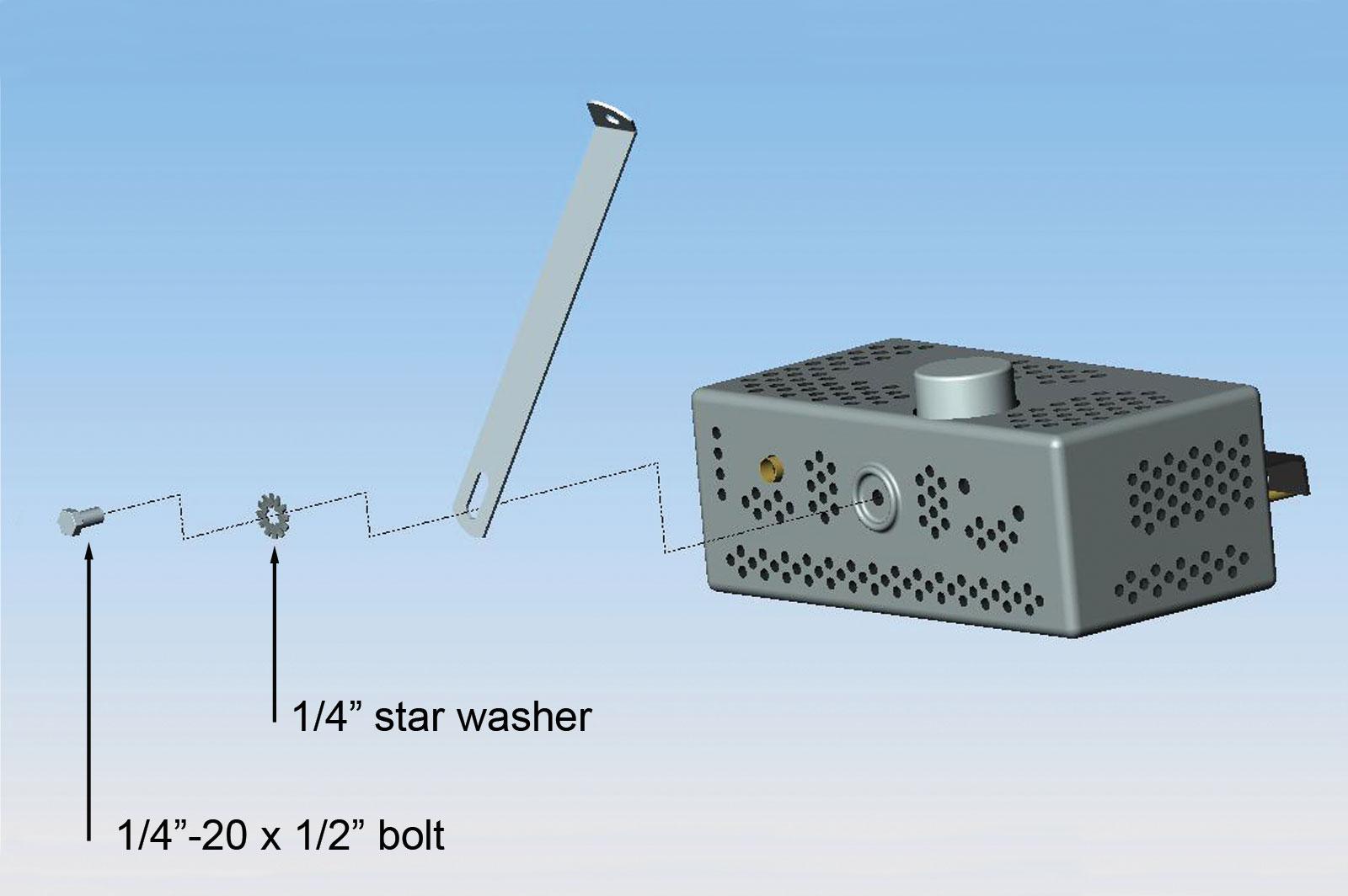

Next, the rear mounting bracket is installed onto the back of the radio.
Mount the radio in the car. The top of the mounting bracket bolts onto the windshield washer motor.

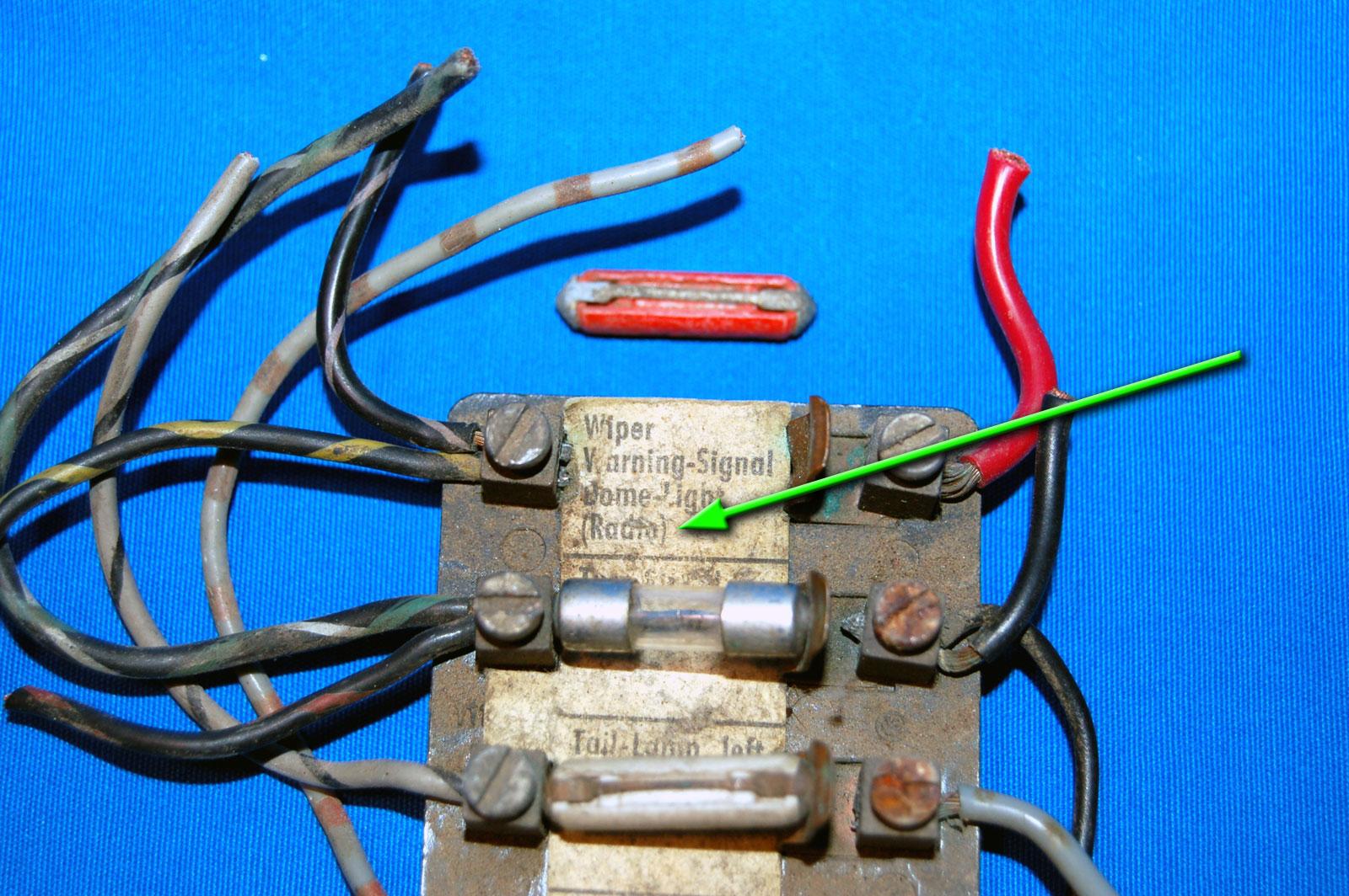

If we look at page 2 of the Motorola installation manual…
At the bottom of the page, we see the wiring installation which recommends getting power directly from the ignition switch. These instructions are for the 6M radio. It’s possible this would be correct power source for the 5M and the 6M radios.

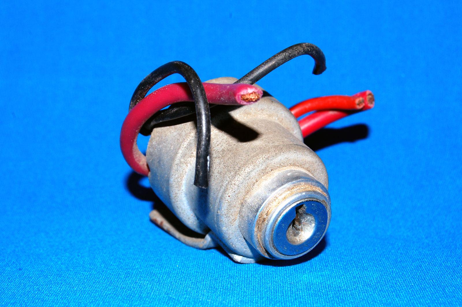

The original ignition switch from my ‘57:
The back of the switch:
The green arrow points to terminal “15” (it’s a little hard to see the number to the left of the terminal). It looks like the installation manual wants the radio to receive power from here.

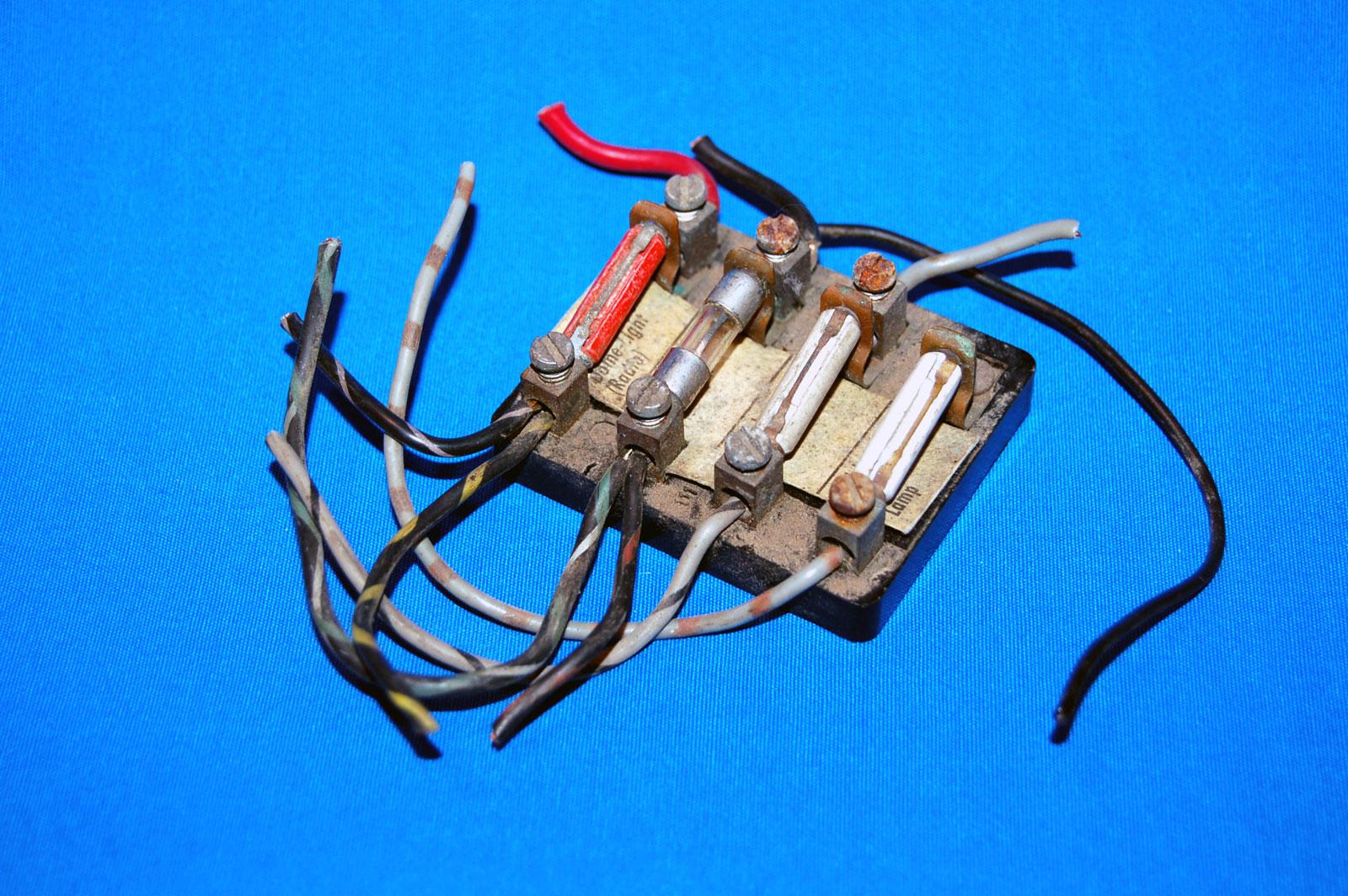

However, my radio was wired as shown below…to the fuse block.
Here’s my original 4-fuse box from my car:
if we remove the red (16 amp, i think) fuse, the original paper fuse box insert can be seen. The green arrow points to “radio”.

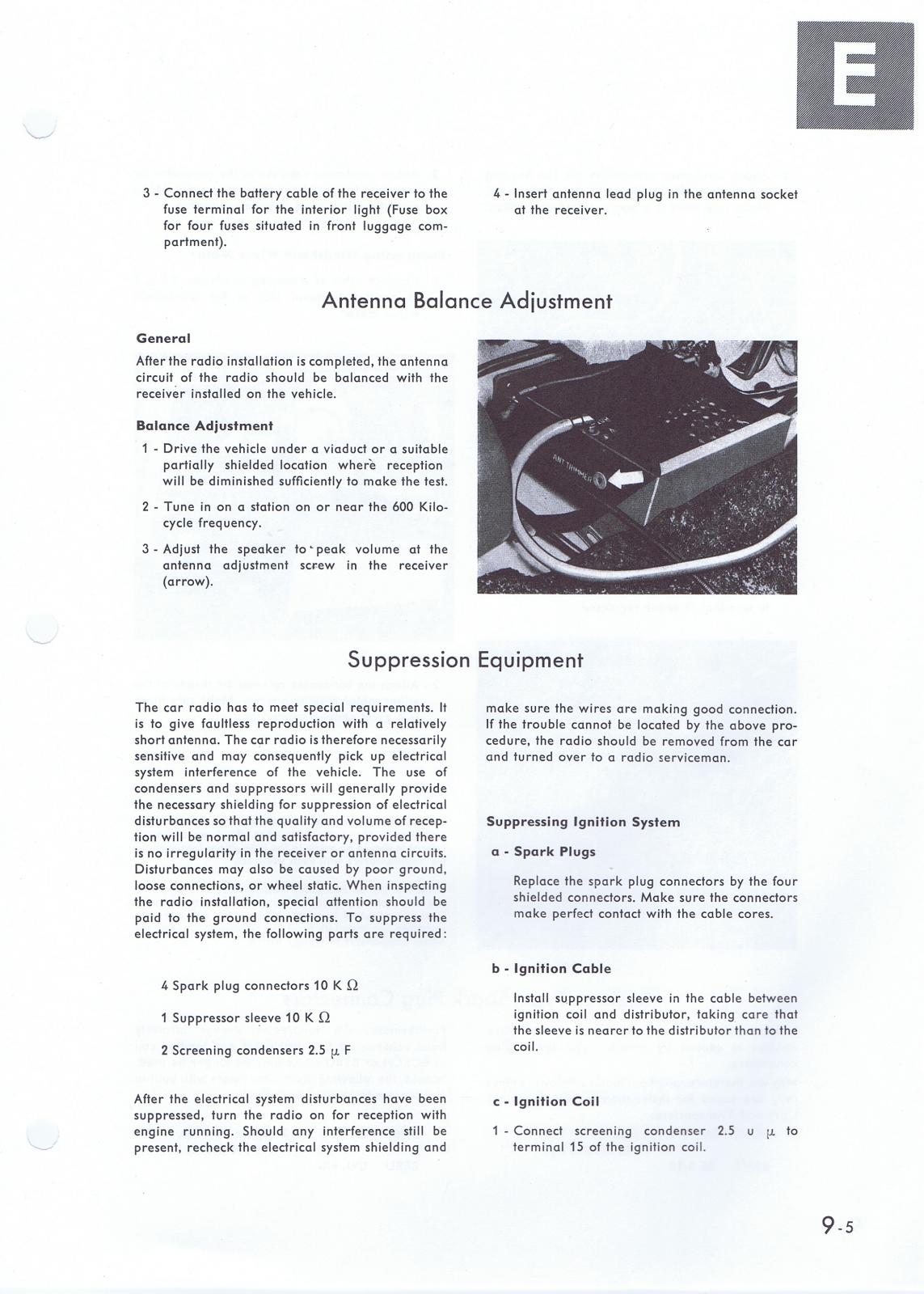

Here’s what the Bentley manual says:
Just for reference, here’s the rest of the Bentley manual’s radio section:

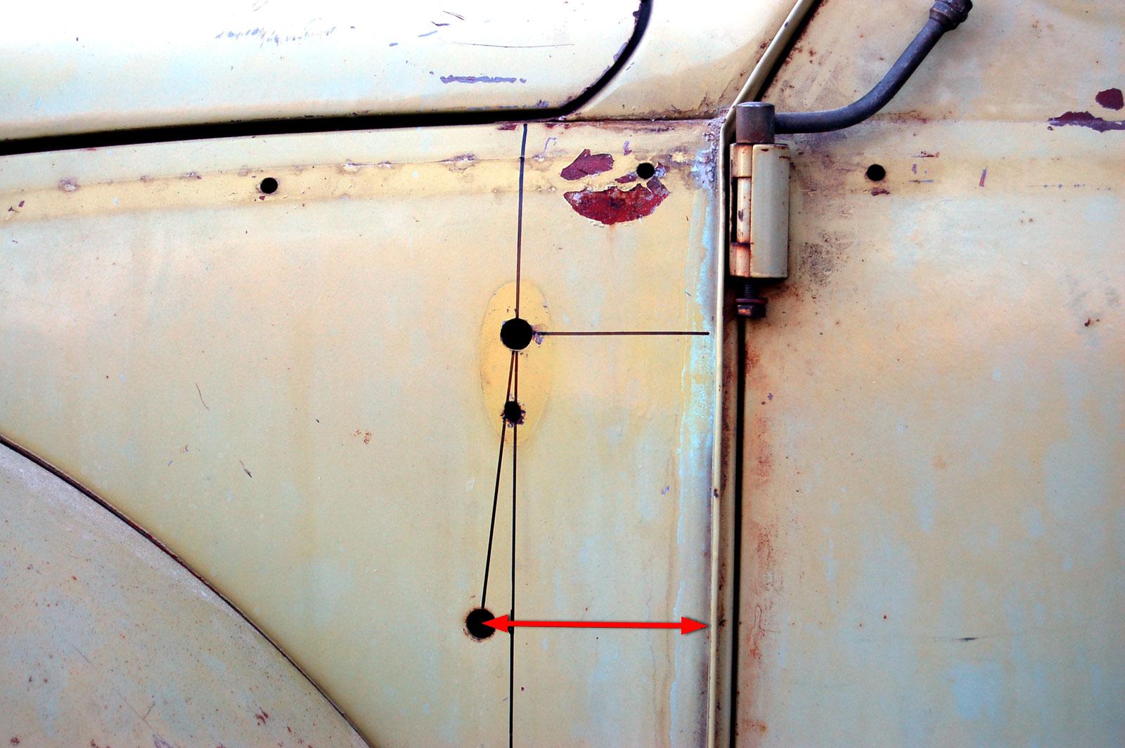

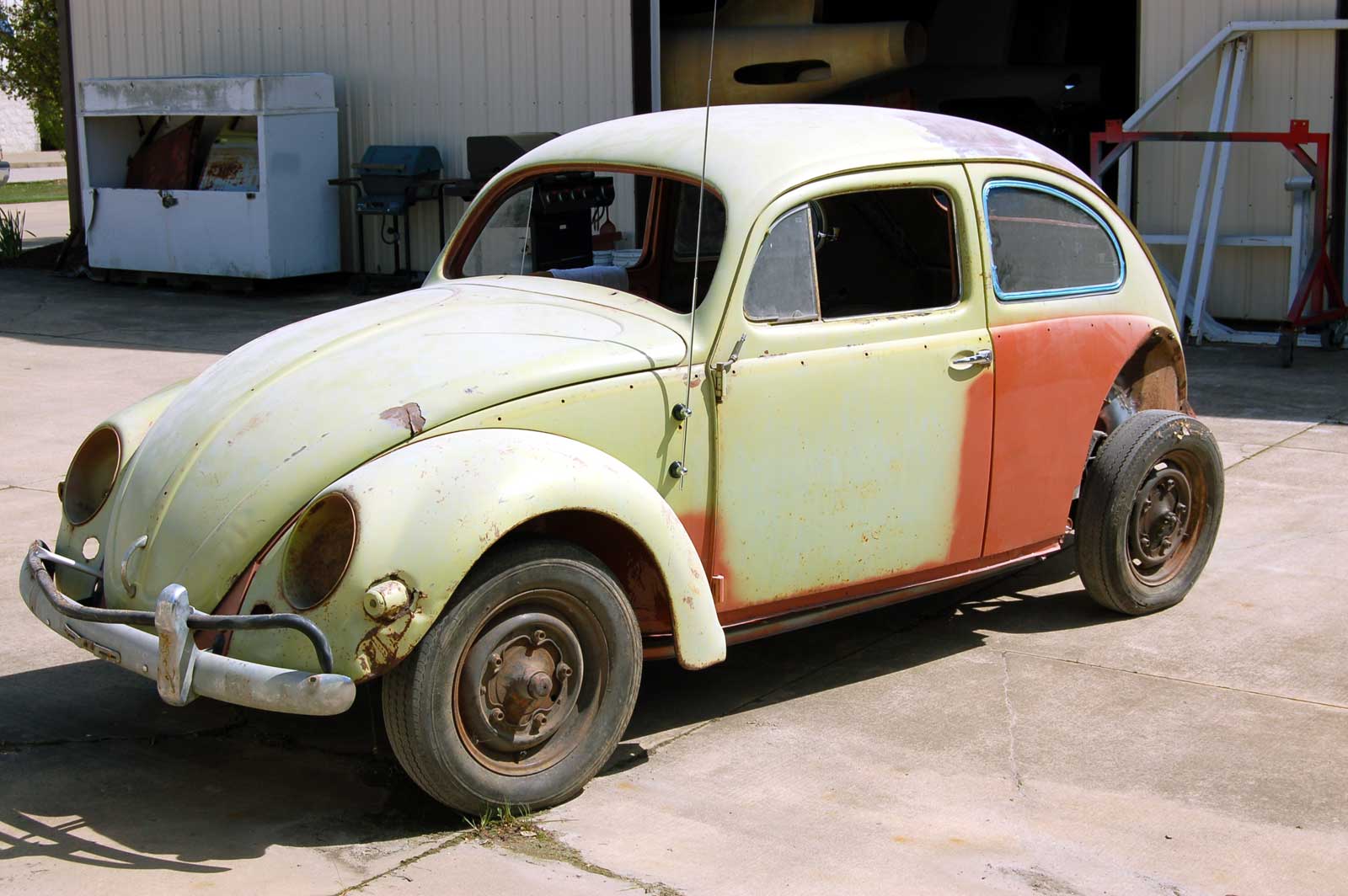

The antenna mounts onto one of the front quarter panels of the car. It was up to the dealer/installer to locate and drill the holes in the car.

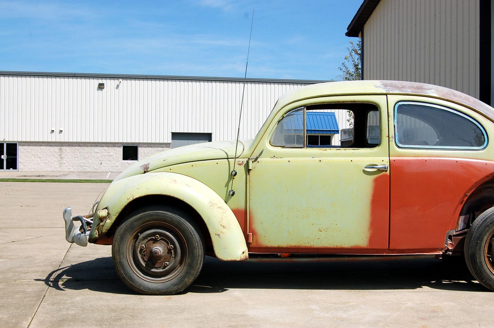

For reference, here is where mine was installed.
A view from the side:
I drew some lines with a magic marker:
The distance from the top edge of the quarter panel to the center of the bottom hole is 10 3/8”.
From the top edge of the quarter panel to the center of the top hole is 4 1/16”.
The distance between the holes as (center-to-center) as shown below is 5 3/8”.
The distance from the flange to the center of the top hole is 3 5/8”.
The distance from the flange to the center of the bottom hole is 4 3/16”.
The diameter of the holes is 9/16”.

PostPosted: Tue Apr 16, 2013 2:01 pm    Post subject: motorola radio bracket Reply with quote
i have been contacted more than once in regards to the bracket at the back of the radio that bolts onto the wiper motor:
i noticed there are several "big m" radios in the classifieds every so often and they all seem to be missing this bracket.
i created an engineering drawing from my original so it can be duplicated if an original can't be found.
the drawing is located in the archives:
http://www.thesamba.com/vw/archives/manuals/motorola_bracket.php

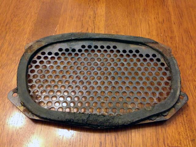

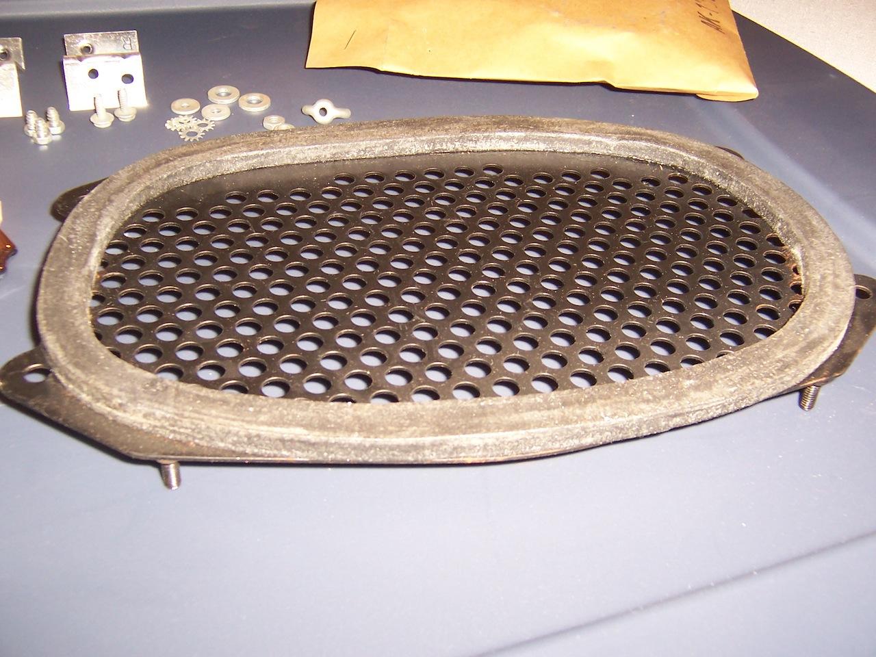

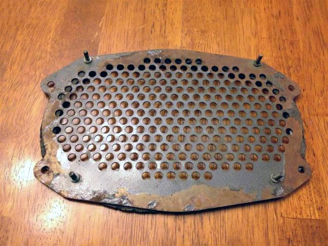

PostPosted: Tue Apr 16, 2013 2:08 pm    Post subject: speaker grill gasket Reply with quote
on another note, this speaker grill popped up in the classifieds recently:
it still has the original gasket:
i mentioned earlier that i didn't have a picture of the gasket on my speaker grill...the photo above shows it quite well.
again, i'm not sure if this gasket would have come with the radio "kit" or if the dealer put something on from an available extrusion.
there doesn't appear to be a seam on the gasket. so, maybe it came with the kit???

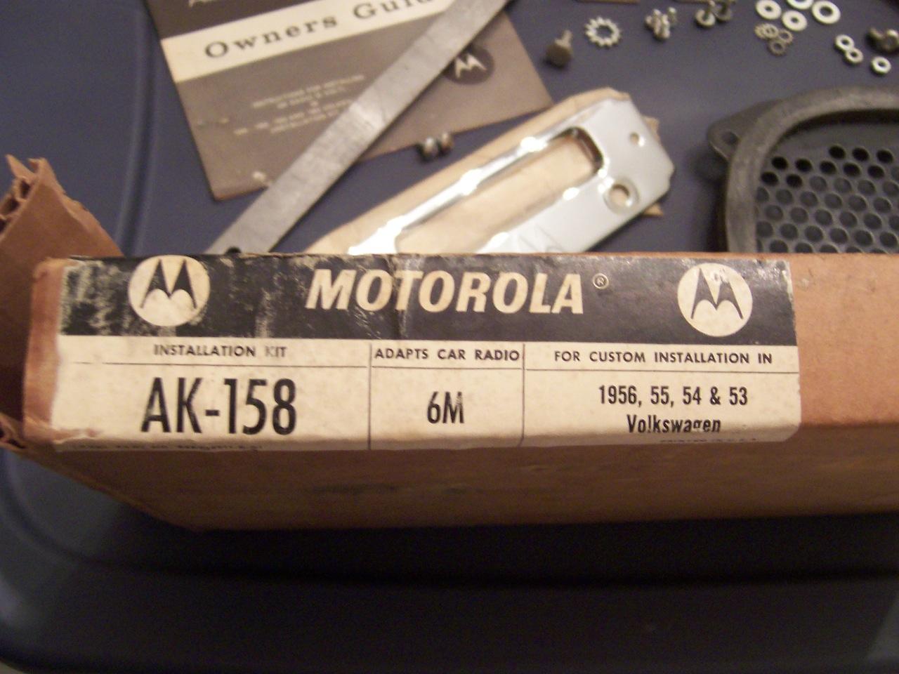

I came across this incredible topic looking up info on this cruddy old radio I found. Turns out it's a Motorola 8M! Very Happy I remembered I had this kit sitting out in a drawer in my toolbox for some time. I don't know if the pictures are useful at all as a reference as the work done here has been incredible. But it does answer the question about the speaker plate seal! It's indeed part of the kit.
As you can see it's for a 6M radio, but I don't see much difference between that and an 8M, do you think it'll work? Thank you Flyertim for this fantastic topic!

A spectacular post, Tim. One of the most detailed and informative ones I have ever seen concerning these older Motorola Volumatic vacuum tube radios intended for installation in the 1953 thru 1957 sedans.
One note with regard to the detailed drawing you had created of the rear mounting bracket for these radios. The finish from the factory was bright zinc plated. Anyone who wishes to fabricate one of these mounting brackets and make an exact duplicate to the original dimensions and finish will require this information.
You may wish to revise this drawing to include the information pertaining to the finish.
