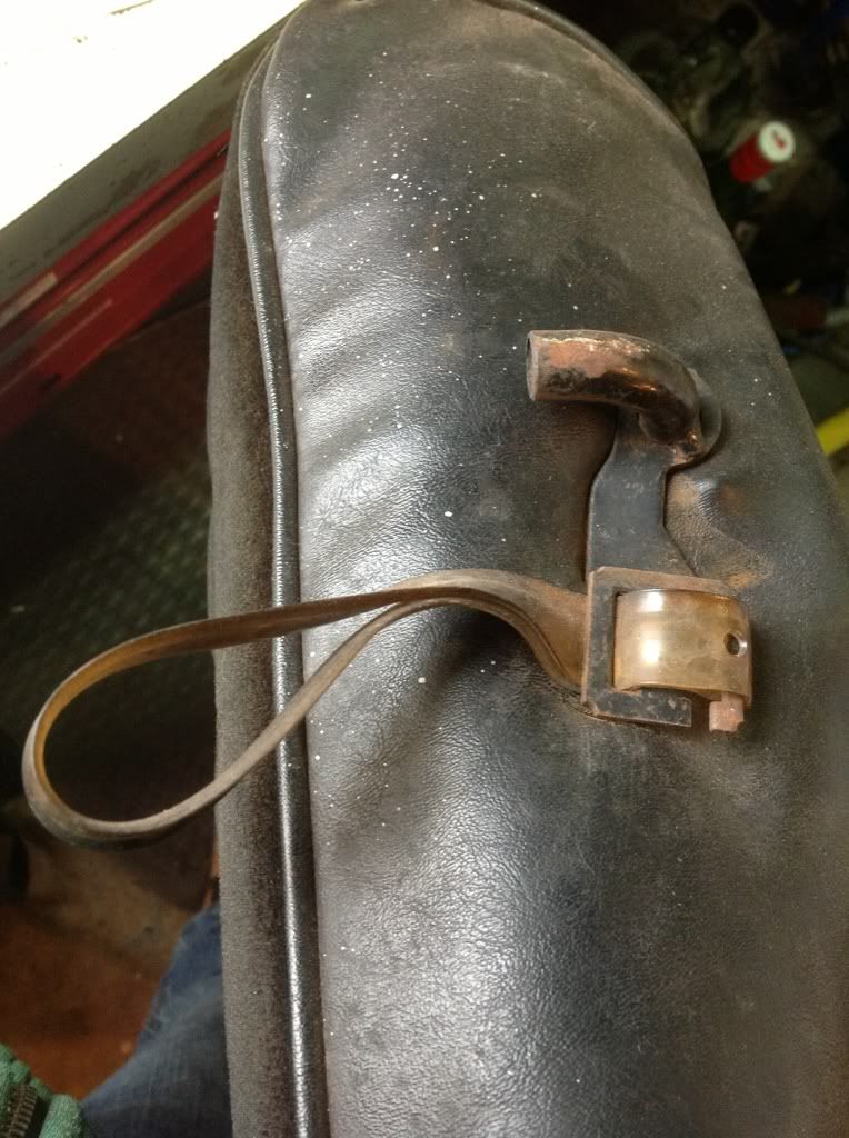

Really, there is no "latch", by that I man a physical locking system.
It's simply a friction system. The steel rod though the set back rotates tightly, the angled ends engage in the receptacles mounted on the body.
The strap you pull? That is simply a steel plate fastened to the rod giving you leverage to easily rotate the shaft thus giving you an "unlatching" motion.
Yanking the seat back forward really does no harm. The lack of a latch is probably why VW warns against storing heavy item behind the seat. Their forward motion in a panic stop will push the seat back down by their inertia.
Dave

PostPosted: Fri Jan 25, 2013 7:03 am    Post subject: Reply with quote
Hey Jerry, not trying to argue, just trying to present accurate information when I can.
Here is a photo of my 74 with the original strap still affixed. You can see where the lever is welded to the shaft.
No latch, nothing fancy, simple friction.

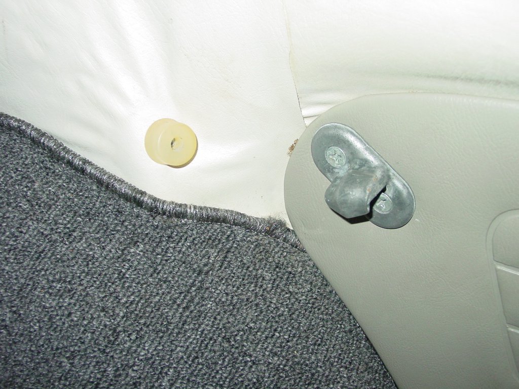

PostPosted: Sat Jan 26, 2013 3:37 pm    Post subject: Reply with quote
I will have to disagree with you guys. The back seat in my 73 super does lock in the upright position. (Just like the owners manual says)
When I pull on the strap it rotates the bar on the seat (see picture djkeev posted above) up out of the catch that is mounted below the window on each side.
If I just pulled hard on the seat I would break something.
Maybe you guys are missing the catches on each side.
You can see it in this picture from the gallery.
it is the chrome piece on the side panel just below the window.
(I borrowed the picture so ignore what is circled.)

SevenThreeSuper
Joined: December 31, 2012
Posts: 16
SevenThreeSuper is offline
PostPosted: Sat Jan 26, 2013 5:19 pm    Post subject: Reply with quote
I don't know about different years, but for the 73 super the catches do adjust up and down a little. The 72 standard may be the same and if so
yours may be too high.
I went out and measured mine and I have about 13" from the pivot to the bottom of the catch (the part that sticks out) when it is all the way up.
when I loosen it and move it down as far as I can, it is about 13-1/2".
The other thing is do you have them mounted correctly?
this picture shows correct.
This picture shows it mounted upside down.
(the catch shown goes on the other side of car.)

PostPosted: Sun Jan 27, 2013 2:14 am    Post subject: Reply with quote
Bugs have had that same locking mechanism since 68, probably 67 in some markets.
I suspect PO meddling may be the problem with some because they very securely lock into place and wont budge without breaking if everything is in order.
jyates-72, the catches on the door cards are adjustable, if you loosen the screws off the plate underneath slides around so you can raise or lower them.
if they are too high like yours the seat wont clear them, if they are too low they dont lock properly and are easily pulled forward without releasing like DJKeevs bug is obviously doing.
