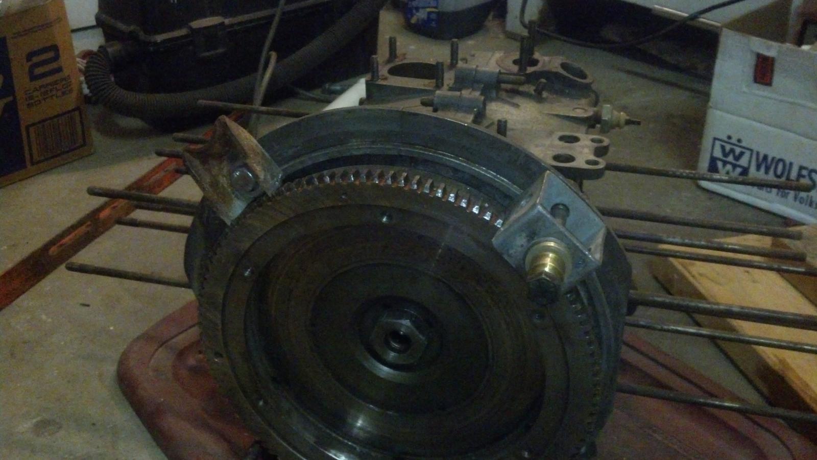

Any ideas for a guy working solo to stabalize the case while I take the flywheel nut off?

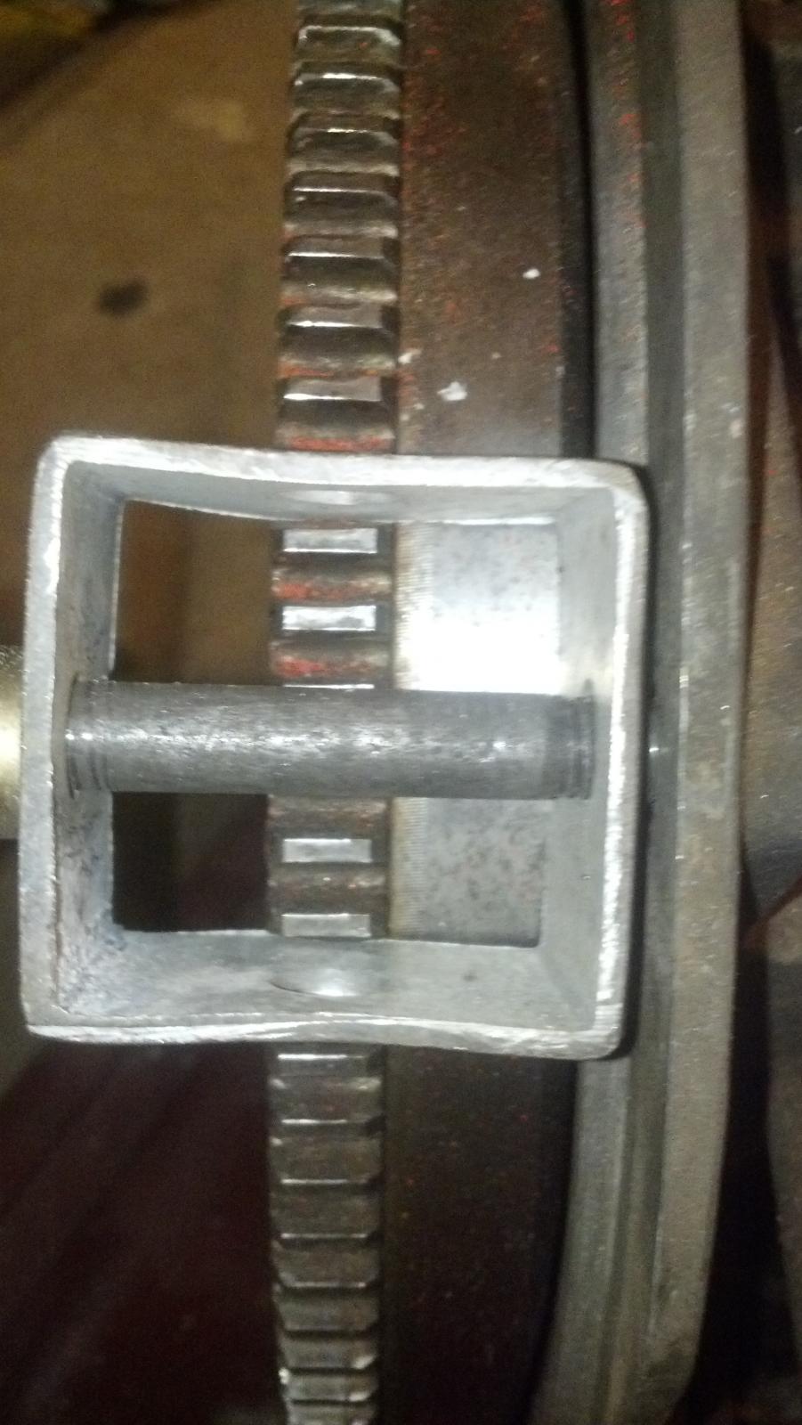

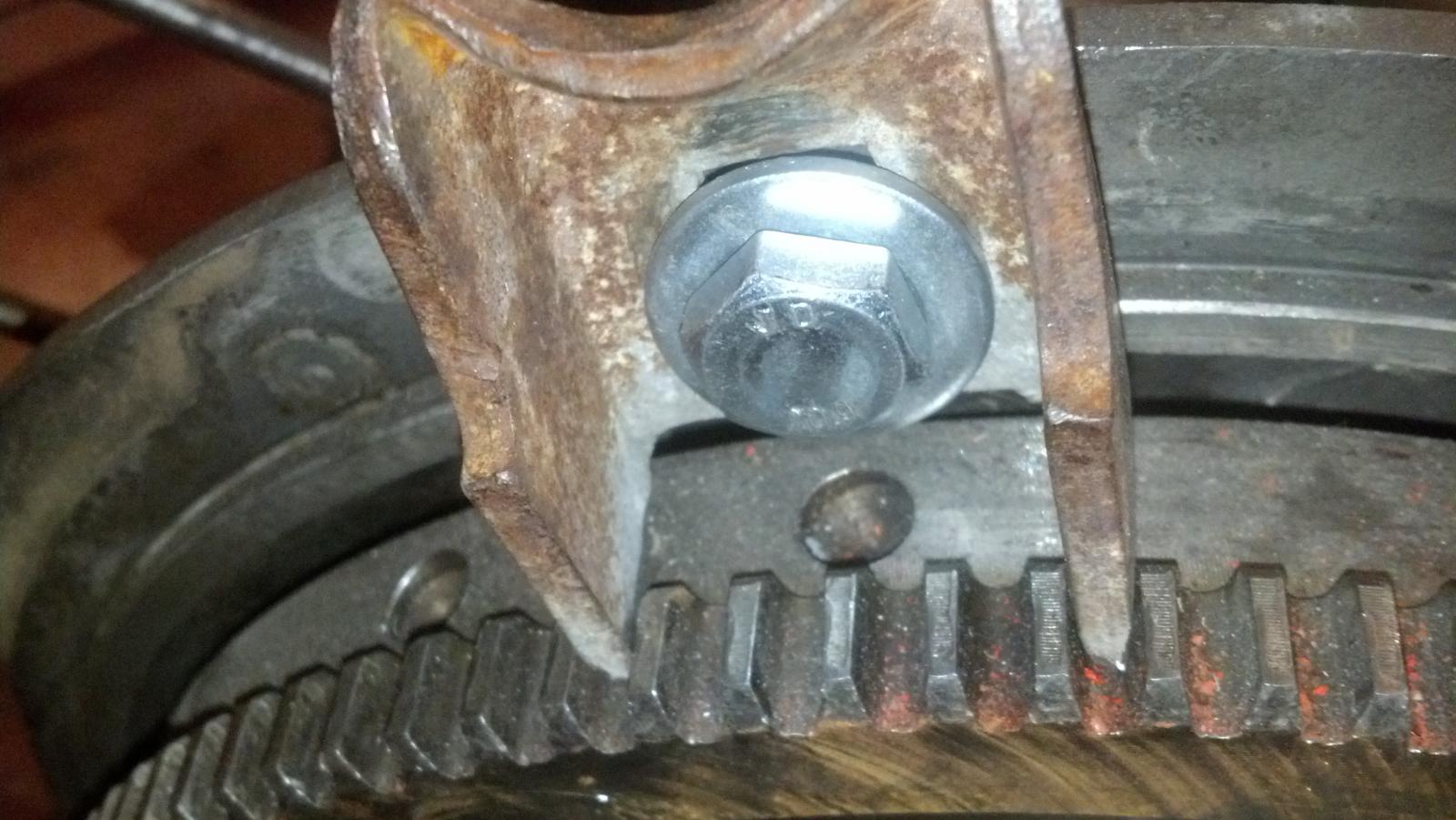

BTW, you guys are great! I made the clamps based on some of the pics I saw of what I guess is the actual tool, I think they will work but I will be careful not to destroy any thing. Going to be doing a 12volt conversion with my rebuild.

I have seen those clamps too, not sure what they are supposed to do.......
Another vote for "bolt a long thingy to it"
