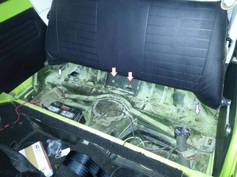

I am the proud owner of my dad's 1974 Super Beetle Convertible in Ravenna Green. I sent it to get restored and to make a long story short, I did not get all of the parts back.
The seat belts for the car were all wrong. I am fixing that problem now. I have a special problem with the rear seat belts - they were never re-installed. So I am not certain where all of the anchor points are.
Here is a photo:
The red-outlined arrows show the two anchor points I have found. The two blue-outlined arrows point to two bolts underneath the rear seat. I wonder if those are the two other anchor points. I am not certain. When I tried to loosen the first, it felt as if there was something significant on the other side of that bolt.
I would love advice on what to do. I want to put in rear seat belts. After that, I can try and get the exterior mirrors fixed.

The inners are correct. The outers are actually the seatback pivots. You can see one in this pic.

I suspected as much. I did not follow that suspicion too far. I loosened one side and tried to fit the belt end on; it will fit over the threaded section but not over the smooth, roller section.

The red outline arrows are for the belt clips. The belt itself is anchored at the hinge bolt for the seat back. The retract mechanism usually mounts to the side in front of the heat outlet.
