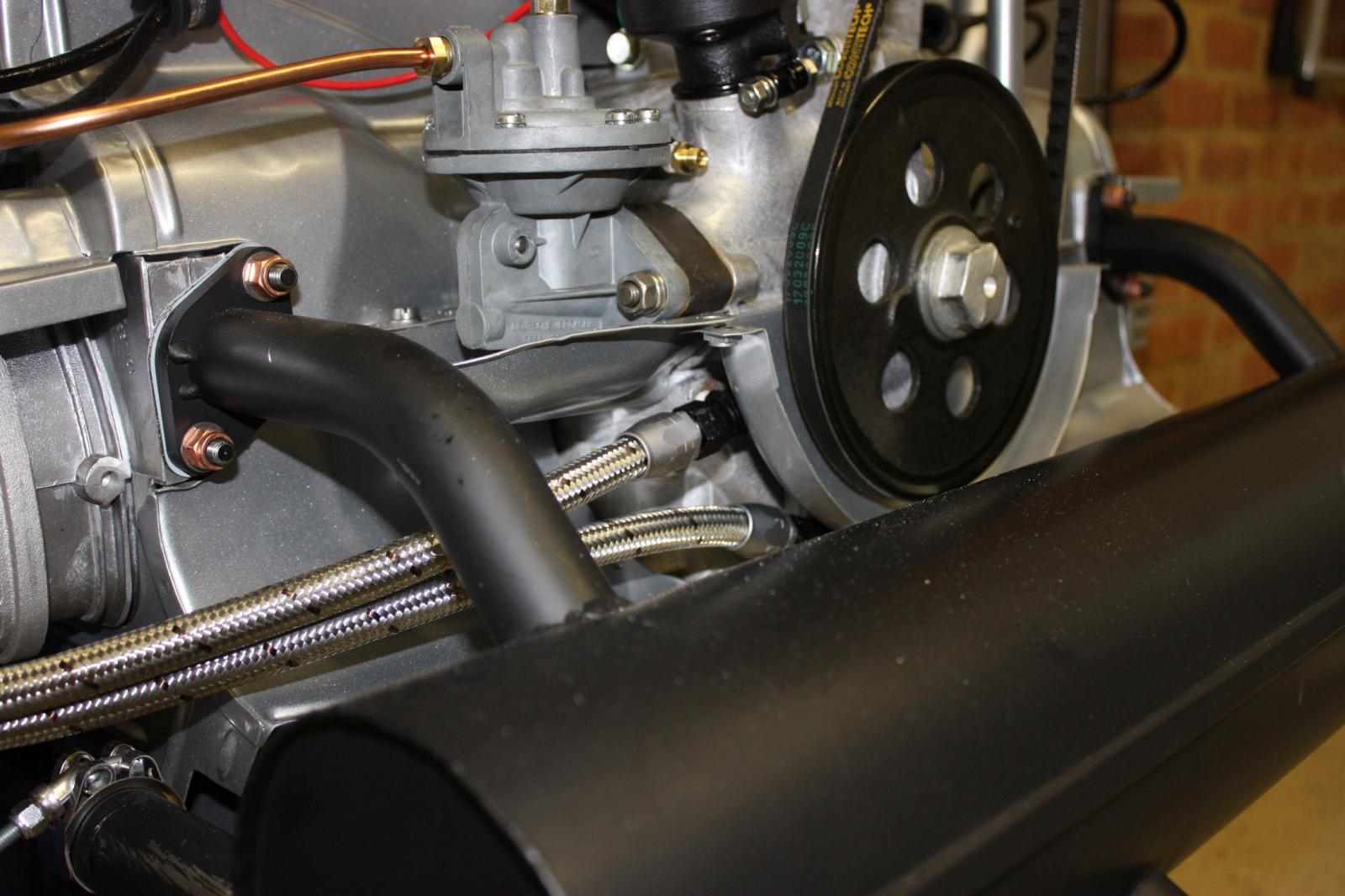

I have the tube powdercated and mocked it up and then I saw a picture of another build with black wires and loved the look without tube. Plus it is somewhat different and old school So at this point i am leaving tube off and hope others like the look as i do. Sometimes i do things and then later say to myself what were u thinking!!!!!!!!

Rwoodshvac wrote:
The other is the supply that leaves the Fram filter it is straight and long you have to decide where to cut the excess and how to make your bends for looks and alignment/fitment . It is a 6mm pure copper line very easy to cut and bend.
I can provide you with a matching short length of blue-striped steel-braided German hose to solder onto your cut-off copper Okrasa-style oil cooler return line. This is how I'm supplying the kits that I will be selling soon. It looks nice, correct and is easier to deal with than a long length of copper tubing to the distributor bolt oil return fitting. I can also supply the fittings, swivel nuts and cut-rings for the case and Fram filter fittings.

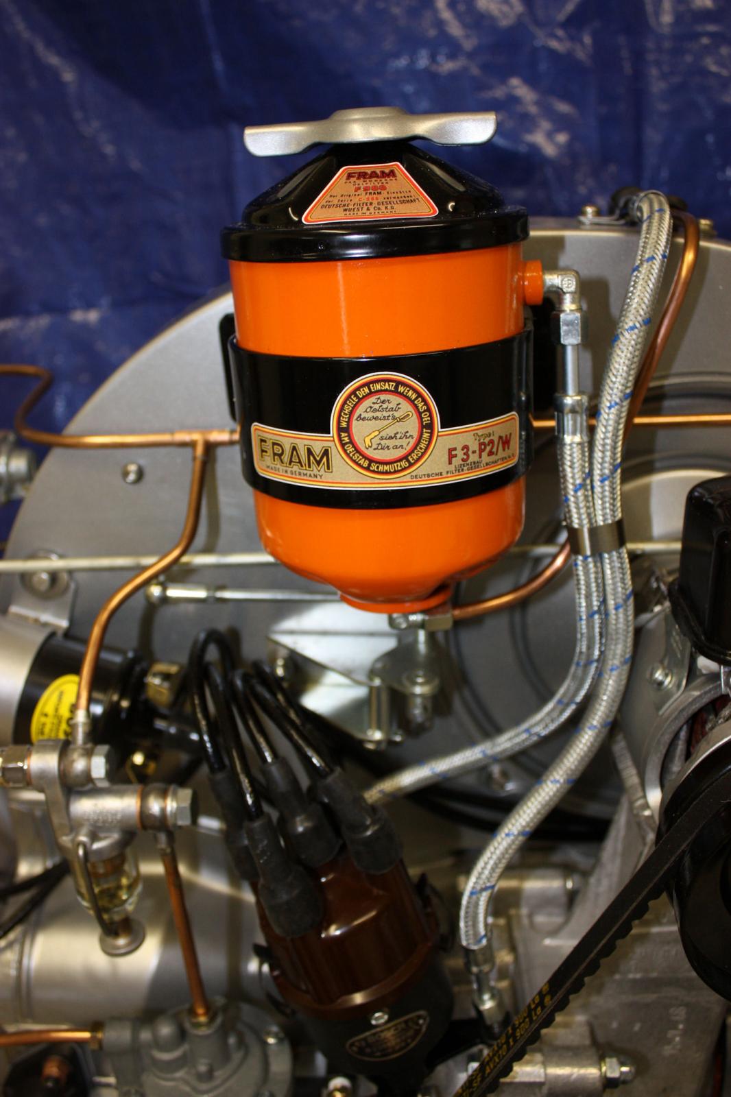

In the next few days i will post some Pics of the engine detail. Like i mentioned i ended up restoring a Fram Bypass Filter. Here is a picture of the finished product. This was powder coated. This filter is 100% functional even though i am using a full flow filter system.

I was thinking the same thing with the full flow and the bypass. Use the bypass filter for xtra oil instead of a sump.

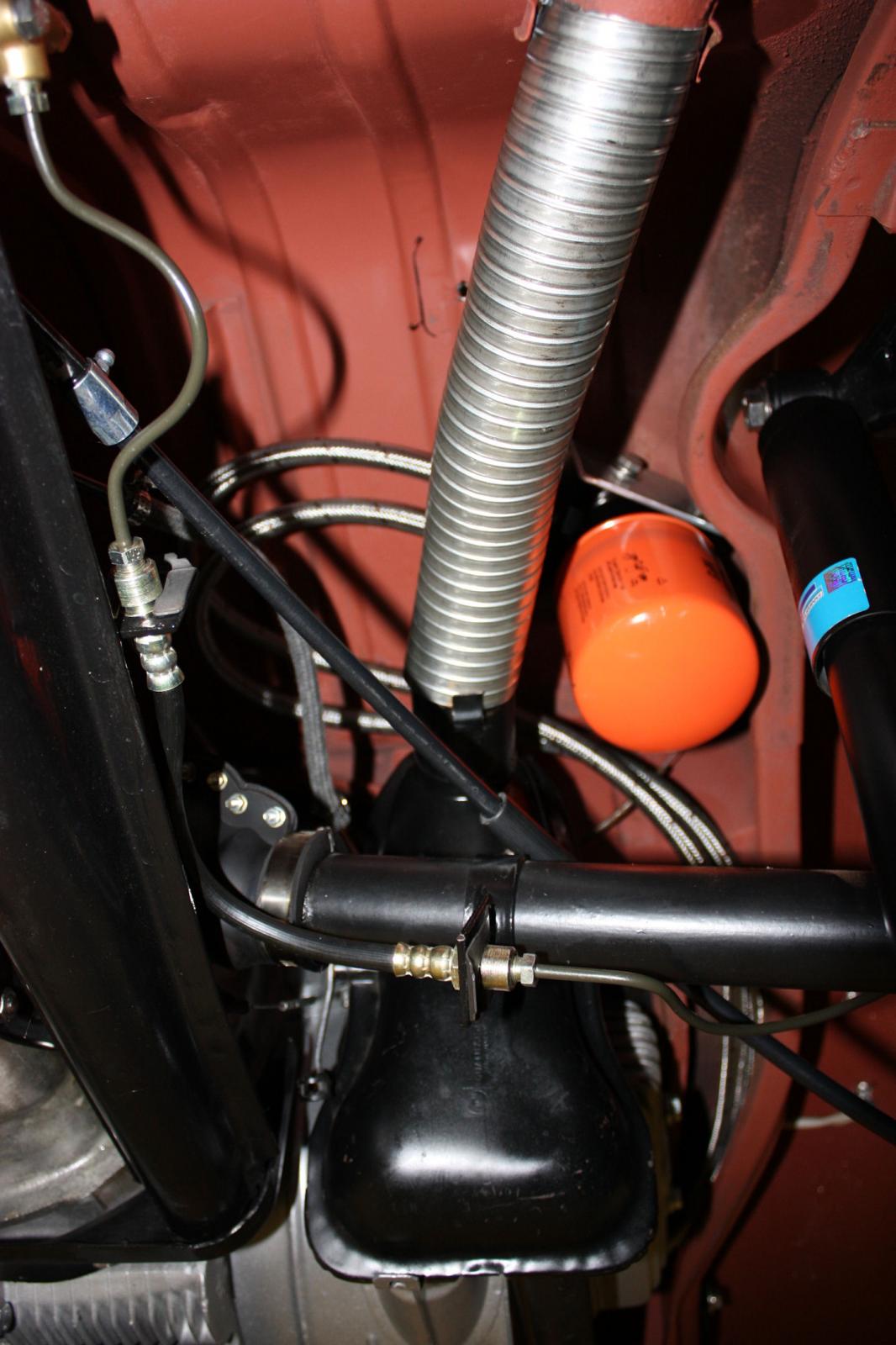

Here is a picture of the full flow Denzel oil filter cover from underneath. The Denzel cover puts oil lines in psoition to allow you to route the lines above the sheet metal sleds and below the header.

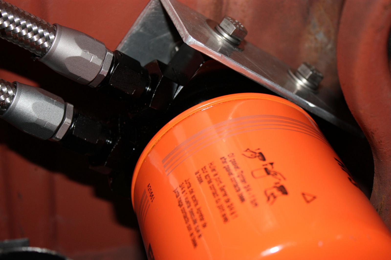

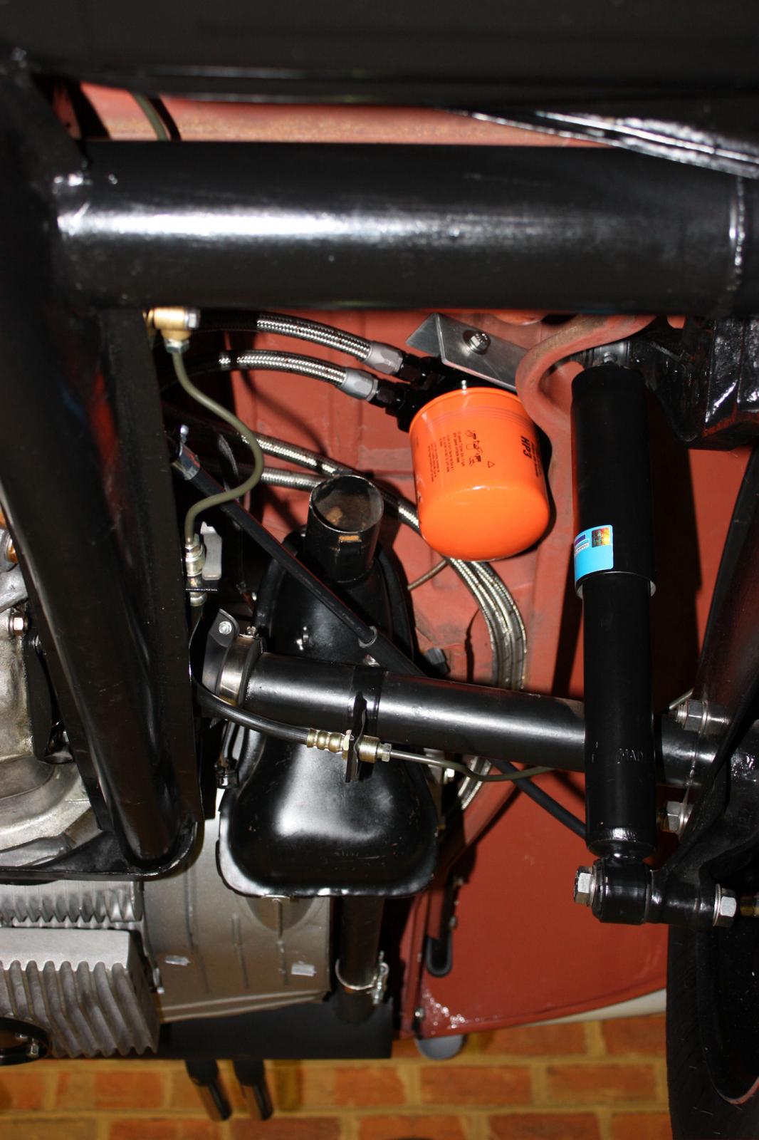

I spent some time trying to decide exactly where I wanted to locate the Full Flow filter. I wanted a location where I could hide the oil lines as much as possible. I wanted it in a place that was easy to access and easy to change the filter + I wanted it in a vertical position so when you do service it you will have less spillage.
I found a spot above and to the right side of the driver side heater box. I made a bracket out of aluminum to hold the JayCee filter adapter. It is bolted thru the bottom of the luggage shelf and holds the filter adapter very solid.
The heater hose fits right in with no modifications
