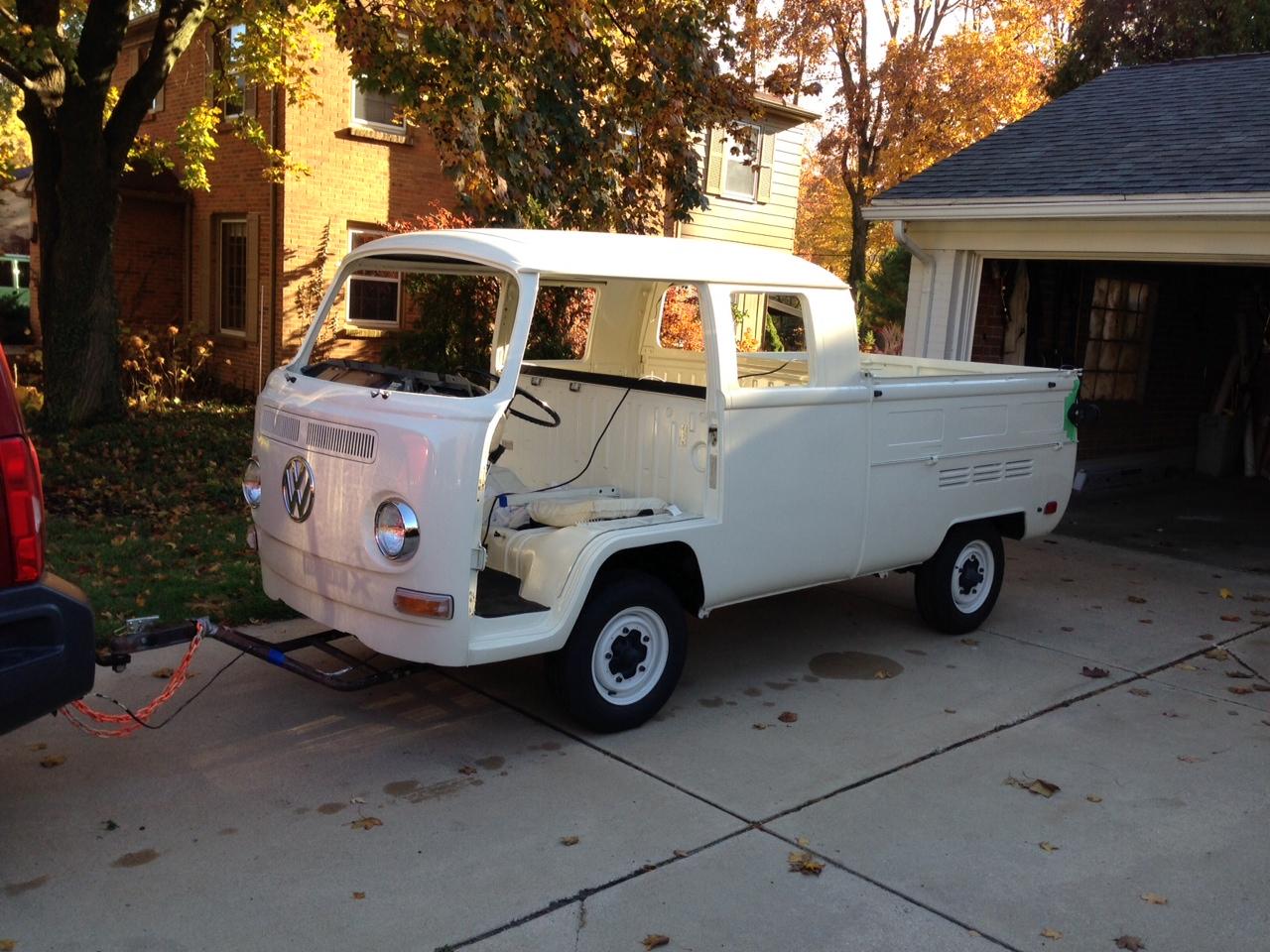

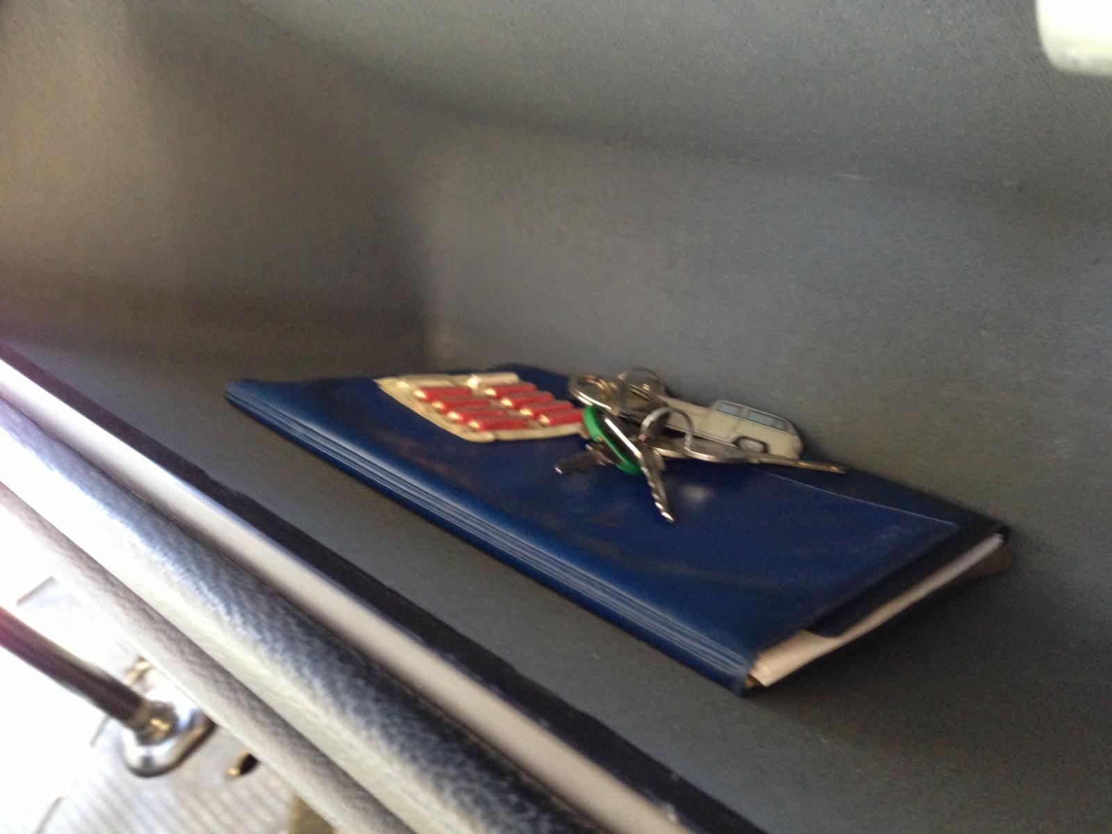

Headed to storage for the winter. Not as much progress as I had hoped but I got the dash and all the wiring done, which was a big job (for me, anyway).
Restored OG glove box
Reproduction label on Bosch voltage regulator

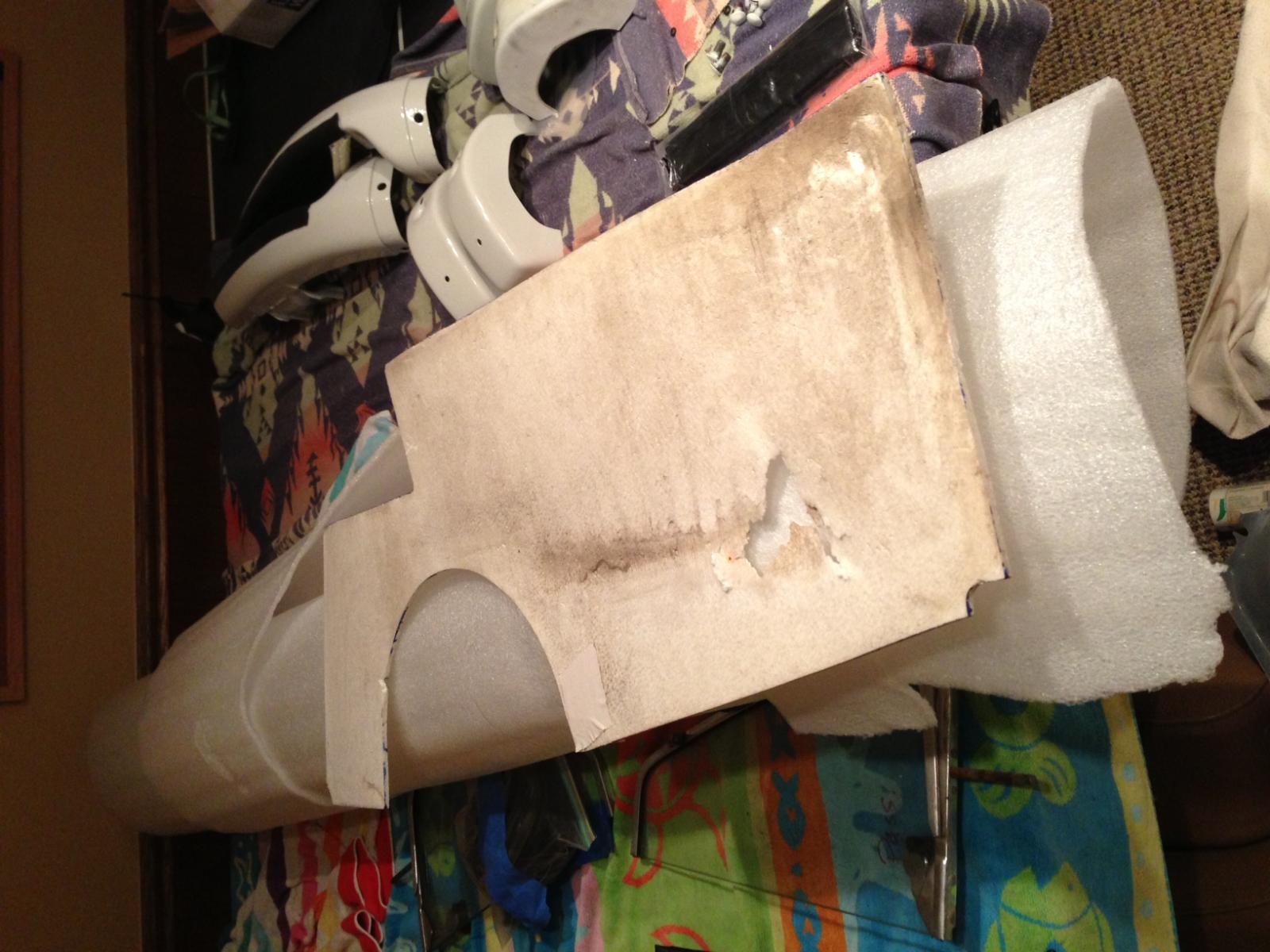

I made reproductions of the front nose insulation using flexible foam insulation and a salvaged OG piece as a template. Not exactly the same material but its white and the same thickness so it looks stock. Since it is flexible, it is easy to push in behind the wires and other obstructions.

Nice work, that new material is better than the original, did you know that polystyrene leaches the insulation out of the PVC cables so they should never come into contact with each other. That new material you have used shouldn't cause that problem. Very Happy

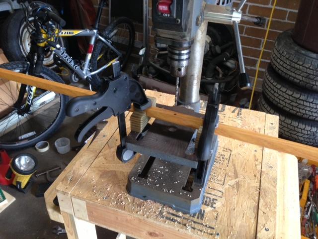

Who knew mounting the wood bed slats was going to be such a production? Had to borrow a drill press, make custom jigs to hold the slats flat, and buy a counterbore drill bit. Glad I did though – having the right tools makes for a better end product. While I was back there I also mounted a recent bling acquisition – a charter member VWCOA badge.

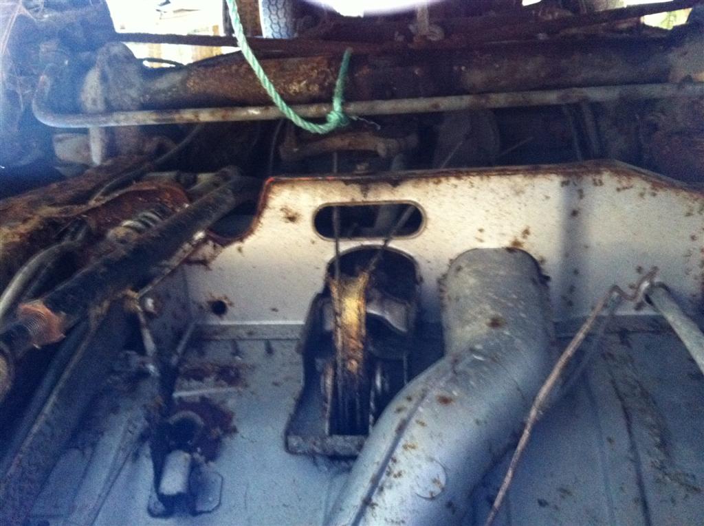

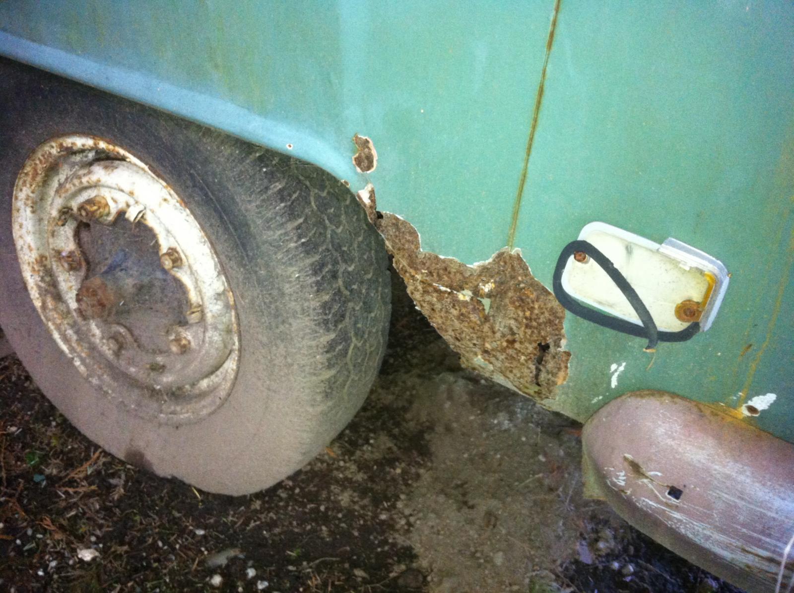

PostPosted: Tue Aug 13, 2013 7:24 pm    Post subject: Reply with quote

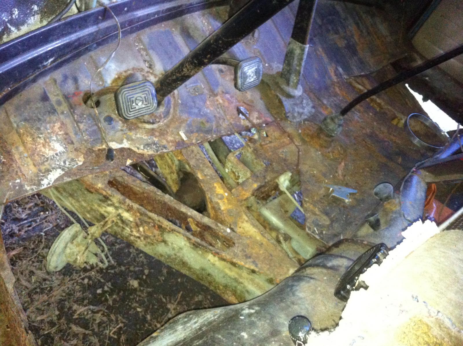

Bus looks great! It's nice to see it didn't get cut up, I've had a few people trying to get me to part out my crusty '70 DC as well. Sorry to photobomb your thread here but this is what a 1970 DC looks like when it becomes a REALLY tough call on whether to part out or save!
1967250s
Joined: May 02, 2007
Posts: 2137
1967250s is offline
PostPosted: Tue Aug 13, 2013 7:33 pm    Post subject: Reply with quote
Awww, that's just surface rust. Hey, you still have the center heating tube and inner rockers. That's a save.
