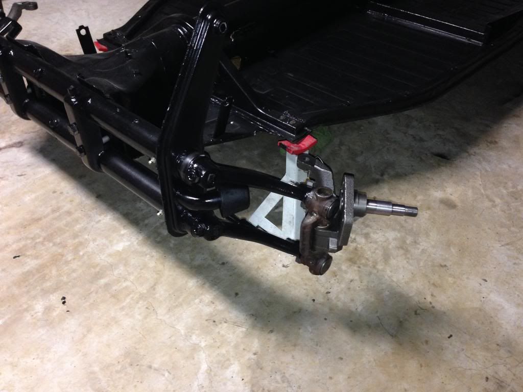

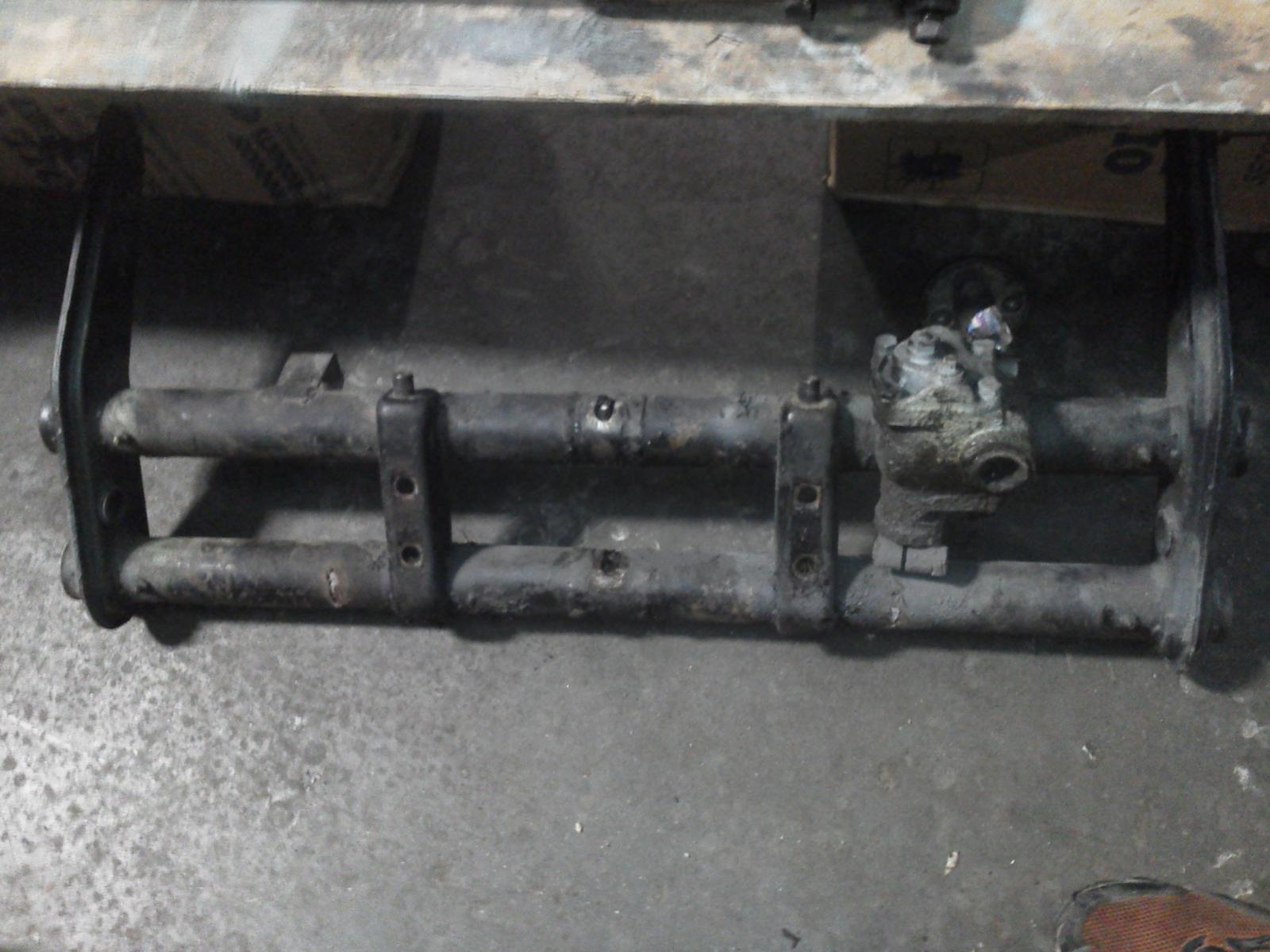

Spent a few more hours cleaning up the front beam, installed new grease zerks, primed and painted. I'm looking for someone now to press the new king pin bushings so I can install the drop axles and finish up the front axle with new brakes.

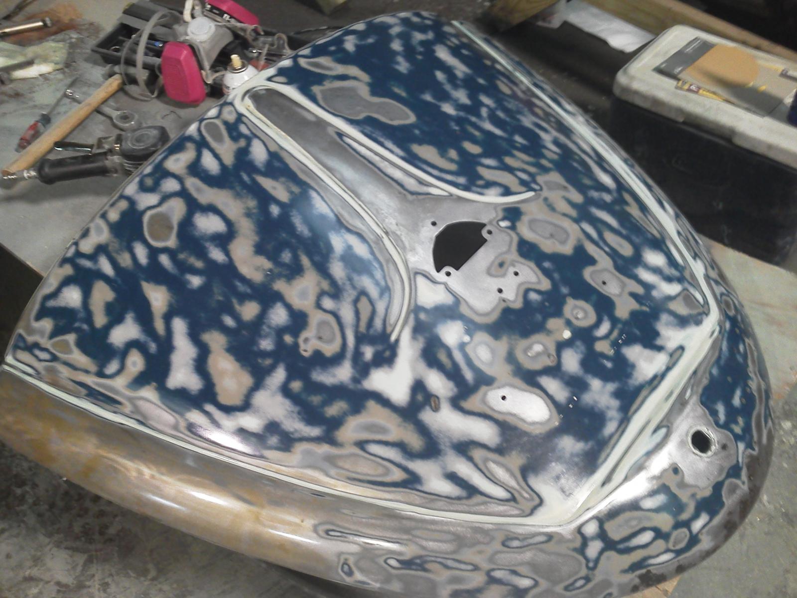

Oh and I HAD to throw in this beautiful deck lid pain. I'm tempted to clear this thing and rock it.

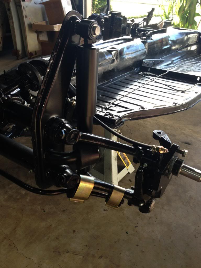

A little work done this weekend. All four torsion arms were media blasted, painted and reinstalled with new grease seals.
Interesting markings:
Installed:
Spent some time with the pedal assembly in the blasting cabinet, getting ready to paint and install new pedal covers:

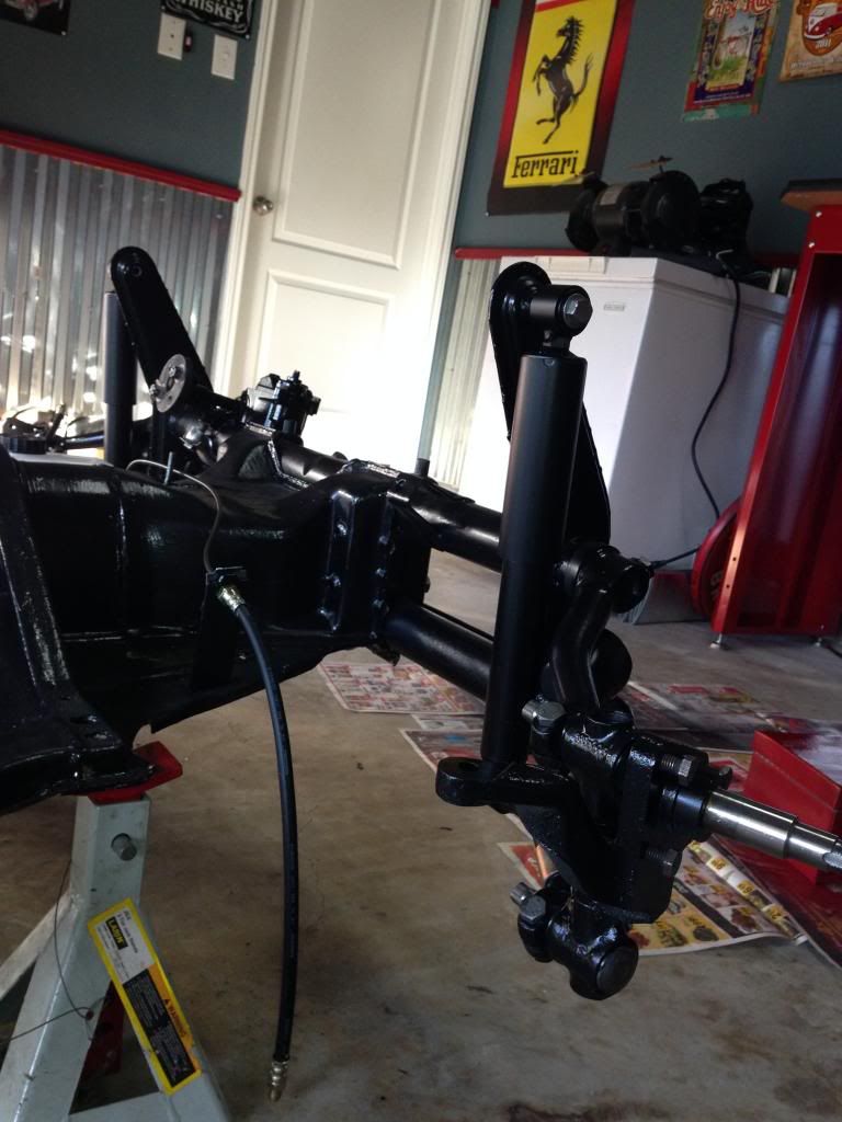

Not much done over the last few weeks, life has been getting in the way. I have the 2.5" drop spindles mounted with new king pin and link pin bushings:

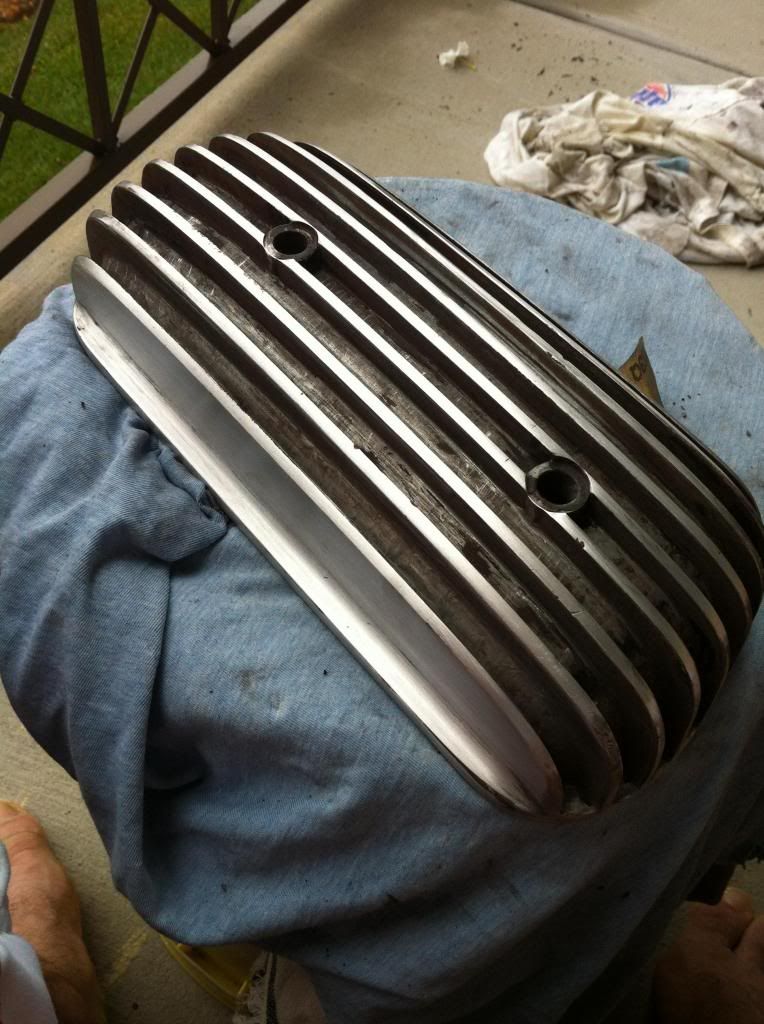

I found these sweet vintage valve covers at VW swap meet this weekend. The seller said who they were made by (I forgot now) but I think they are going to look sweet all black with the fins polished aluminum:

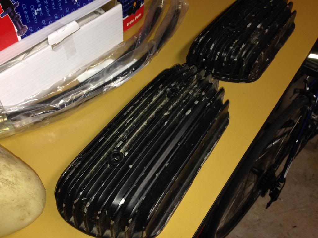

After some research, looks like they are EELCO valve covers, the part number stamped inside is 6070:
http://www.volksrods.com/forum/showthread.php?t=35843
Pretty cool.

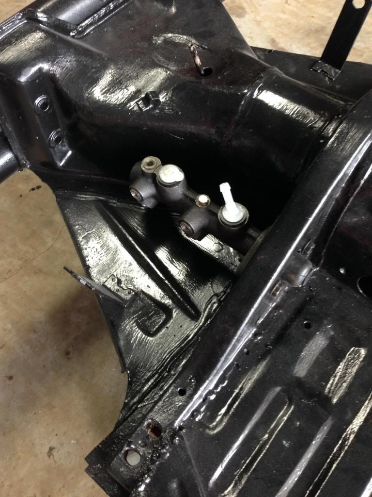

I got some work done today, not much - I ended up running into some problems. I did get the '67 style master cylinder mounted with new sleeves and bolts. I tried to mount the front backing plates, but 1 is missing the clips that hold the adjuster one, the 2nd is bent where the wheel cylinder bolts to. I would like to keep these, but I might have to look for a replacement.

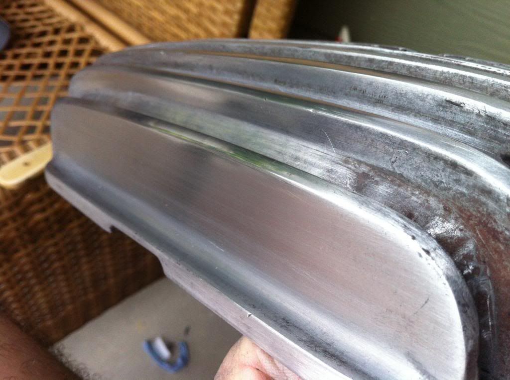

My friend is in charge of cleaning up the valve covers - so far he has done a good job at getting the paint off and start polishing them.

I tried to mount the WW shocks this morning - they won't fit over the lower sleeves on the torsion bars. Next up is getting the newly painted sway bar reinstalled with new hardware.

Some work done this weekend. Got the sway bar mounted again with new hardware, installed the shocks (turned out to be the old sleeves stuck on the studs - thanks Samba!) and some of the brake lines mounted. I have not finished the steering box yet - it is just mounted for initial reference.

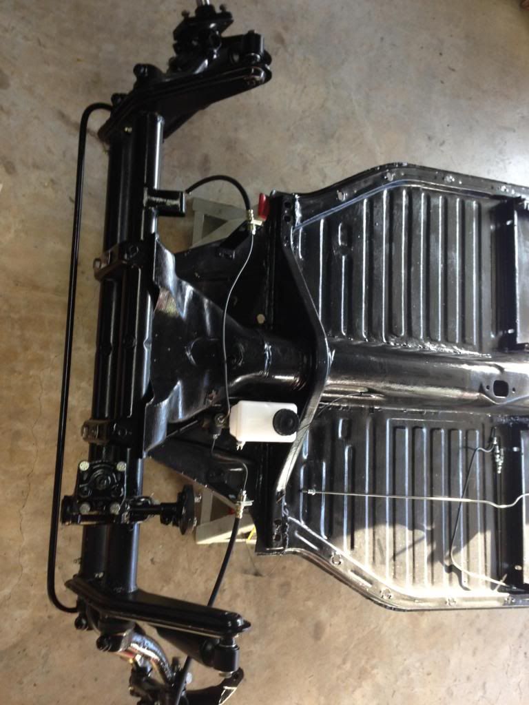

PostPosted: Wed Nov 13, 2013 3:23 pm    Post subject: Reply with quote
A little bit more done this week - hoping to get a good push done over the next few weeks. Here is how she sits as of today:
Dual reservoir mounted and steering box cleaned up, re-greased and mounted:
Next up... going to finish repair to the backing plates, install the front brakes, new tie rods, steering dampener. Afterwards, I'll need to save up for the front wheels and tires.

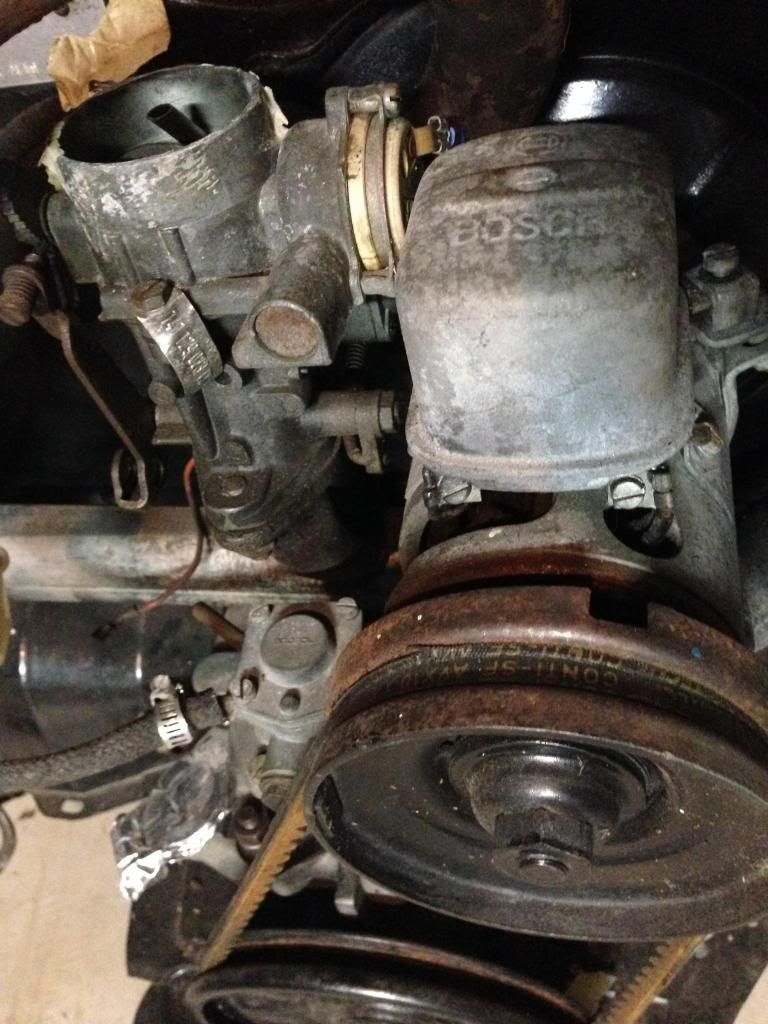

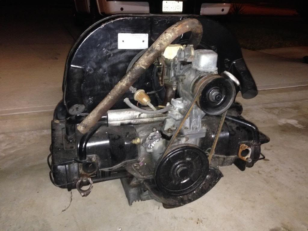

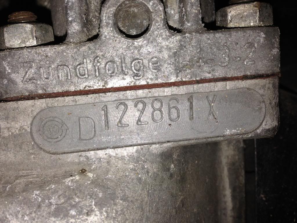

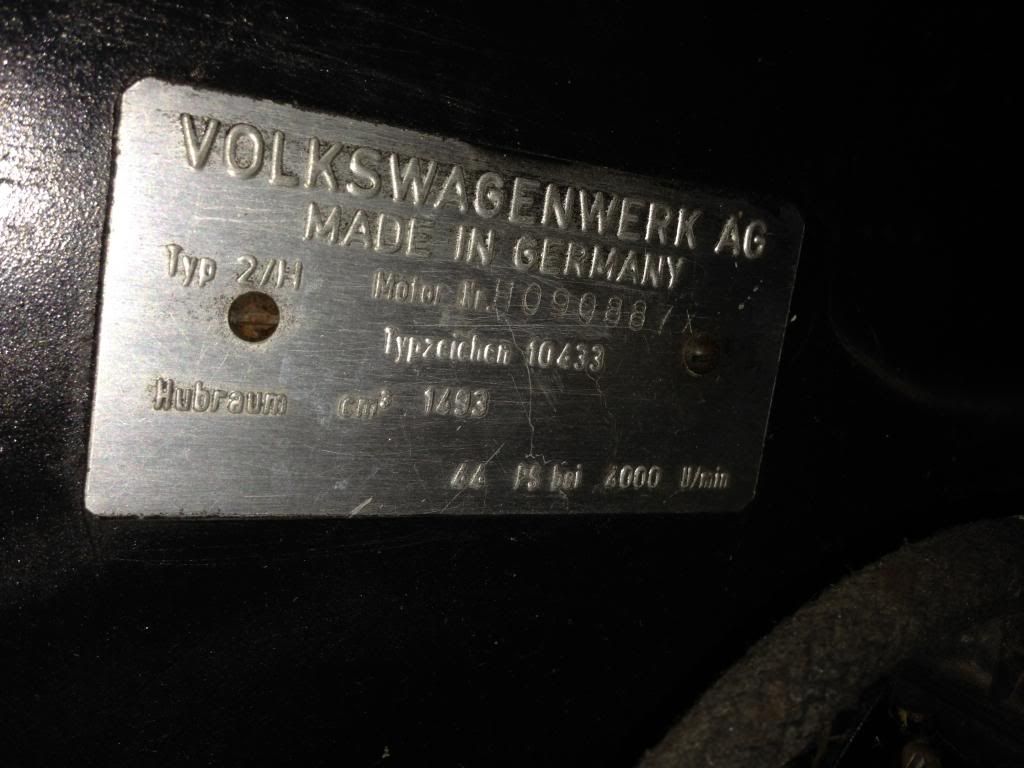

While scouring local CL ads, I came across this ad for a 1300 VW motor in Houston. The pictures looked super clean - and seller said it still had the original generator, relay, etc. still attached. Went and picked it up this evening - paid the huge sum of $80.00 for this really clean motor. Looking at the case, it's actually a 65/66 1200 40 HP - seems like the symbol at the beginning and X at the end means it was actually a VW warranty motor?
But the VW tag on the engine seems to indicate the motor is actually a 65/66 1500 from a Type 2? Something is goofy?
