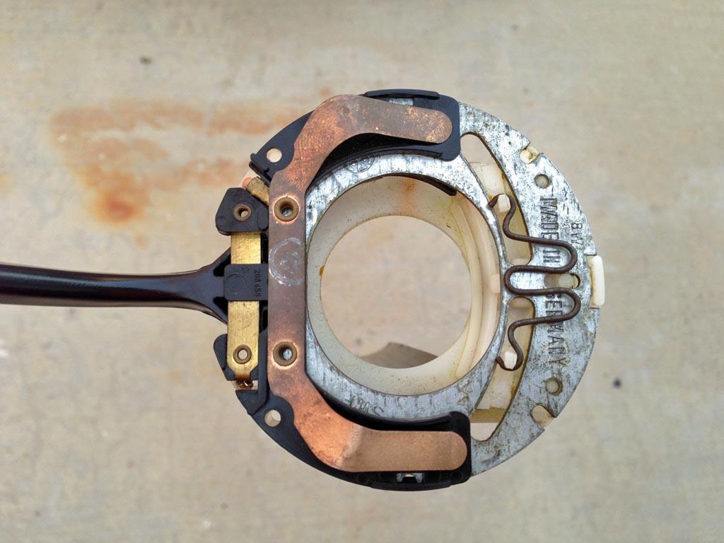

Whadayaknow, yesterday my '71's TS switch broke. It was in the usual place: one of the little tits the W-spring bears on broke off.
Fortunately, I had a NOS spare (and am now looking for another). I took some pics before installing it.

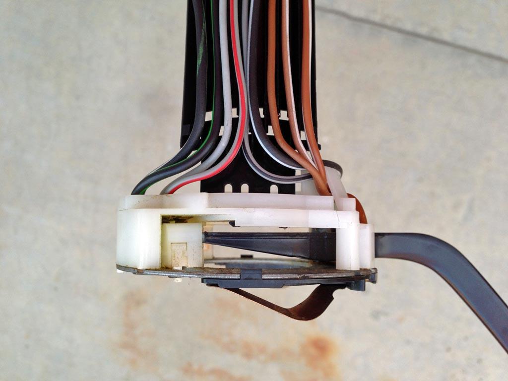

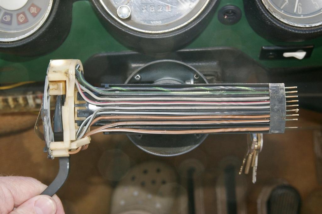

It is PN 311-953-513 according to the box. I was actually surprised to find the "extra" contacts for the Euro parking lights. I expected my USA model to be different. Either I have a Euro spare switch, or the USA models just either clipped the wires or left them disconnected. Anyone know for sure?
I will leave my side markers wired as turn signal/4-way flashers, though it is interesting to find I could wire them up as Euros if my ignition switch has the grey wire, which it does IIRC.
I lubed the sliding white plastic parts with silicone spray, and the contacts for the horn with Bosch grease. I'm not sure those are the right lubricants, but they seem to be doing their job of eliminating friction. Given the fragility of those plastic tits, I didn't want a petroleum product but wanted them lubed. And I'm not sure how insulate the Bosch grease is, but the horn works and the rotating is silent, indicating no friction. Any better suggestions?

I just replaced mine, and both my old one and the NOS replacement (311-953-513D), had all the extra wires. I'm assuming the replacement switches had all the extra wires, so the switch could be used with Euro or US cars.
I used Dow Corning DC7 silicone grease on mine -- it's like the dielectric grease you buy at a FLAPS, and it won't affect nylon. I greased the same places you did, no problems so far.

I think those little "tit" parts are all the same thru the years. Yes, they're left and right handed.
Bob 65 Notch S with Sunroof
