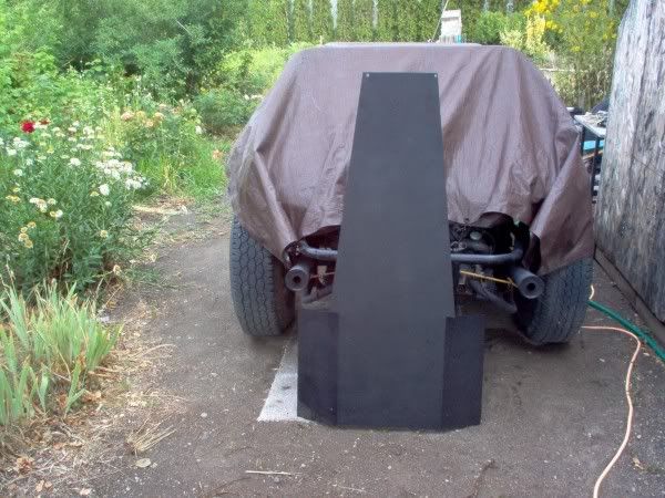

Secondly, having already dented a pushrod tube, I feel I need a skidplate. Again, I'm not sure what I should get. I saw this forum post explaining why I shouldn't have one that bolts to my engine case:
http://www.thesamba.com/vw/forum/viewtopic.php?p=7367038#7367038
but then I looked at the bottom of my engine and I really have no clue what I need, since there's a big tow bar mount in the way. Here is a convenient (and somewhat humorous) look at the bottom of my engine.
What should I get? I was advised to get this:
but I'm not sure it will work.
http://www.pacificcustoms.com/mm5/merchant.mvc?Scr...e=baja-bug

Now as to skidplates on the side most would consider the bottom. DEFINITELY DO NOT MOUNT A SKIDPLATE TO THE ENGINE!!! Even if that is what was intended by the skidplate designer 45 years ago.
The skidplate you link to is good.
They're available from many sources. Don't worry about snagging the drain holes. But don't think those drain holes actually will let you change your oil either. I've been serious offroading with a similar skidplate since that was a pretty new design and NEVER snagged one of the holes.
You can turn those L-brackets around so the vertical part is outboard to mount to the existing tow hitch. You could also install a regular Baja rear bumper.
Then the vertical legs of the brackets should fit right to the outside of the lower tubes of the bumper and you can drill a horizontal hole through the bumper for a mounting bolt. It's worked for me for decades. just watch that the oil filter dos not hit the bumper cage.

Do you have any idea how thick these EMPI skidplates are? I know I should be going for something 1/8 or 3/16ths thick, but for the life of me I can't find any specs on these skidplates for sale all over the place.
For specificity, I'm discussing a skidplate like this:
http://www.jbugs.com/product/3194.html

Here is my skidplate. It is 10 gauge steel. I made a cardboard replica of what I wanted and took it to a shop. Covers everything very well.
My wife said I never listen to her.
Or something like that!

Nice plate. Nothing to catch, just glide over the rocks or roots Very Happy .
